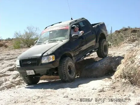

Also, can you help me find some pictures of STs with 35"s, 17"s, TT, Shackles, and a BL? I only found 4 so far.
Here's John with that setup.
Here's TxPlates with only a body lift. No TT, no shackles.
More of mine to come soon.
Edit: Sorry, just realized you wanted 17" wheels in those pictures also. Those are 15" wheels. Where did you find STs with 35s on 17s?
