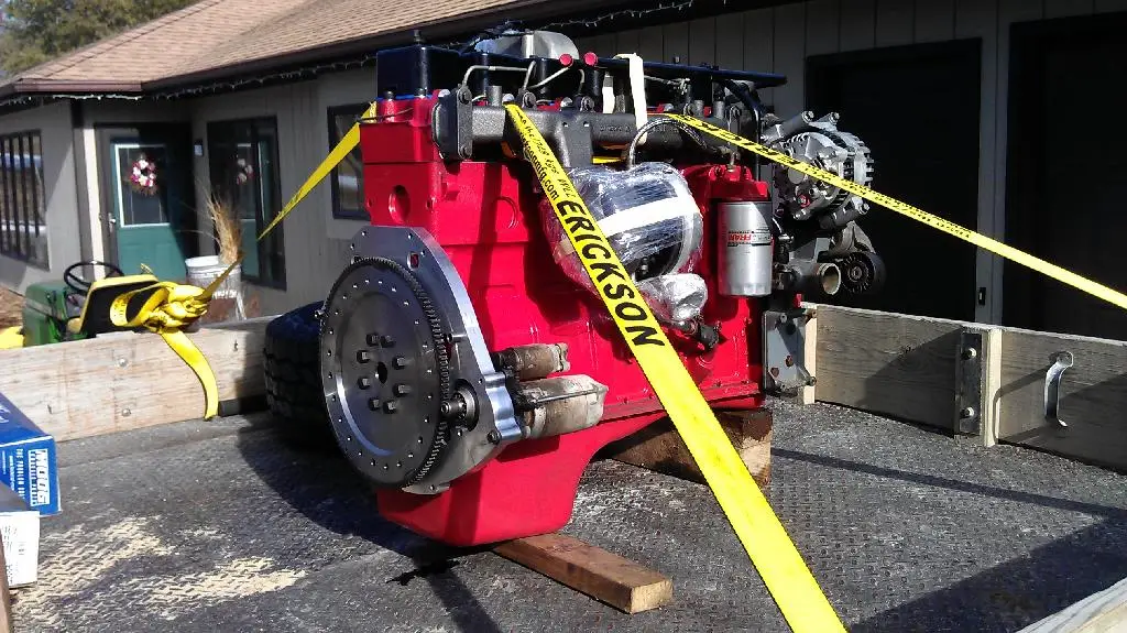

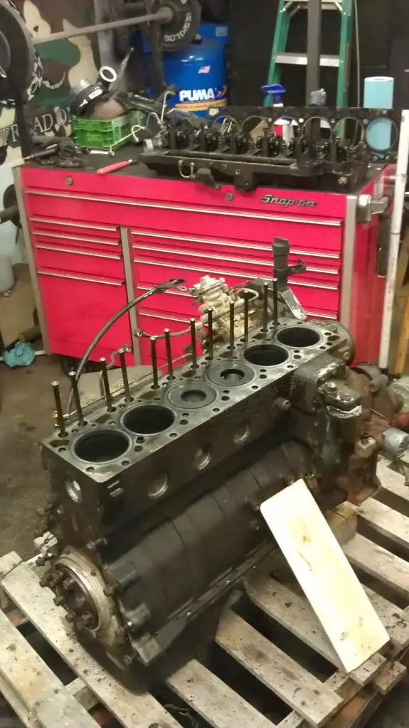

Donor Motor Getting checked over/upgraded

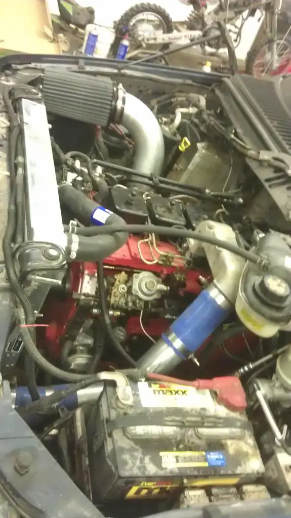

Ready to install

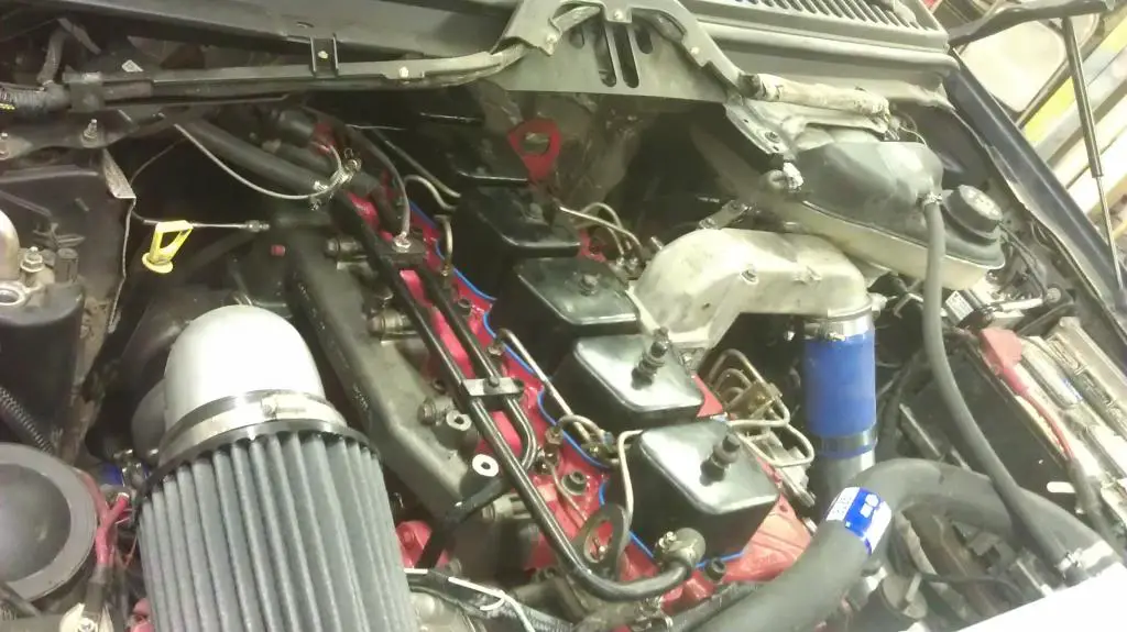

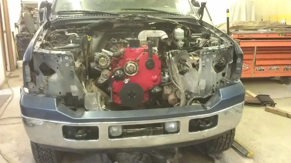

5.9 in the truck
Ready to fire
