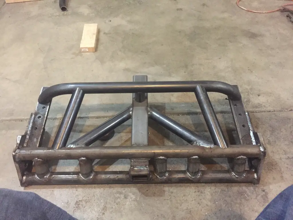

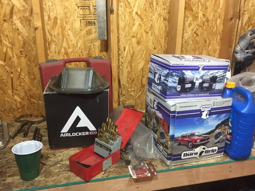

I just finished the main parts of each bumper and I made big purchase

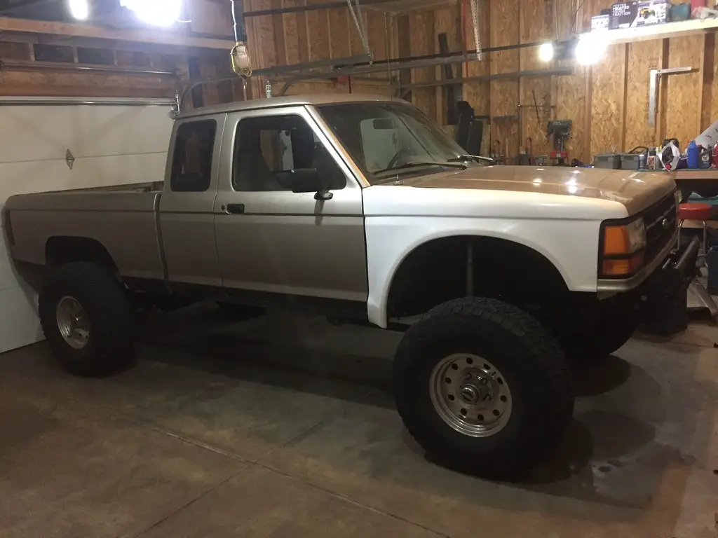

I also got a set of BFG All Terrains on it. They were new, but they are about wore out now

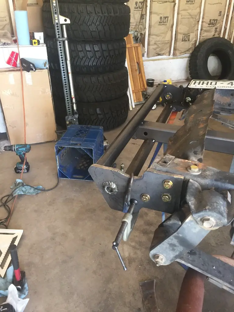

Start of the front bumper
Hauling a 20'+ piece of DOM tube

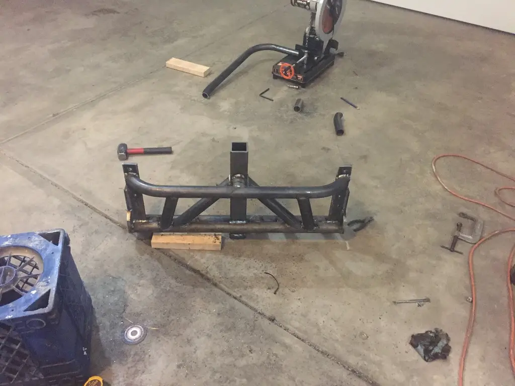

Starting on the rear bumper
closer on the rear bumper
I don't want to rip this one off like the last one
And the big purchase
I got some cool stuff

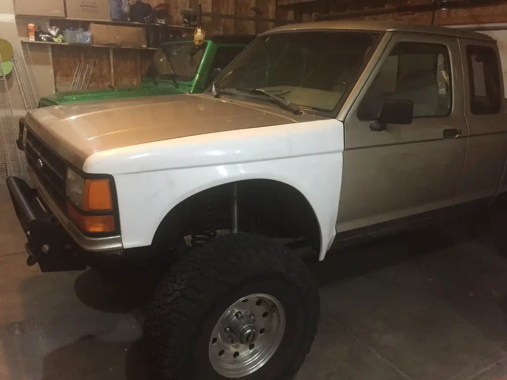

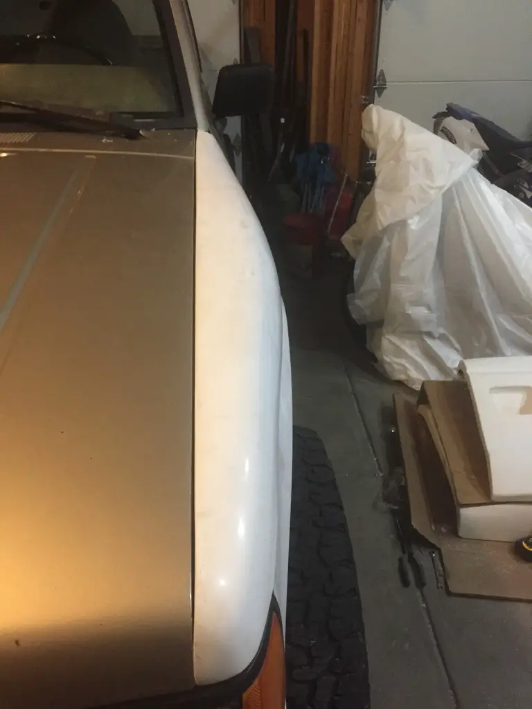

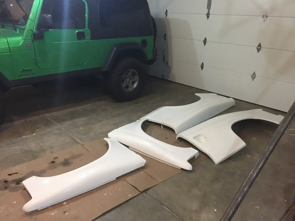

Did some work on the fenders
They don’t fit awesome and the finish isn’t great. One even has a little crack in it. I hope the body shop can fix them. I am hoping to work on the other side tomorrow or Wednesday. I also had to change the starter. I changed it with a motor craft starter and I also found nos mororcraft positive and negative cable on eBay and installed them.
fiberglass never fits perfectly, what you did on the fender looks pretty good! I use lots of fender shims/washers to adjust the gaps.
Who's glass is that?
Very nice truck! Thanks for sharing
Thanks amigo. I need to get some washers and bring them up a little. I had to gut the stock fenders for ball of its brackets. It’s McNeil. Ended up being the best value (I got bedsides too) and they actually filled my order. Hannemann took my order but then never filled. I am not complaining because I read some horror stories with Hannemann.

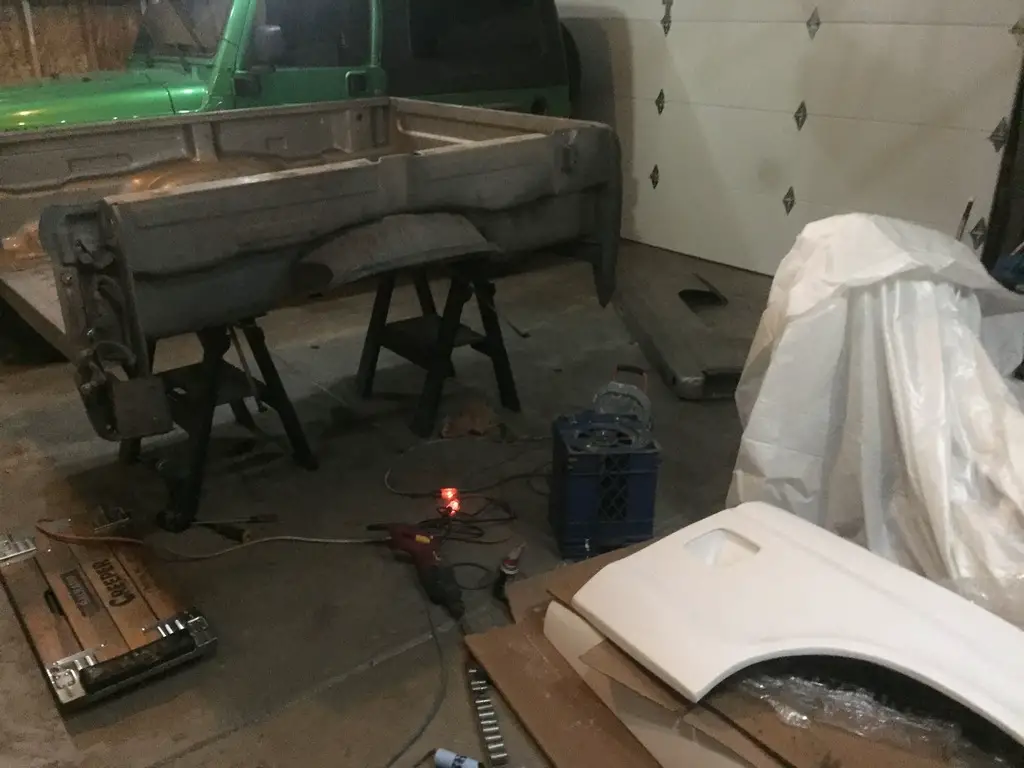

I got the other front fender on yesterday.
I started on the rear tonight:
I am going to be running around without a bed for a few days. I am trying to decide how to mount the bedsides. I plan to have the bed rhino lined after paint. Anyone had any thoughts? Maybe big rivets? Maybe grade 8 bolts with washers?

For the bedsides, I want to attach them permanently with fasteners. I know sometimes bedsides require a frame under them and are attached to the frame with dzus fasteners or something, but I use my bed a ton and will be attaching back where the spot welds attached the old sides. I realized some of the attachment points are blind in the back- so I am leaning toward large 1/2” head 1/4” shank rivets. I am currently trying to decide between stainless, aluminum or steel rivets.
For the attachment points I was looking at the e track at big r today and found some cast tie down loops that I really like so I bought them. I also found some 1/4” plates as well. I’ll shoot some pics this afternoon and share. I am having a hard time knowledge my whether to weld the plates to the bed sides or sandwich with two plates or bolt them down before the rhino!lining. I don’t want the welds to stress them and cause them to crack out.
And @410Fortune the bed is in really good shape. When I got the truck it had a fiberglass topper on it and it looked like they had never hauled anything in the bed. I meant to get it rhino lined immediately, but with the expense I never got it done. So I have definitely abused it since I got it and the fender wells and others have some dents and dings it didn’t originally have.
