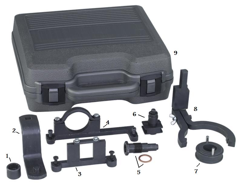

$600 labor to replace the rear cassette and the front primary tensioner is just plain dirt cheap. Make sure the shop has the timing tool kit (OTC 6488) to time the camshafts.

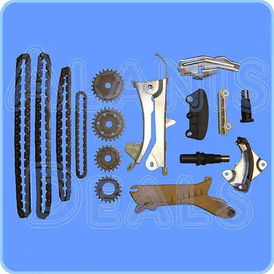

timing chain kit vs timing tool kit
Timing chain kit:
Timing tool kit:
Individual cassettes, tensioners, etc. are still available from Ford but they cost more: SOHC V6 Timing Chain Related PNs
Some of the aftermarket timing chain kits are just junk: SOHC V6 Timing Chain Parts Sources

Thanks for chiming in, your links have great info. I'm sure the shop has the right tools since they work on these engines all the time. I just meant that the shop owner was trying to get me just the rear chain to see if he can make it cheaper (I think), but in the end, i figured I might as well change everything. The engine is coming out anyway... He's not charging additional labor for anything related to disassemble/reassembly since its all coming out anyway. That's why I chose to swap the radiator as well, otherwise it would cost probably another $100 or so in labor to swap that thing.
