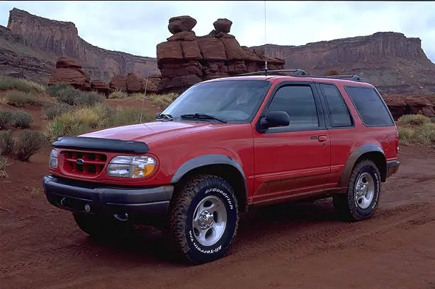

I did exactly what Robert did; I put the BFG 265/75-R16's on my sport and had to trim the same spot. I've had no rubbing, even off road and I know that I had the springs at full compression as evidenced by the clean marks that the rubber stops left on the control arms. Unfortunately, I don't have a close-up picture of my trim job, but it is the same as Robert's.
Here's a shot of the truck at moab:
Note that I removed the step bars for added clearance.
Also note that this photo was taken before the new OME rear springs. Picture about 2" more clearance above the rear tires. :)
[Edited by Tom Wilk on 06-28-2000 at 08:04 AM]

Is this photo of a stock suspension explorer with 265/75/R16's? I have an 02 explorer sport with 16" wheels, and I'm going to look at a set of BFG MT 265/75R16's and I need to know if they fit. In the last 2 pages, many people have said they do, but other's have said that they have no idea how you fit them. I've looked at the tire sizes that should fit my truck in the sticky(31x10.5r15), but it does not include 16" wheels. These tires are like 31.9" and like 10.5" wide. Is this safe to run on 7" wide 16" wheels? Any information would be appreciated.

The 265/75R16's do fit with trimming on a STOCK SUSPENSION Explorer...At least for what the thread says... the 1997... and I assume this is correct for the following years: 1995 thru 2001...I am NOT sure about 2002 and newer.... I have a 97, and they did fit when I had them....

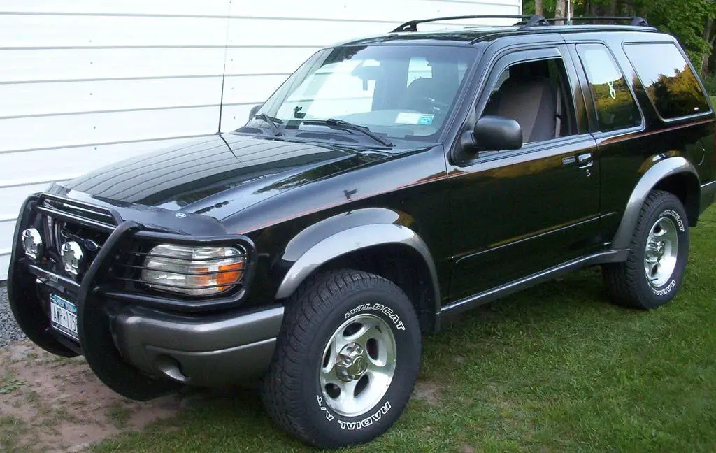

I put 265/75/16 on my Explorer Sport w/ only doing a shackle lift, they rubbed a little in the front but i eventually lifted it in the front a little by turning the torsion bars...

Where did you get that grille guard? It looks sick and I want one like that for my Explorer. Thanks.
Its a Westin and the cheapest Westin dealer I could find was Advanced Auto but since the dealership that I work for has an account through them I got it slightly discounted. I got it a while ago but from what I remember it cost me around $600.

Cool, man. Thanks for the info. I just looked them up online and they have them for like $420-$472+shipping. Not a bad price. But they say '01-'03. Did yours say it worked for a or a '95-'00? And for the lights, did you just drill and bolt them on? Thanks.
The Westin or the Manik brands are already pre-drilled with mounting for 2 lights. The holes are just covered with a couple of protective plastic plugs so you have the option of not putting in lights.
like techboj said the holes are pre drilled and mine did say for 95-00
