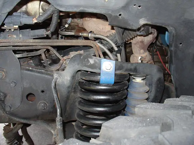

Well, the noise from the back turned out to be my muffler banging the frame just enough. it had slipped over a bit on the rubber mounting doo-hickeys.
I made my J-clips up, just using some flat bar metal that I procured. I put the bar in a vise with a socket that was as thick as my coil spring, then bent the metal with a hammer till it curved over the socket, careful not to have too much curve so I could get it in the coild ofr mounting. This is the best way, you don`t want to heat the metal up to bend it lest you weaken it.
Then I put it in place and drilled a hole through the clip and the upper coil seat. after that I trimmed the excess off, painted them, and bolted them on.

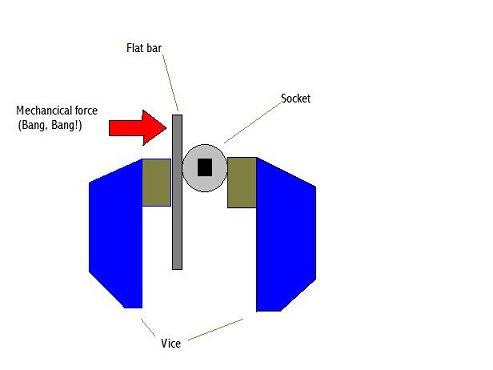

By socket as big as the coil, I meant the same diameter as a section of coil.
Here it is in illustrated, diagramatic detail. (In full color)
