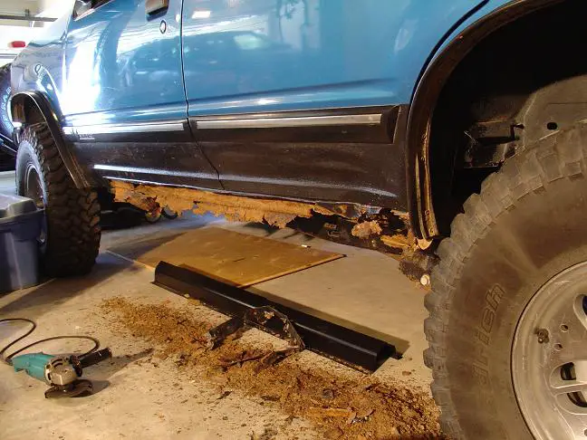

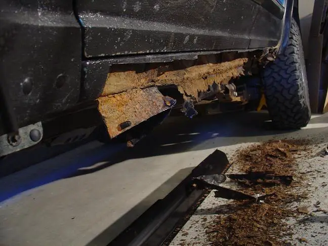

The station wagon is off the road for a while, uninsured whilst I repair the rust and consider putting my full width axles on.
My rockers have been rusting from inside for quite a while.. :(
(no my tire is not bent, it`s the angle)

wow that is some serious rust
Thanks Brian, those are some solid rockers that guy has. I`m repairing mine, I have one side done, but I got a lot of other things on the go. Wanted to have mostly just mods in this thread, but I might write up my rocker repair later.
You can see my progress here:
full size axle thread
