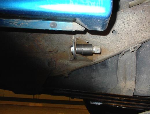

I took apart the cable at the bracket, drilled the hole larger, and assembled my pieces like so:
This made the holder for the rear pass. side line 2 & 3/4 " farther back. Now I needed the cable before that to be that much longer.
I chucked the piece that holds the front part of the cable and the rear part of the cable together, and made my own connector that was 2 & 3/4" longer.

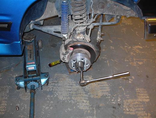

Well I got them, put them on, and here is some pics for you:
I had a slight rub on road at the tupperware on the passenger side so I cut a wee bit off of it, just the corner. I have been up to 130 kms/hr with them and feel no vibration or anything. It does feel a lot more stable now. I have passed on the flares I mentioned because they don`t really stick out too far, and it kinda looks cool.

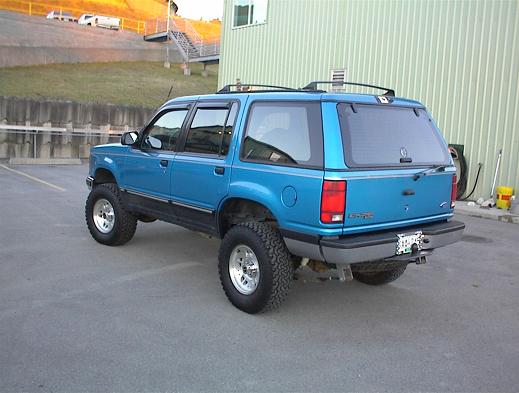

Looking down the side

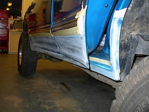

I got rid of the tupperware, which was a good idea after all, because there was some rust forming under there. Anyway, I got this stuff called "Hippo-liner" which is the same as rhino, herc, etc. I cleaned up the rockers and bent the pinch weld in so that I could eventually have the sliders as far up as possible. I got some plastic push things to cover the holes, then I Hippo-lined up to my door trim.
Here`s some pics.
Prepwork:
It looks pretty good, and I managed to keep the liner off my body parts.
You may notice that I took the bra off. It sucked, flapping in the wind and catching all the dirt and mud from the trail. Not good for off-roading.
