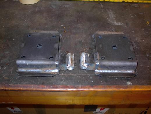

Okay, true to their word Warrior made me up a new set of plates. I told them not to bother with the powdercoating because they just did not seem to care about raising the mount point for me even when I practically begged them to. So I figured I would be doing some alterations to them anyway, so I would paint them myself. I am happy they came through. That is good costomer service, and I value that. They were only out to correct the problem with my sway bar after all. ( he he, well we know nothing is gunna hit it now anyway)
Here they are
You know I spent alot of time figuring what I would do here, and I hope I don`t let anyone down when I tell you that I didn`t mount the shocks to the plates after all. As a matter of fact my new plates are still sitting in the box they came in.

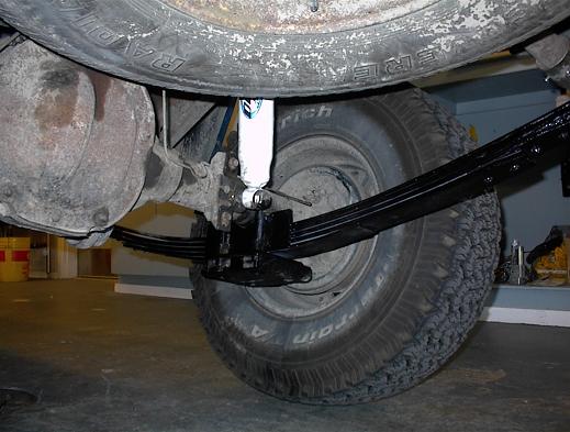

Then I used the brackets that had secured my sway bar to my axle as a mount point by drilling holes in them till it looked something like this:

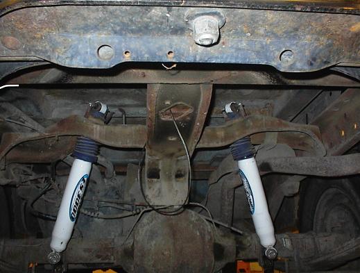

Alright, THEN I had to get the top of the shock higher right? Or it would bottom out for sure. If you recall, I previously had modded the upper mounts to bring them lower.
So I just used the same idea and same hardware to mount it above the crossmember like so:
This mount method is probably only possible since I have the body lift in, and still is very close to bottoming the shocks. The piping is about 2 inches long and it`s no use going longer because the shock can`t fit through the hole anyway

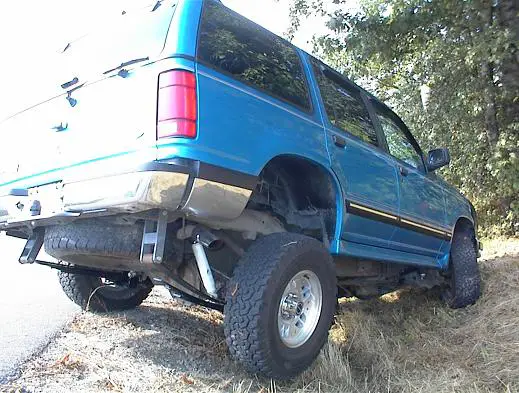

I grabbed a forklift since I was at work and lifted one front side tire nice and high and used the floor jack to try to get a rear tire to stuff up the the point where they rub. I didn`t quite get there, and by my calculations was SOO close to bottoming.
I took a hammer to those brackets redneck style until I got them bent downwards till the mounts were lowered a little over 1/2 and inch while still being able to undo the mounts. I bolted a bolt through the holes with some strong, thick washers to maintan a flat mounting surface while I did the hammering, then played with it till the angle was right.
After that, it looks as if I have enough room to still stuff the tires as much as they can without worry. This is VERY cool, because now I have much more room to play with my droop later on (mua ha ha!)

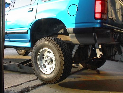

Well I did the Zimmerman the other day. In what seems to be an LD50 tradition, I did it alone, and got lots of pics for y`all. I did it a little differently too, so check it out.
First of all, I snapped a pic of my droop before starting:

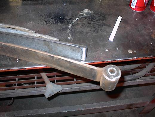

I pried apart the binder that holds the leafs together towards the front, and determined where I would cut. To get a good cut line for all four cuts I used a ruler I had handy, and rested it against the loop and marked my cut.

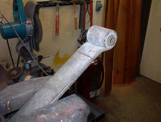

I cut it with a cutting wheel on a hand grinder, and cleaned it up with a grinding wheel. I needed to make sure I would have a smooth edge for the leaf to slide on.

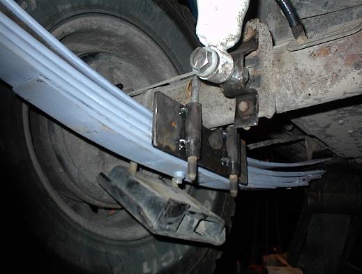

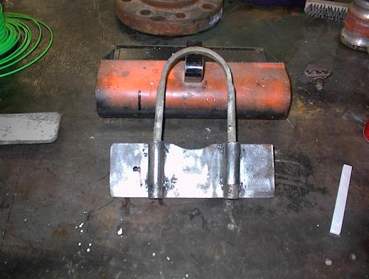

I dug some 1/4 inch steel plate from the scrap bin that was 3" wide, and cut it so it was approx. 4 inches wider than the space between my u-bolts. I cut some 6" long pipe nipples that the u-bolts would fit through, in half, and then used the u-bolts as a guide on where to weld the nipples to the plate.
Eventually I had this:
I used the grinder to shape a circular curve for the axle shaft until it would fit in place while allowing everything else to be bolted up tight.
Checking fit
When I had `er figured out, I bolted it up. The plate is very snug against the springs, and they won`t be moving sideways now.
I gave it all a blast of black rust paint to nicen it up, and it looks pretty:

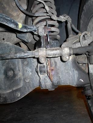

Swaybar disconnect
I decided to try just doing up one side that I could take apart while leaving one side hooked up.
I took the nuts off the "bone" that secures the bar to the TTB and sprayed some red marking paint on the threads that were showing. I used that to tell me where to drill some holes in the bolts.
Aftere the holes were drilled I used a couple of those keeper pins I had kicking around to hold it there. Any way:
Here`s what I did
