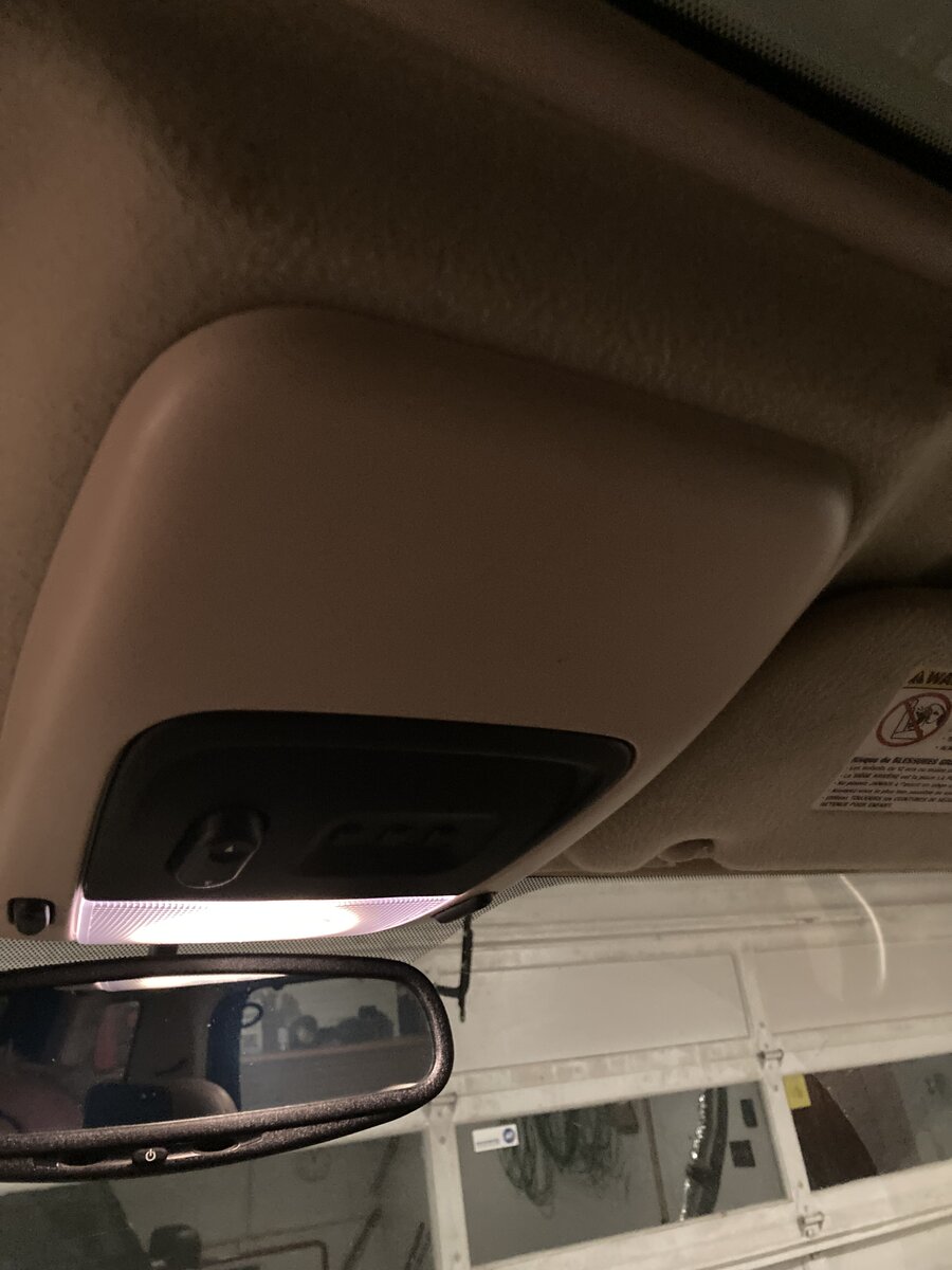

Simply detach the plastic piece in the photo and unplug the connector.
Okay. I know the piece you're referring to now, but mine's configured a lil differently. My sunroof button is set smack-dab in the middle of the thing, w/two controls for rear heating/cooling vents. And mine's obviously an '05 fully loaded Explorer. I see yaou upgraded a little back in '04 w/the Mercury Mountaineer. What would happen if I didn't, decouple that, I mean??? curious. I'll post a pic of mine after I join the elite after I get paid on the 1st. But I thank ya greatly for the response. Very much so!👍😉 Also, I'll probably need to ask one (two, tops) more questions of ya... If ya don't mind, of course.
^ of course, you're welcome, not a problem...if you're going to go my route and silicone to stop the leak, you want to disconnect the power source as you don't want to accidently raise the sunroof, break the seal, and have your originally leaking problem...you most def will press the open button at least a couple of times accidentally...old habits take a while to break
