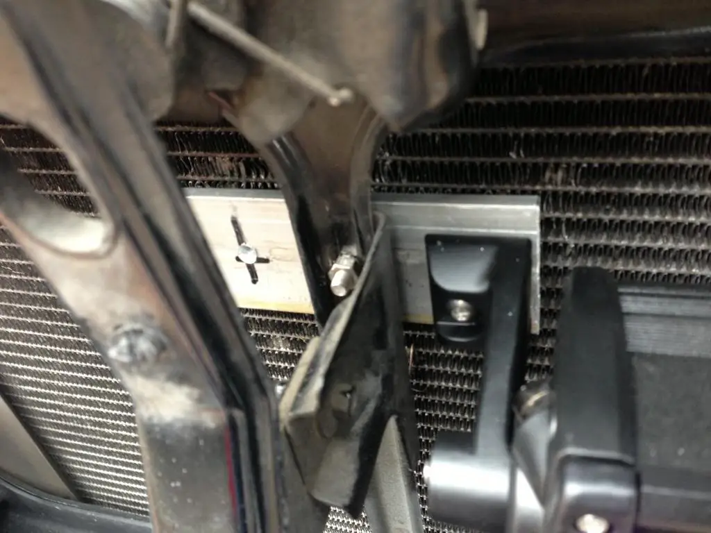

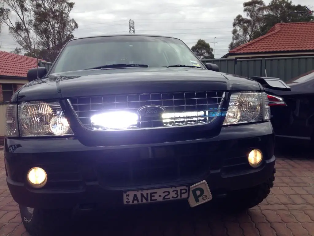

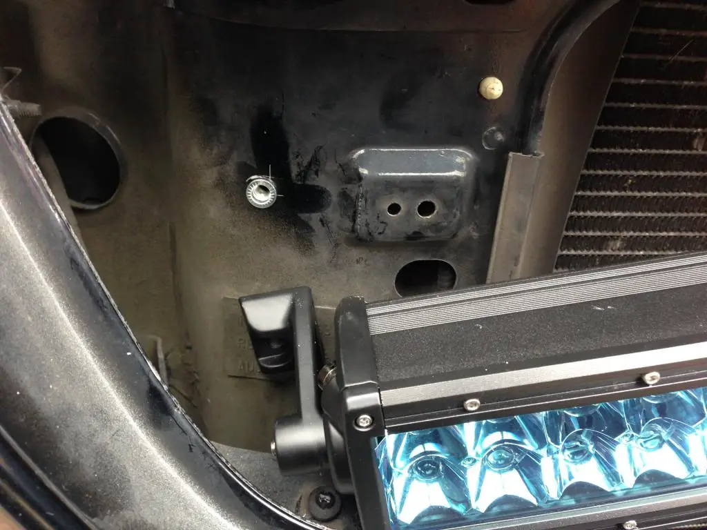

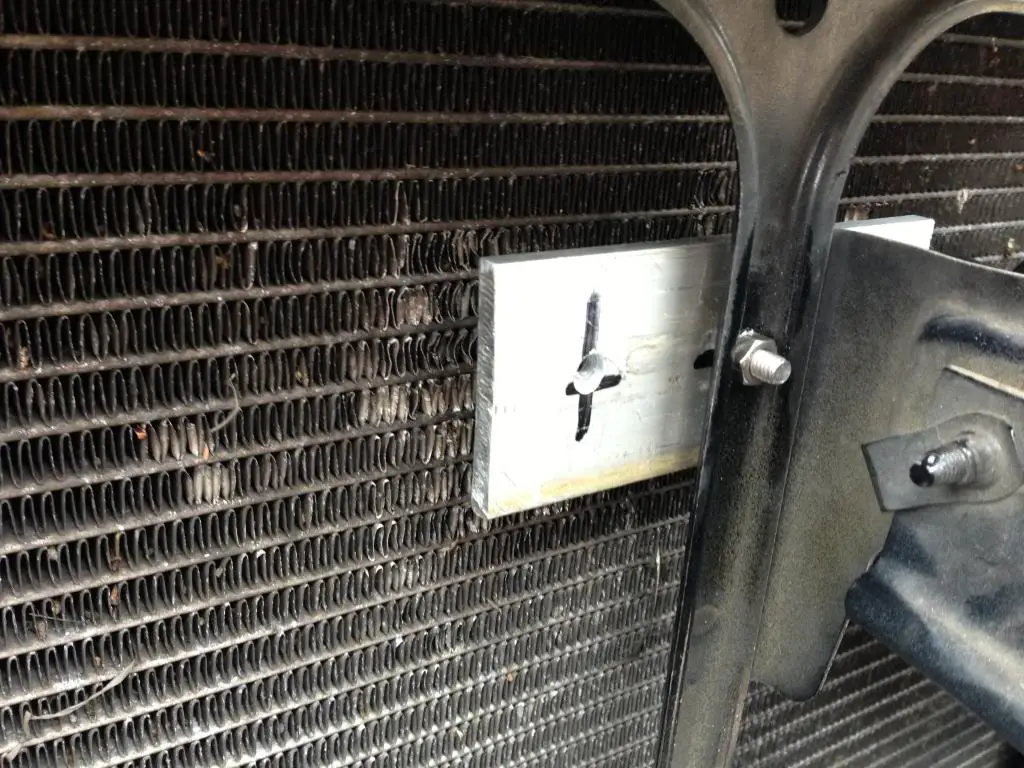

so today i installed some 10" long double row led light bars behind the grill,
one side of the led light bar is bolted onto the front frame,
,and the other side of the light bar is bolted to a bracket 120mm long which is bolted underneath the hood release mechanism.
this is how bright it gets! :)

hi mark, i did drive down the road with the grill off to see the difference, i dont really notice the light lose with the grill on the car, im putting on a 20" light bar on the lower grill tomorrow then putting a 40" led light bar on the roof next week, ill get back to you about the amount of light that i have with the 20" on the lower grill :)
