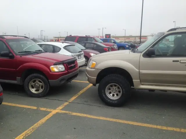

Looks like more with cladding off, but I'm not qualified to answer your question.
Sure it does man, you be proud of that entire 1". LOL
Get some hotrod grey paint and paint the lower portion of the front bumper, back bumper and where the side cladding used to be and it'll look really good.
Well it is 2" taller in the front- 1" tt and the tires gave another 1". Thanks midnight, I'll drive it proudly w/ my head high…an inch higher that is.

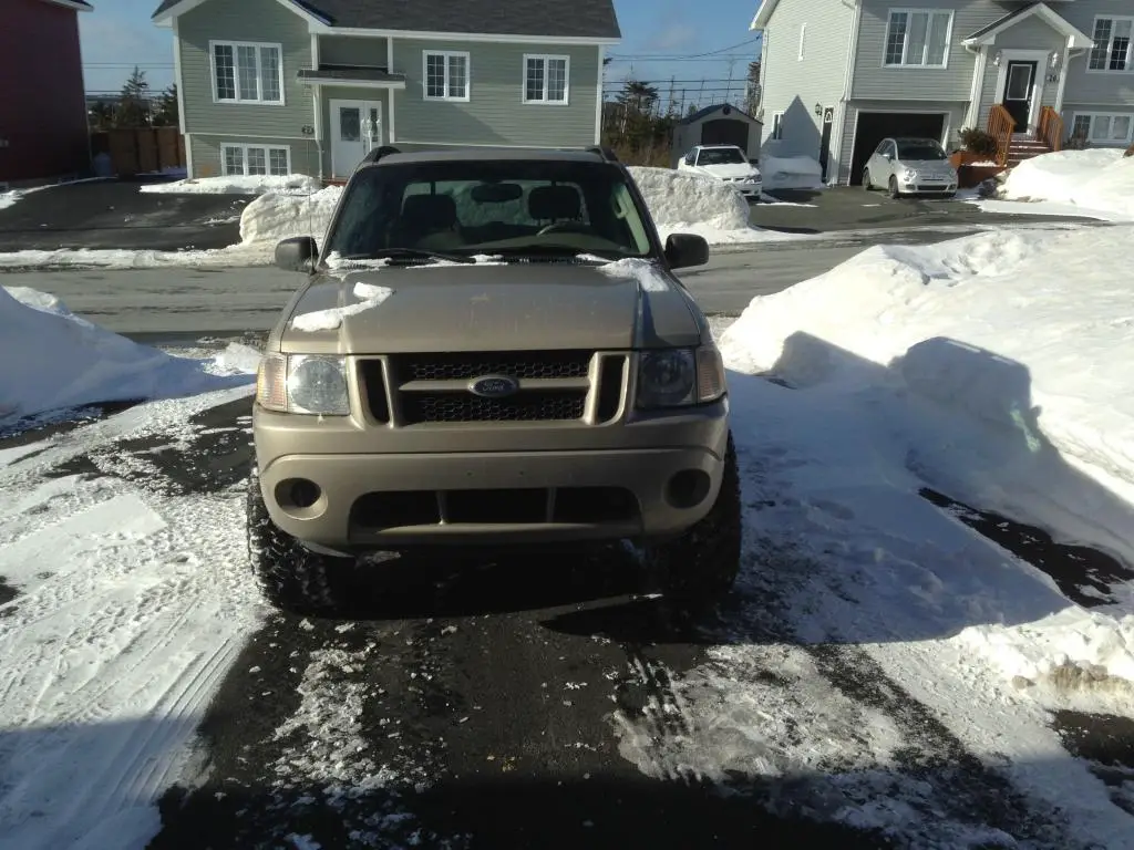

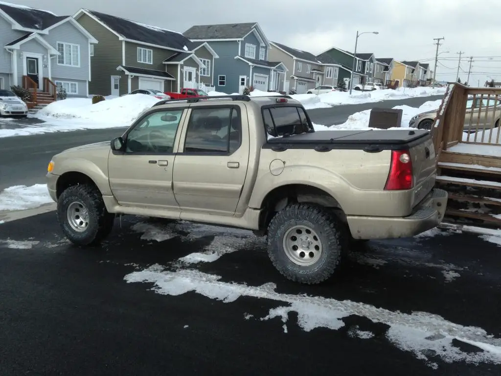

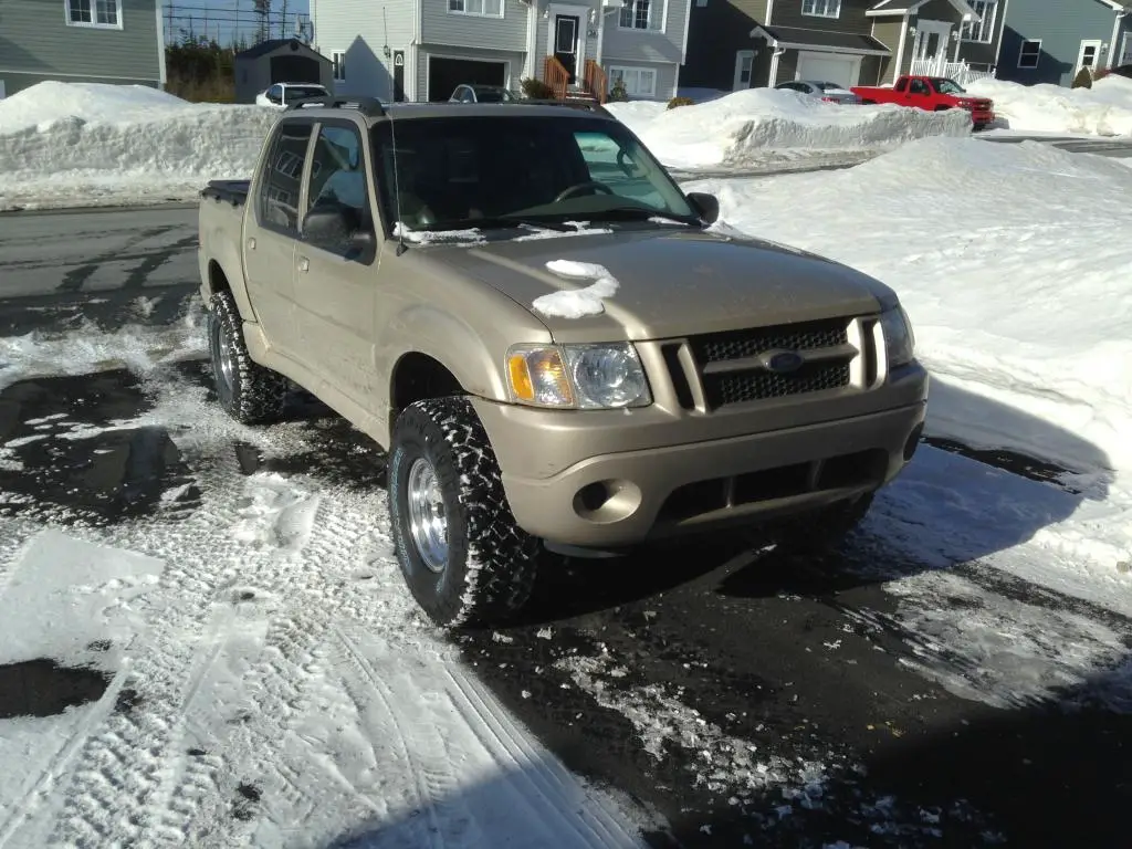

It been a while since I did this but here she is
3" body lift
Add a leafs, tort ion twist

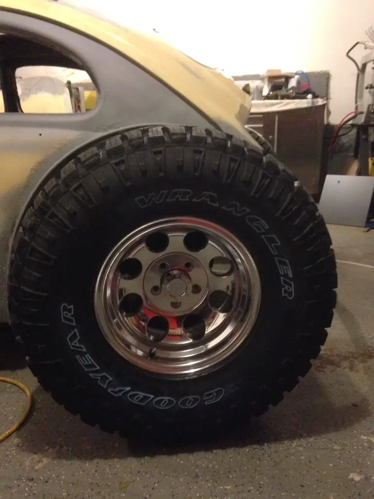

33"x12.5" good year wrangler duratracs
Some daystar body mounts. All done by myself on the gerage floor.
New tires and wheels
Before new wheels
Before tt and add a leaf
How she sits now
And a side by side for fun

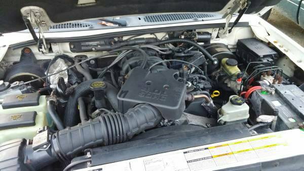

Here are some before pics of my ST just to show you where it came from.
Everything was stock when i bought it with a bad trans.
