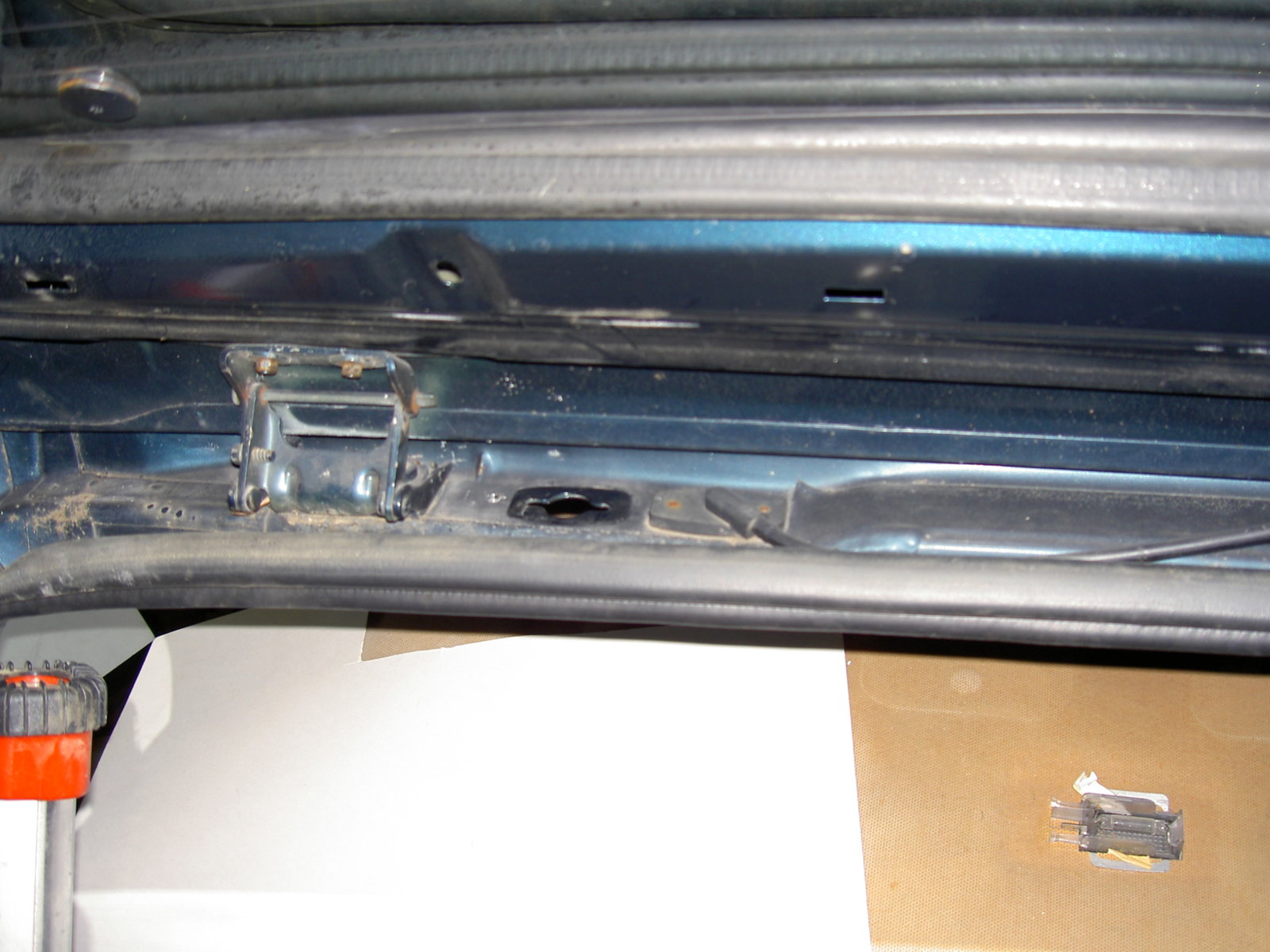

Dude... How do you post pictures like that. This would be so much easier. Can you post a picture of your hinges with the liftgate open so I can see if my hinges are bent or if it's some other problem. Thanks...
I wish I had time to run to the junkyard just down the street from me tomorrow but I have too many meetings and appointments. Tuesday and Wednesday are just about as bad. If I could see a picture of a good hinge in the open position then I will know if I should order new hinges, they junkyard may not sell me just the hinges. Someone please post a picture of the liftgate hinge in the open position Thanks...

Here's the best picture of my 93 hatch hinge, when I was changing the wiring.
