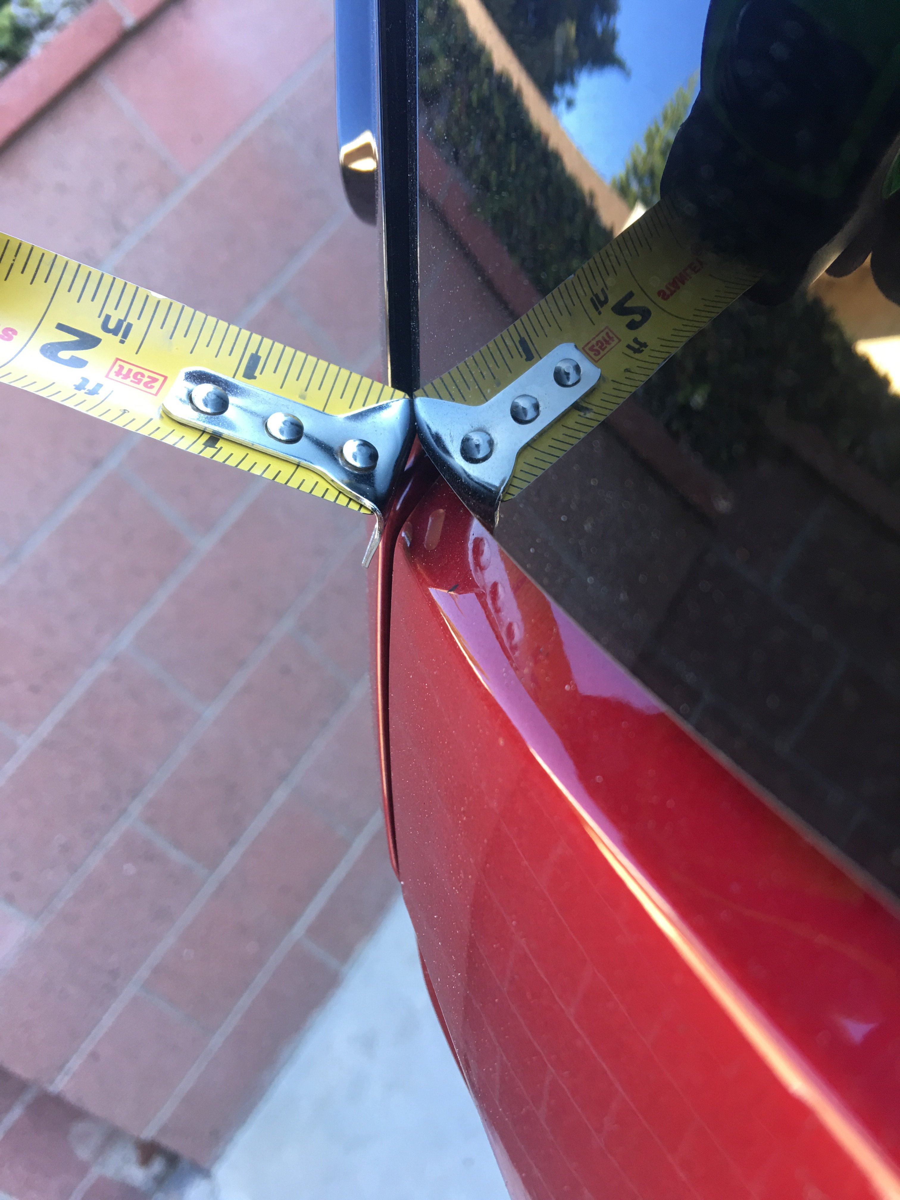

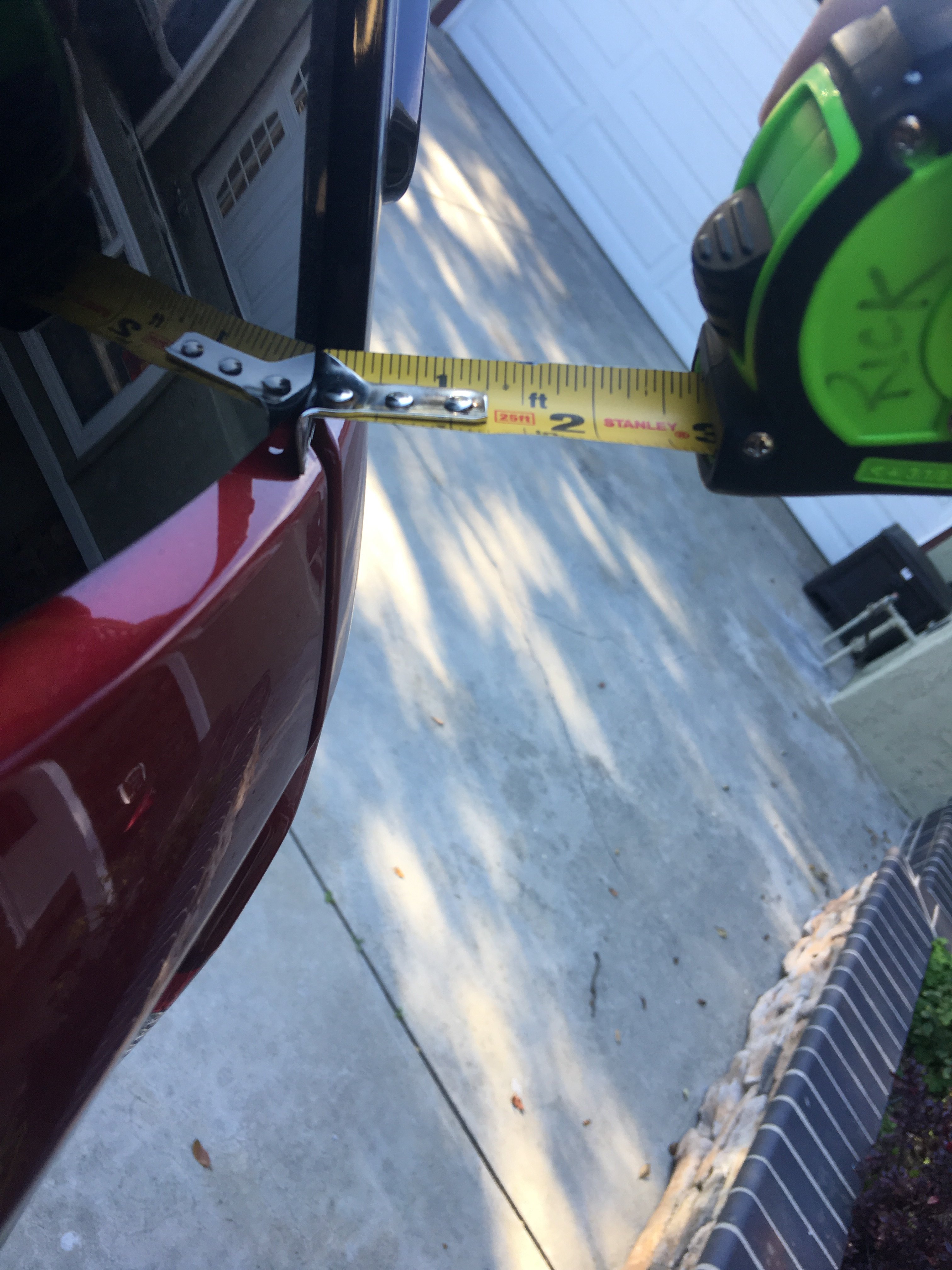

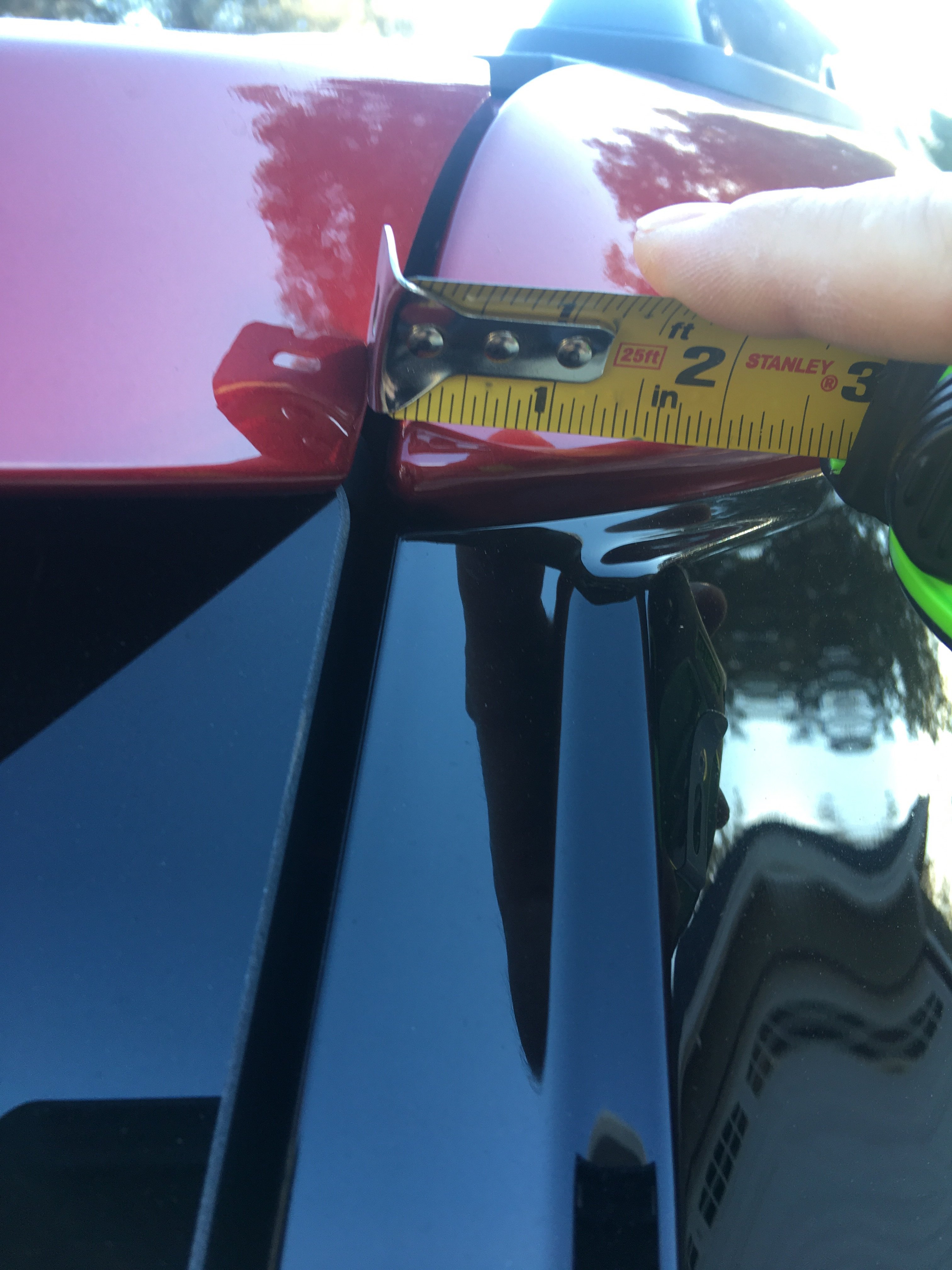

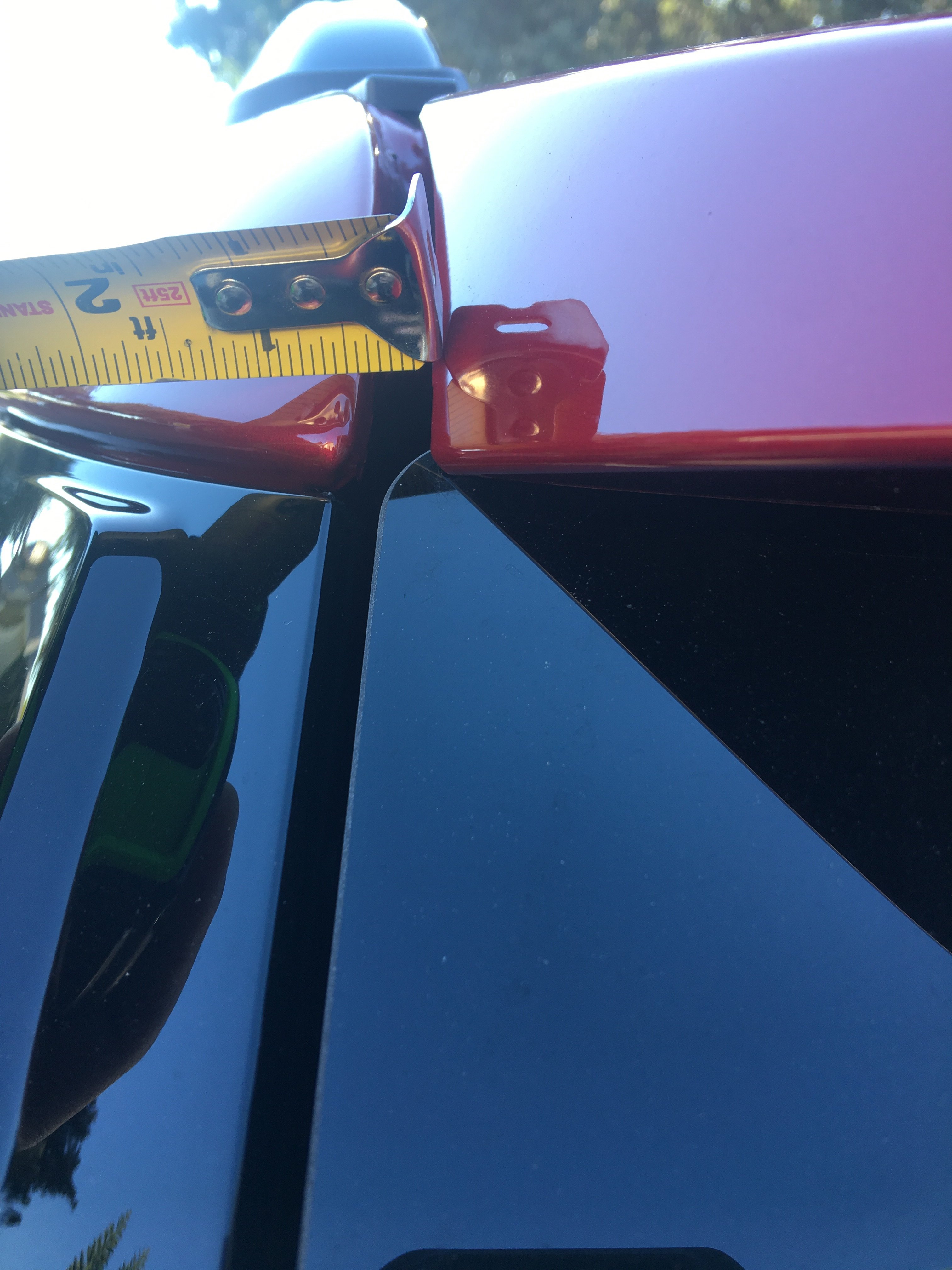

My 2016 Sports lift gate's alignment is biased so far right that it is hitting the tail light. I want to have the dealer fix it so it is on record in case the paint chips where it is rubbing. Anyone else have this issue or had it fixed or fixed it themselves?
Thanks!
Wow, it’s 2017 and my Sport has the same misaligned tailgate. Guess the issue never got fixed in so many years. I bought my Sport 4 months ago and had it at the dealer within two weeks for a popping sound come from the front end suspension took 3 attempts to get it right. I noticed the misaligned tailgate a few days ago and plan on taking it in. It’s an expensive vehicle to have these issues so early in ownership. Wonder if all 17’s have this misaligned tailgate?
