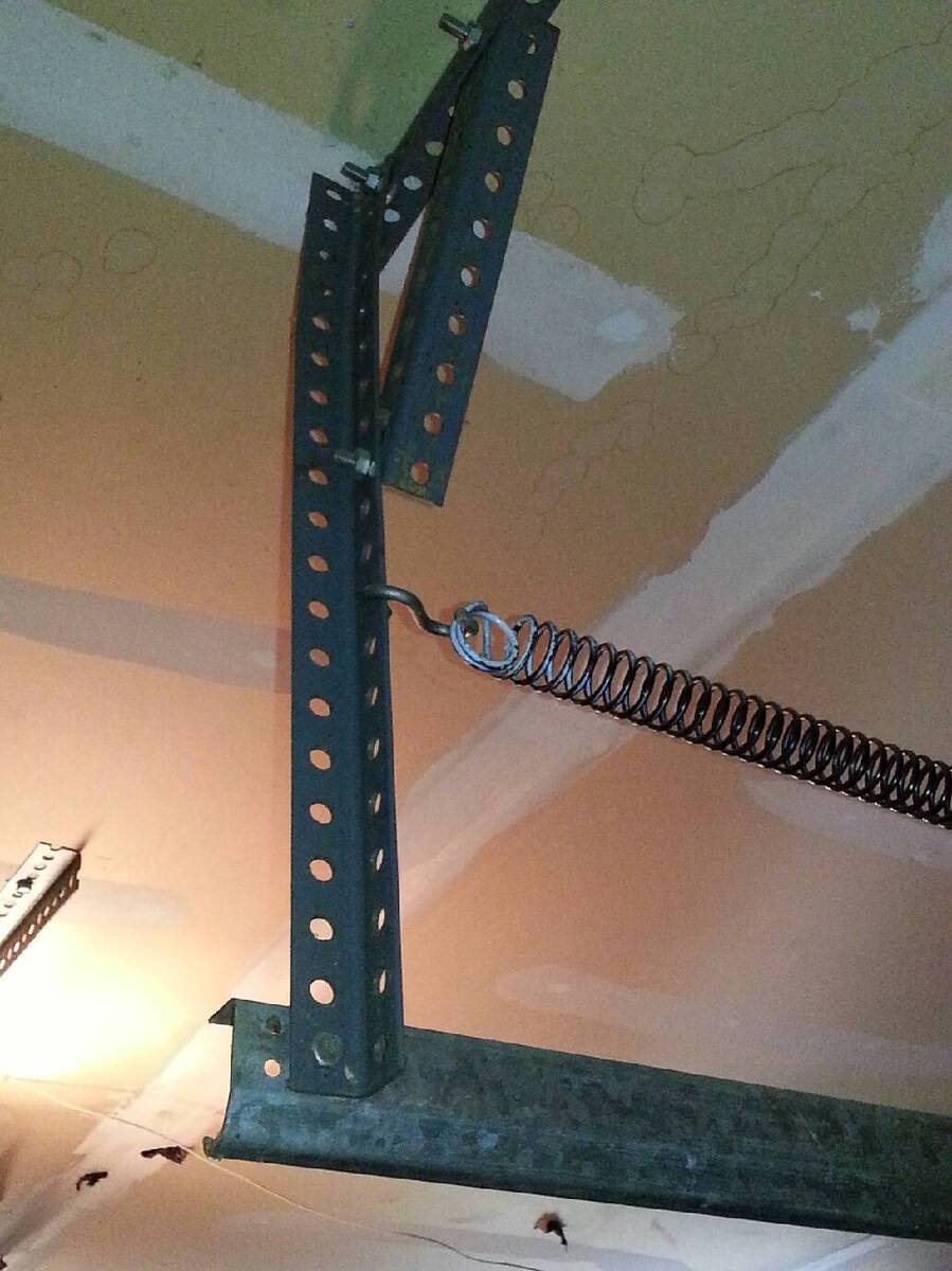

I got a piece of 1 1/2" angle iron with pre-punched holes. A 52 inch piece was about $13 from Home Depot, but I only needed 28 inches. For anyone who doesn't know, this is usually used in installing garage door openers.
