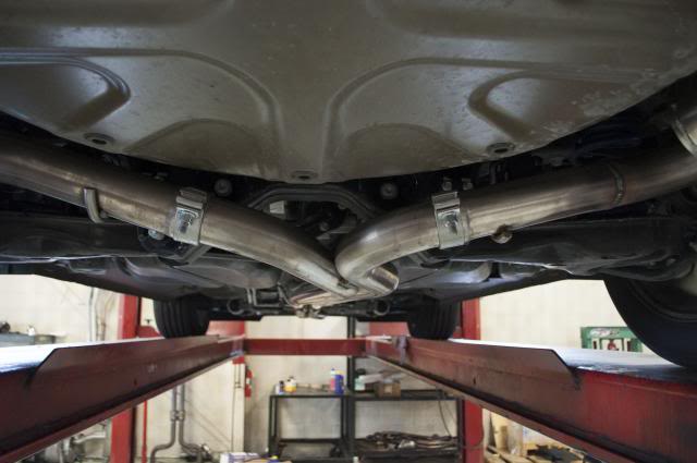

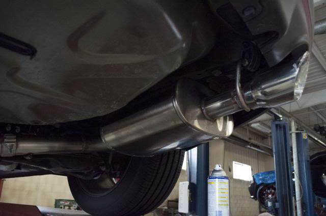

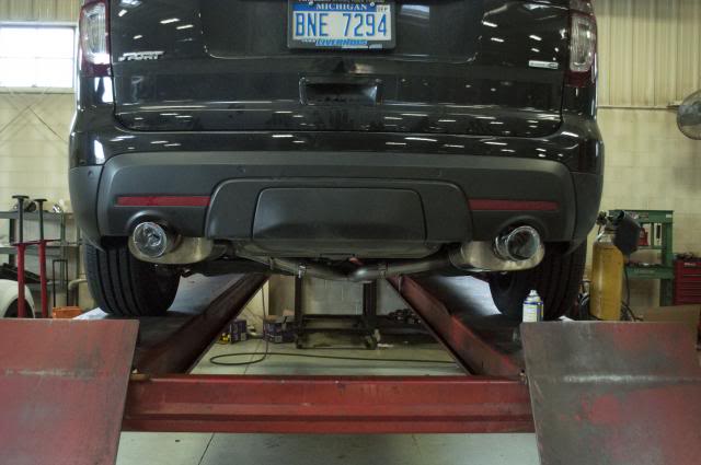

Hey guys we have some good news for everyone who has been patiently waiting for the Corsa cat-back.
A Livernois exclusive Corsa premium cat-back exhaust system for your EcoBoost powered Explorer Sport. Many hours of r&d have been put into this product and we can not be more pleased with the fitment and sound of this system. We are currently taking pre-orders for the first batch due in mid January.
This system has been designed to feature the same quality you expect from Corsa, and the Performance that you expect from Livernois Motorsports.
Some features that this exhaust has include:
USA T304ss
Full 2.5" Mandrel bent piping for increased flow
Deep Throaty sound, modeled after the successful Corsa system for the SHO
Fully compatible with Upcoming Livernois performance Downpipes for the ultimate performance exhaust (coming soon)
To Pre-order this system, please visit this link:
http://www.livernoismotorsports.com/products/2013%252b-Explorer-Sport-Corsa-Cat%252dBack-Exhaust.html
