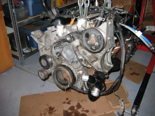

the grounding wore for the block goes right along the underside of the timing cover, above the steering rack. It attaches to the block in two spots if I remember right...
let me dig through my 96 build thread and find pics.
On the bottom of the engine in this picture you can see the ground strap, it is wrapped in conduit and attached to the bottom of the engine with two long metal straps from the lower timing cover bolts to hold it in place...

it attaches to the pass side of the block somewhere...still looking for that

it grounds on the passenger side motor mount
