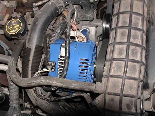

Alternator is on.
Took a whole 10 minutes. Easy! Anyhow, now I've got 200 juicy amps of electrical goodness on tap for my enjoyment!

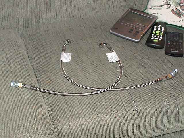

The SS braided brake lines fron Classic Tube finally got here. Extended 8 inches. Hopefully this weekend I can slap on the Warrior shackles and twist my torsion bars a little.
EDIT: BTW, these are the front lines.
How much did thoes lines cost ya?
Since they were a completely custom job, they were about $40 each. No one makes them for my year of X, so I had no choice. They do look good though!

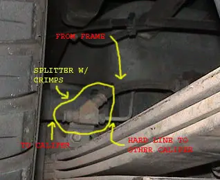

Unless your rear brake lines are different than mine, they won't make them. I sent them a picture of the rear brake lines, and once they saw them they said it'd be too much. Ford got cheap and used a lot of crimp on connections back there. That's why I only got the front lines. If you know the sizes of all your hardware, then they'll probably do it.
I'm going to have a local place make some custom ones for the rear. Or I may just order some separate lines and do it myself.
Here's what scared them:
The rubber hose is crimped to the splitter from the frame and to the driver side caliper. Then the other end is crimped to the passenger side caliper.
I think I'm just going to replace the whole rear setup fromteh frame hardline down with SS braided hose.
