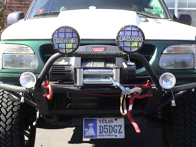

Winch pics.
Kinda lopsided w/out that fender.
Warn 9.5 ti Thermometric.
Gotta love the extra set of battery posts.
are your offroad lights adjusted?? they look a little out of whack.....
but besides that truck looks great
PEACE
Is that 2nd post set on the Optima an accessory item or does it come that way?
Nope, none of the lights are really aimed very well. None of hte lights are even connected right now! :p Had to take them off to paint the bumper and never hooked them back up.
