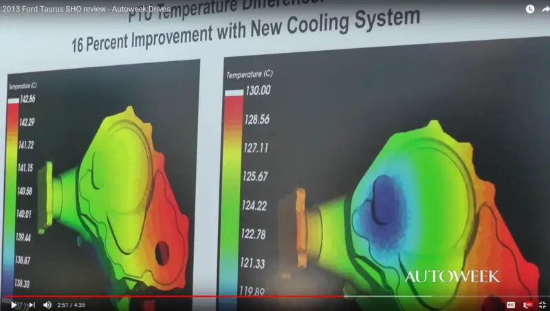

As for the water cooled PTU, it doesn't seem to really help. Because PTUs are still failing left and right. Even with the 3rd change in June 2016 (revised idler gears) they are failing on 2017 models. The water cooling apparently only cools down the case, and not by a whole lot.
