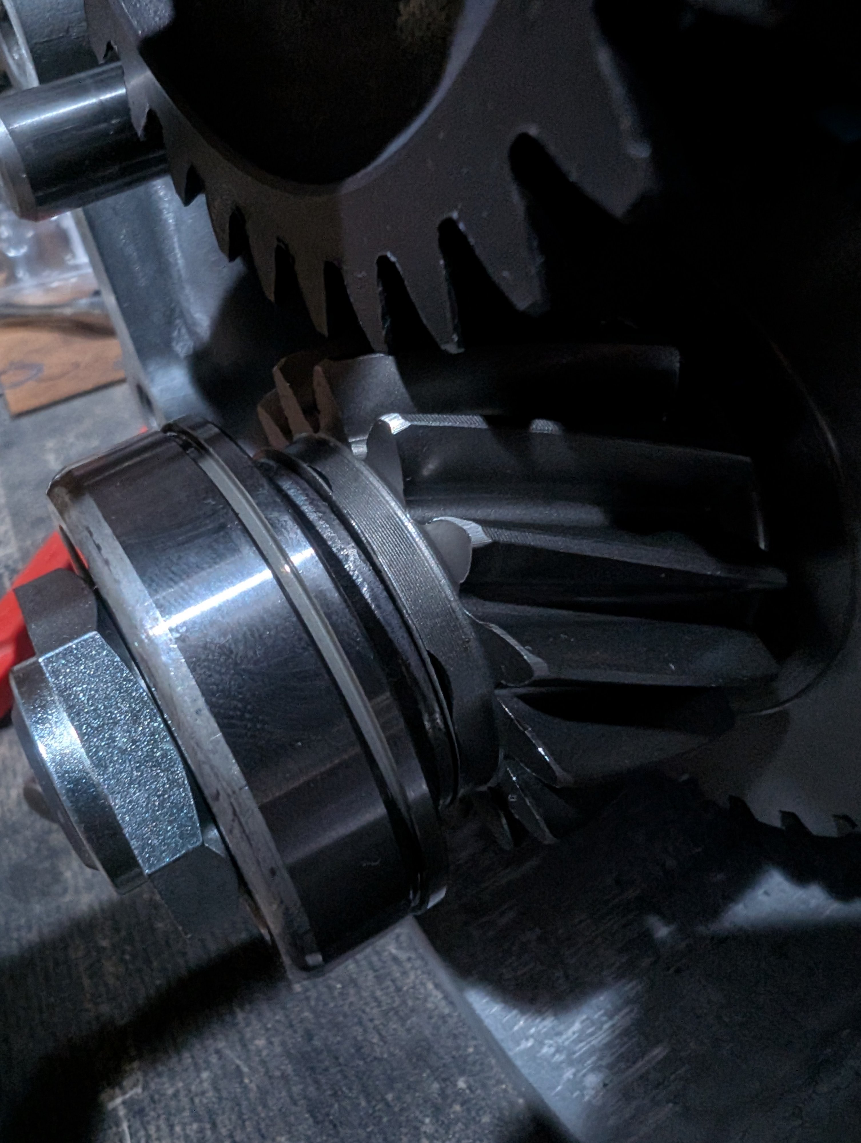

0.010 shim made and installed.
Clearance is now measuring between 0.011 and 0.015, so I'm calling it in-spec on average.

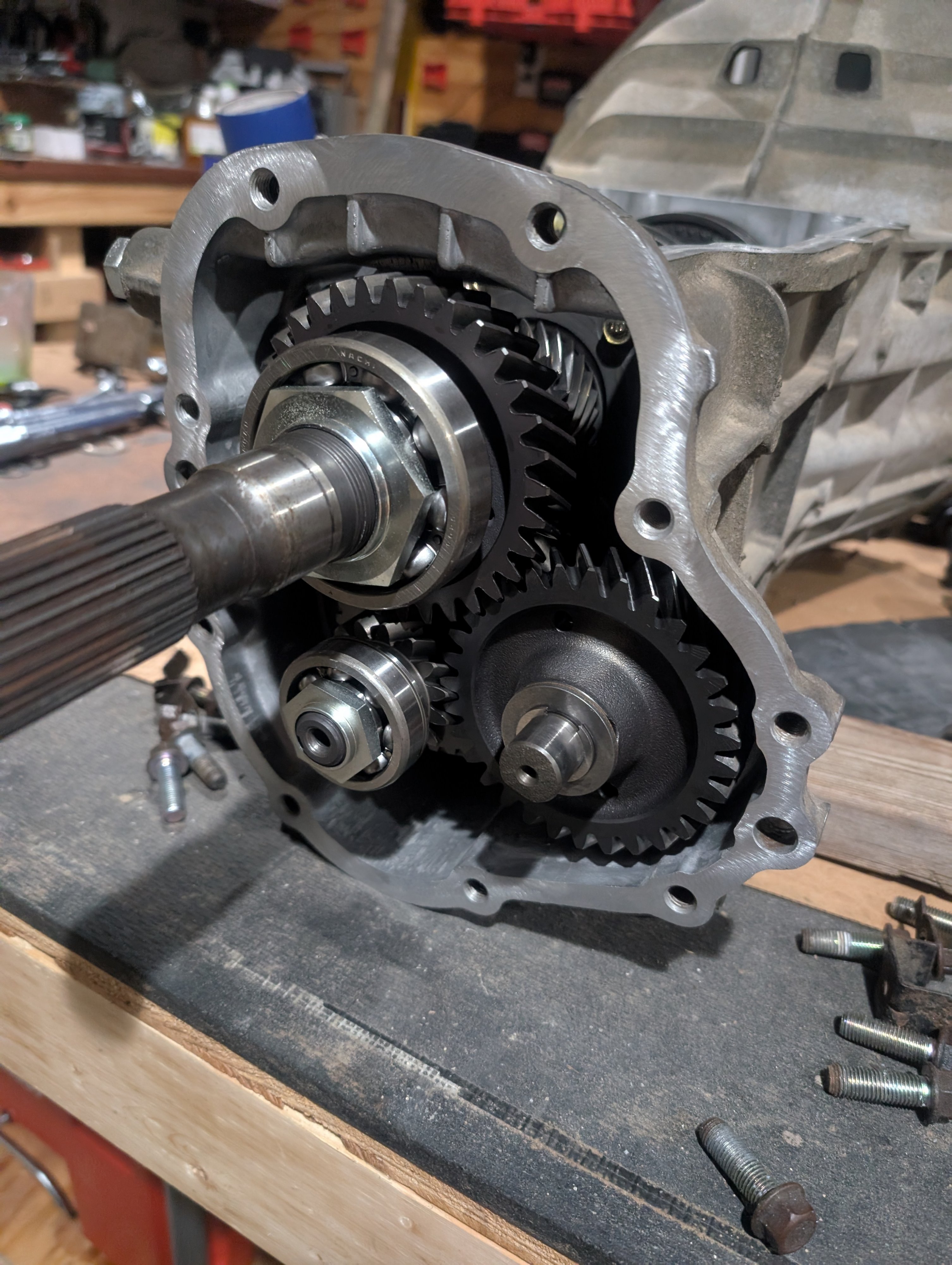

Rear bearings and lock nuts installed.
I'm going to need the missus to help hold the case while I torque them. Then they get staked in.

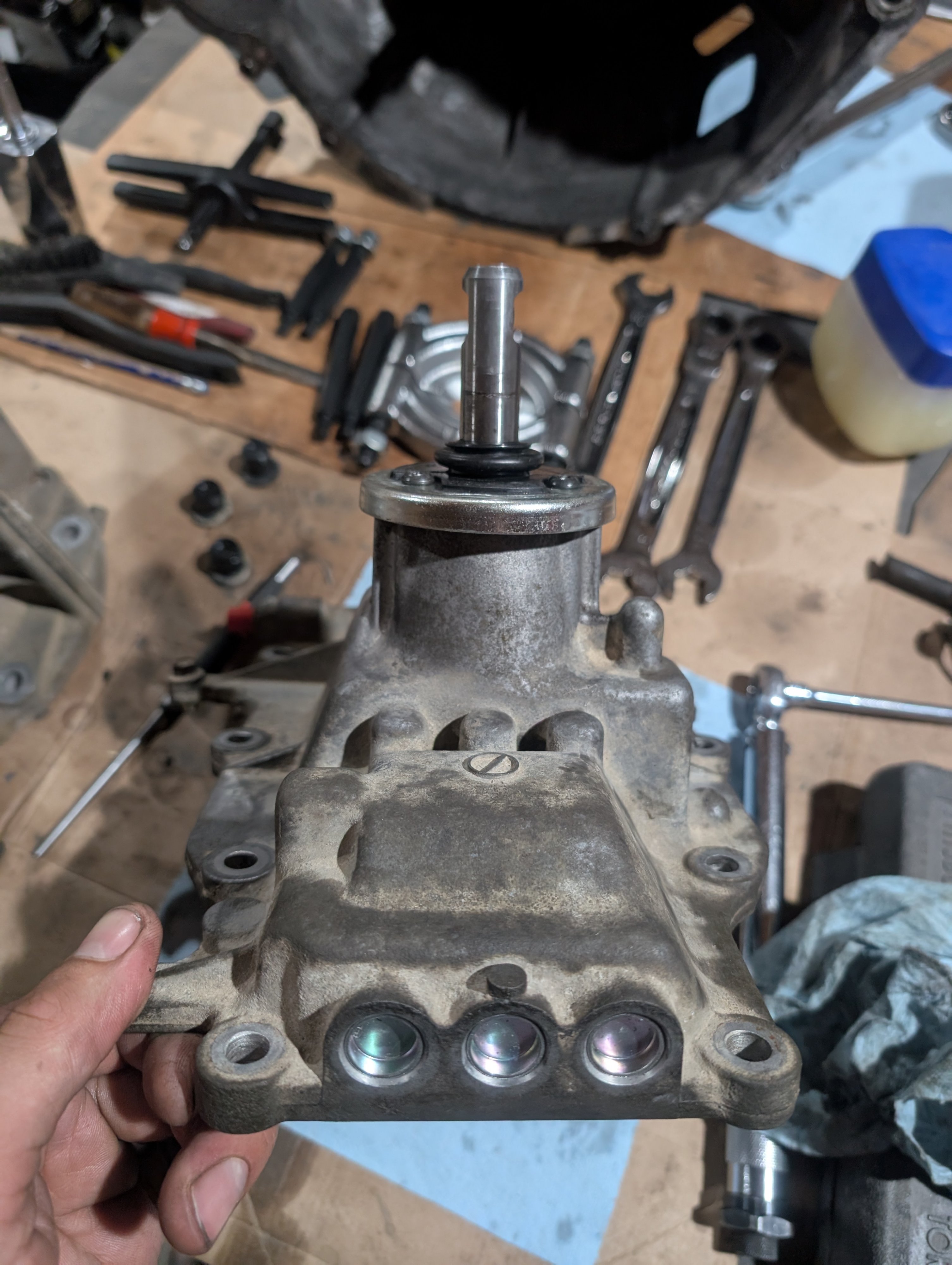

Removed the rubber rear shift rail plugs and punched the pins out of the 1/2 and 3/4 rails.

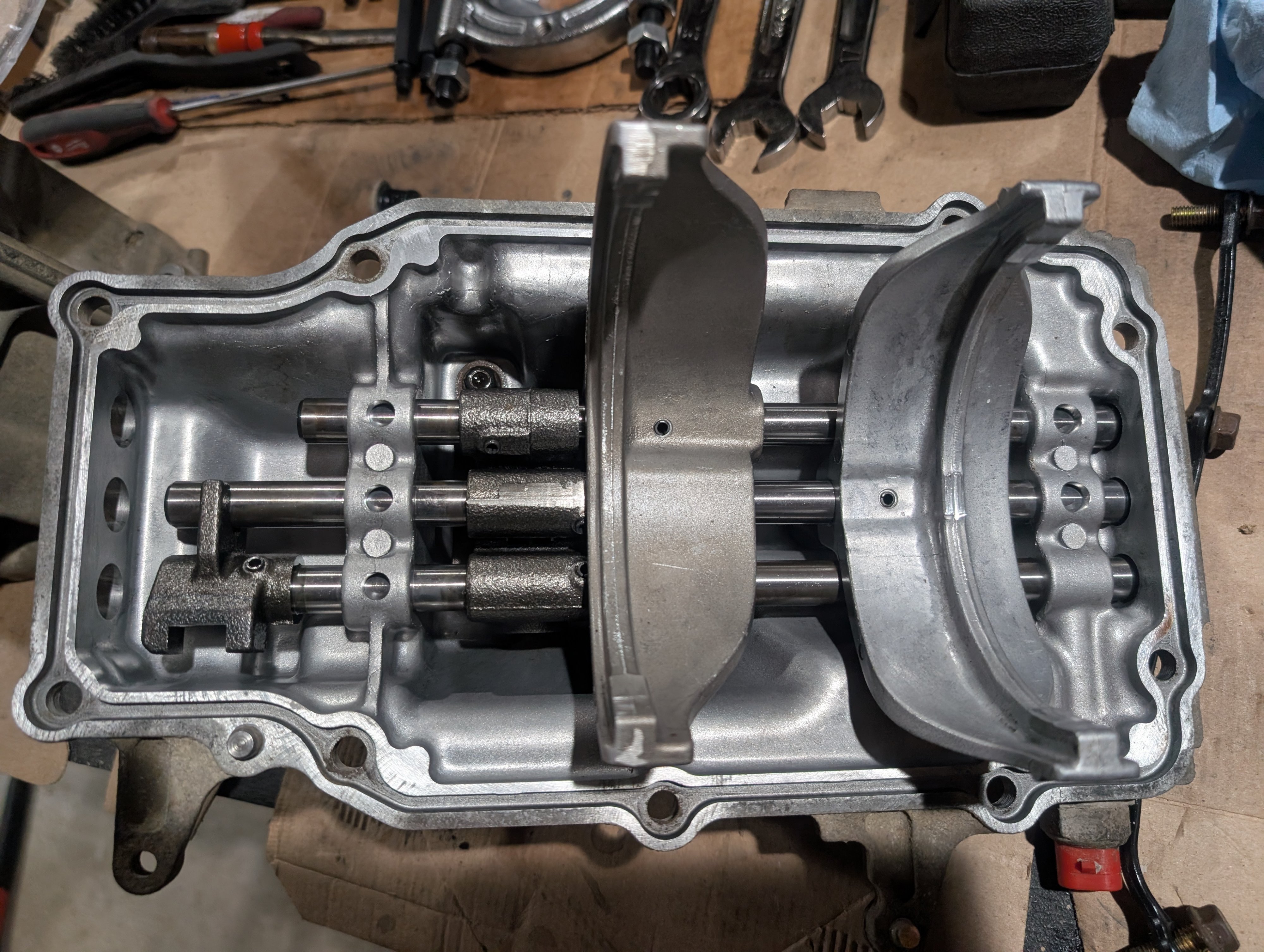

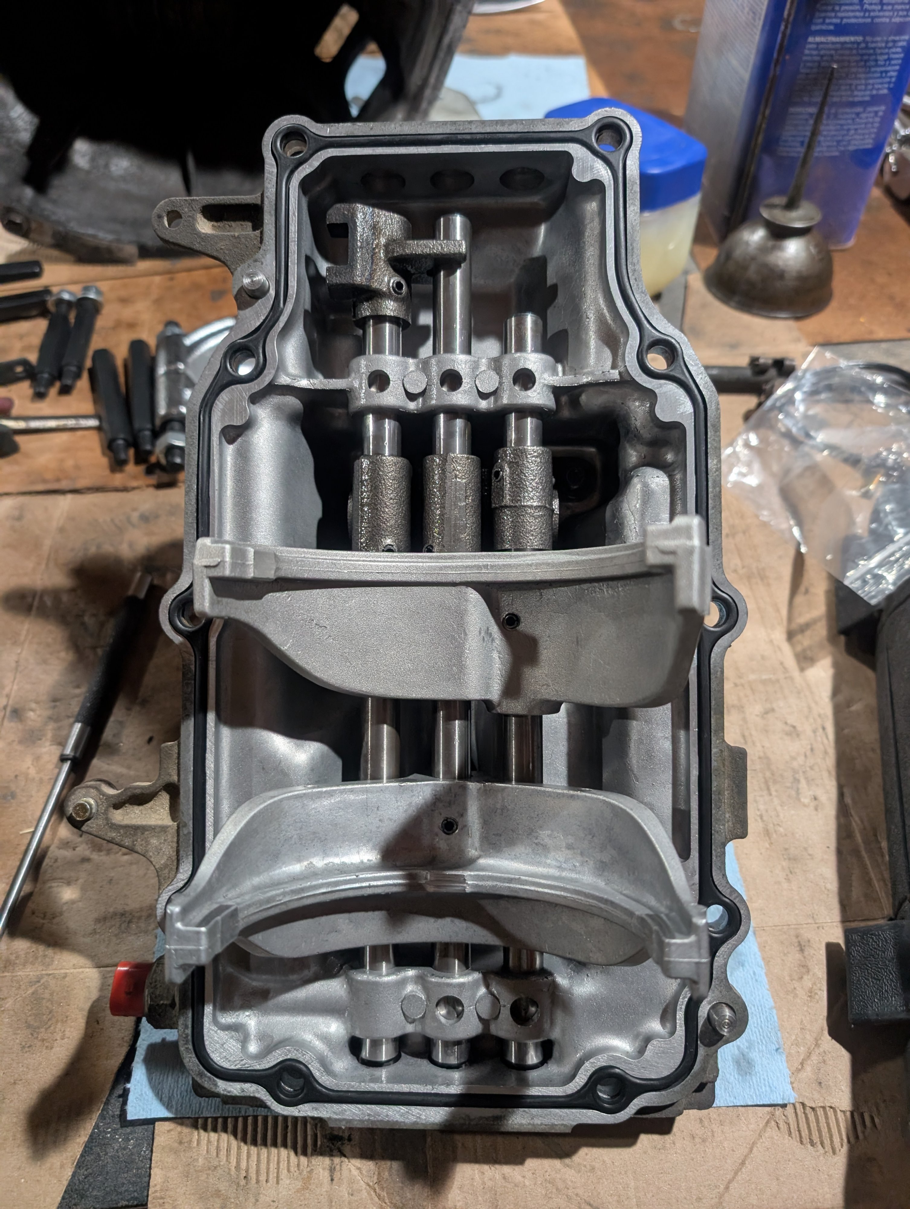

You have to slide the 3/4 fork off to get the 1/2 fork off. The less-used 1/2 fork was installed in place of the old one, then everything went back where it was.
Make sure you get everything back to neutral (position shown in both pictures above) or you'll be confused and/or sorry come reassembly time.
I went ahead and installed the new cover gasket, steel shift rail plugs, and new shifter bushings and dust cover.
