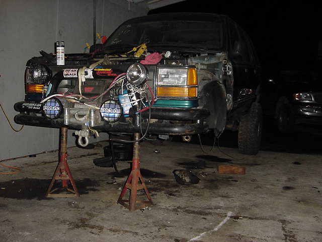

I spent today pulling out the stock front end and getting my track bar mount installed. The coil buckets are ready to go in, and then the front axle. While I was underneath, I grabbed the sledge hammer and made room for the Atlas II t-case and shifters.

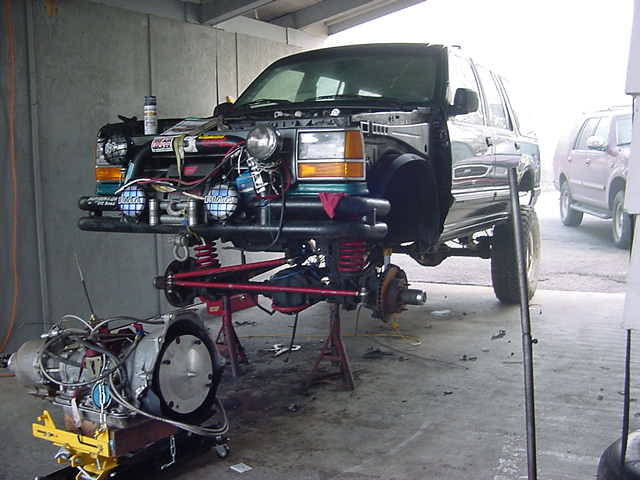

Yet another update
The rock sliders are on too, but I took the pic before that. You can see tommorows task sitting in front of the Ex.

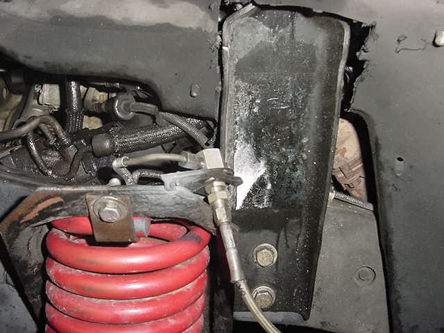

Can you post a pic of how you built your coil buckets/shock towers? :) Thanks!
I need to make a set but want to see a good clear pic of what someone else has done before I start wasting metal. :)

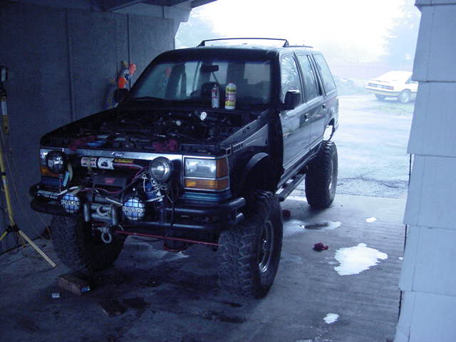

Update
Tranny is in, rear driveshaft in, brakes bled, and sitting back on her own shoes. All that's left to make her move is T-case linkage. It has a bit of a rough idle, but runs great at higher RPM's. I think it needs a tune up as some of the spark plugs may be fouled.
Mine are pretty basic. The shock mounts are stock F250/F350 shock mounts. The coil buckets are from the 79 type broncos. The lower bolt on the shock mount, which already has hole in it, went to the lower right rivet hole of the stock coil bucket(see last pic).
The coil bucket was cut down(off the bottom) and then the lower left rivet hole of the stock coil bucket was used to center the coil bucket on. On the drivers side, because of the way the frame is shaped, there is basicly only one position that will work properly.
Hope this helps.

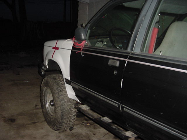

Where is the updated pics? I wanna see that white fender :)
Update
Sorry it took so long. I couldn't find my red tape. :D
I am glad it went to a good home.
