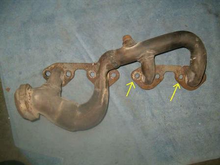

In regards to the bolt size, I went to the dealership earlier this week after I discovered two bolts missing too (1 each on the left side of cyl. 1 & 2). They told me the bolt was 3/8 X 16 (coarse thread) X 2.19". However, 2" was too long so I went with 1" bolts and they went in fine without any problem. I was checking my plugs when I noticed it. I've had this truck going on 3 years and taken the plugs out 3 times and I didn't even notice it. I don't have a leak but I'm glad I caught it in time before one started.
I grabbed this picture off the site to show what bolts were missing.

You like my pic?:D

You like my pic?:D
I was hoping you wouldn't mind if I borrowed it:D
