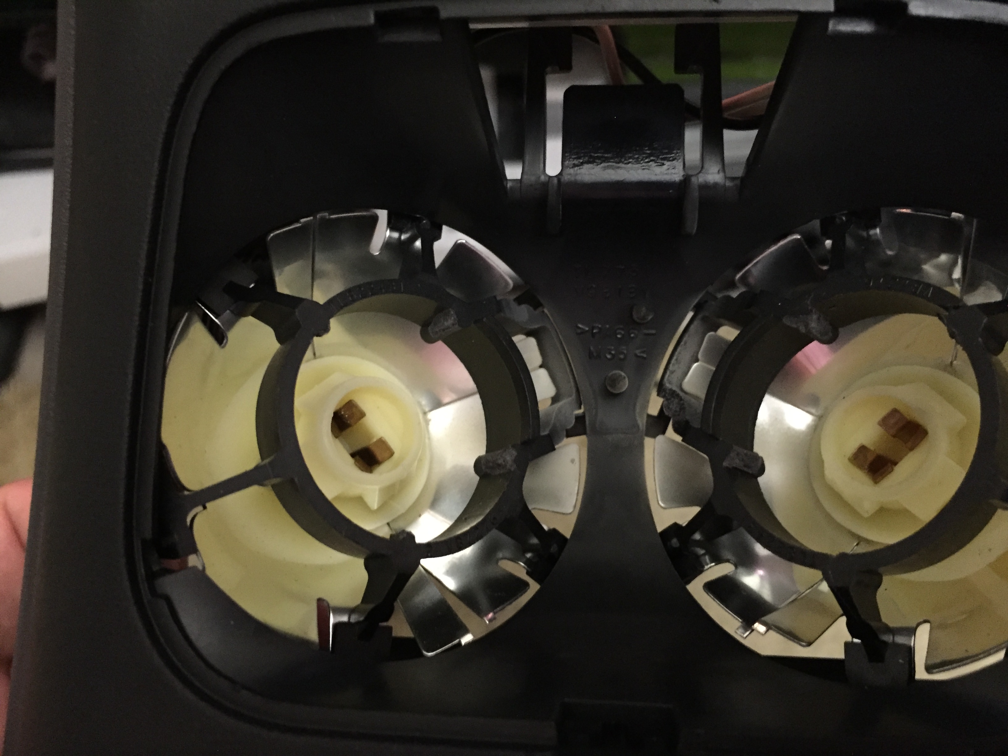

I had to replace the overhead console on my 2000 XLT. The replacement console does not have light bulbs. When trying to buy new bulbs, I found out that there are small parts that the actual light bulbs fit into. There is one for each bulb. I am not sure what the part is called and cannot find replacements.
A better way to describe the part is.....when you remove the plastic lens on the overhead console light to expose the bulbs, and then you remove the bulb, the part is the little grey thing in you hand. This part actually holds the light bulb. In other words, the bulb has to be seated into this part before it can be inserted into the map light socket/dome.

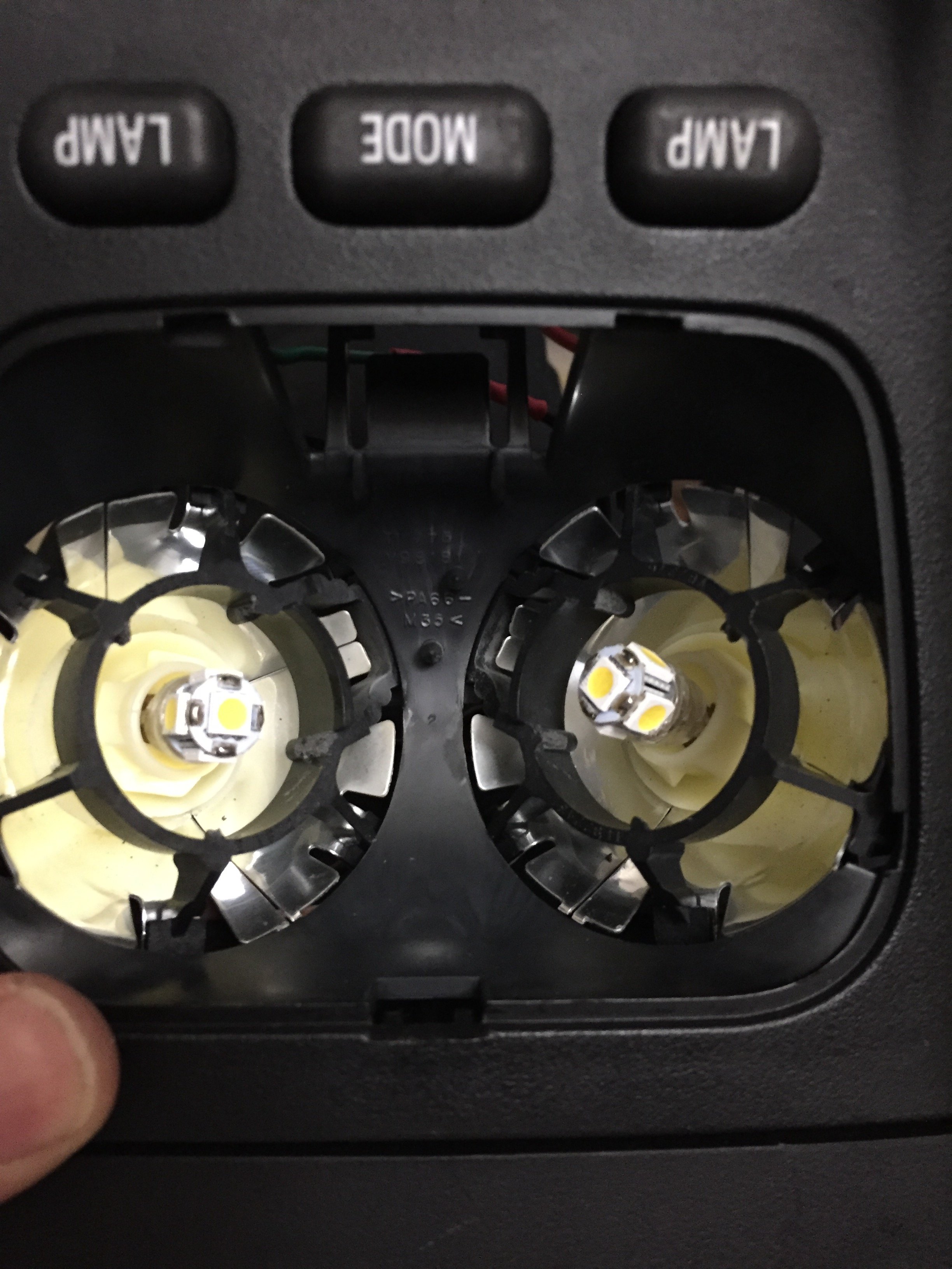

I tore out mine and replaced them with 194 sockets, with led bulbs a couple of years ago. I could post a how to, if I get time. I got tired of always ripping the circuit board that lit the stock bulbs.
These pictures should be a good reference.

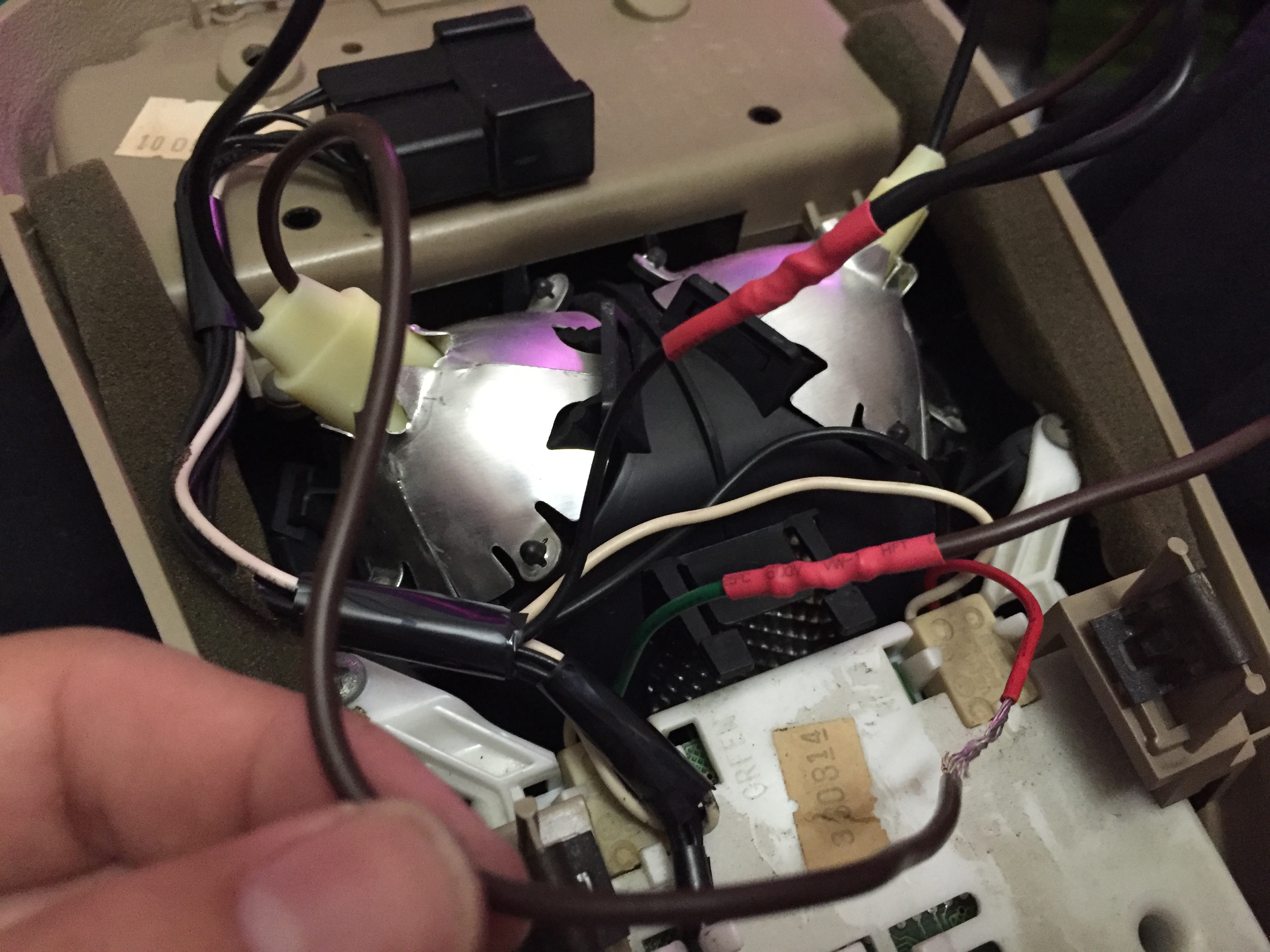

Thank you very much. Seems so odd that I can't find any threads about how to replace the stock bulbs with stock bulbs... Everyone seems to have migrated to LEDs. I would do that, but I seem to get the console down. One of the wiring harnesses seems to get stuck. I'll try to take a picture and post it later in case you have any suggestions. Thanks again
The connector for the overhead console has a tab that you need to press down before disconnecting it. It’s a bit hard to do because you have to reach behind the console, but press down on the tab and it’ll disconnect. It just takes some time.
I was able to disconnect the connector, but then there was one more harness in there that sort of rotated and appeared to be connected permanently... I owe you a picture
Same idea, some parts the same (194 light sockets and pigtails), I removed the black grates from the reflectors though. No drilling or cutting. Zevo led bulbs
