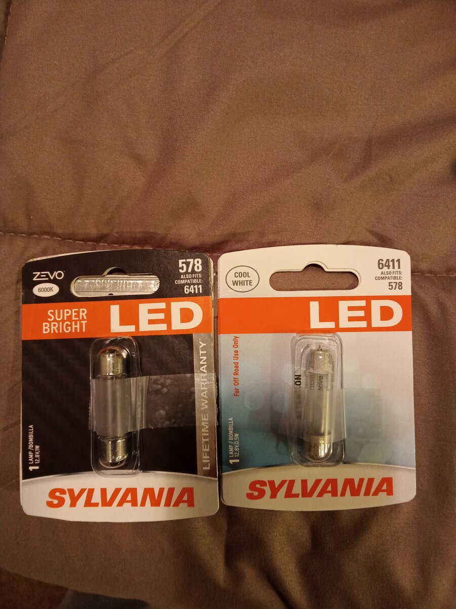

Removing the entire housing of the dome light is the most simple way to change the bulb however the lens does fold down. Getting the bulb in the correct place is a different story when you can't get to it because of the soil layer does it has as a reflector. Attached are some photos of how to make it very very simple to install a bulb if you have the correct tools. That tool is a screwdriver and a t10 star bit. You remove the entire housing when you turn it over you will see four screws that are Star bits they are t 10s remove that and you can easily get to your bulb without removing the foil and breaking mini parts. You can also do a thorough cleaning of the foil to ensure that your bulbs are as bright as they can be.
