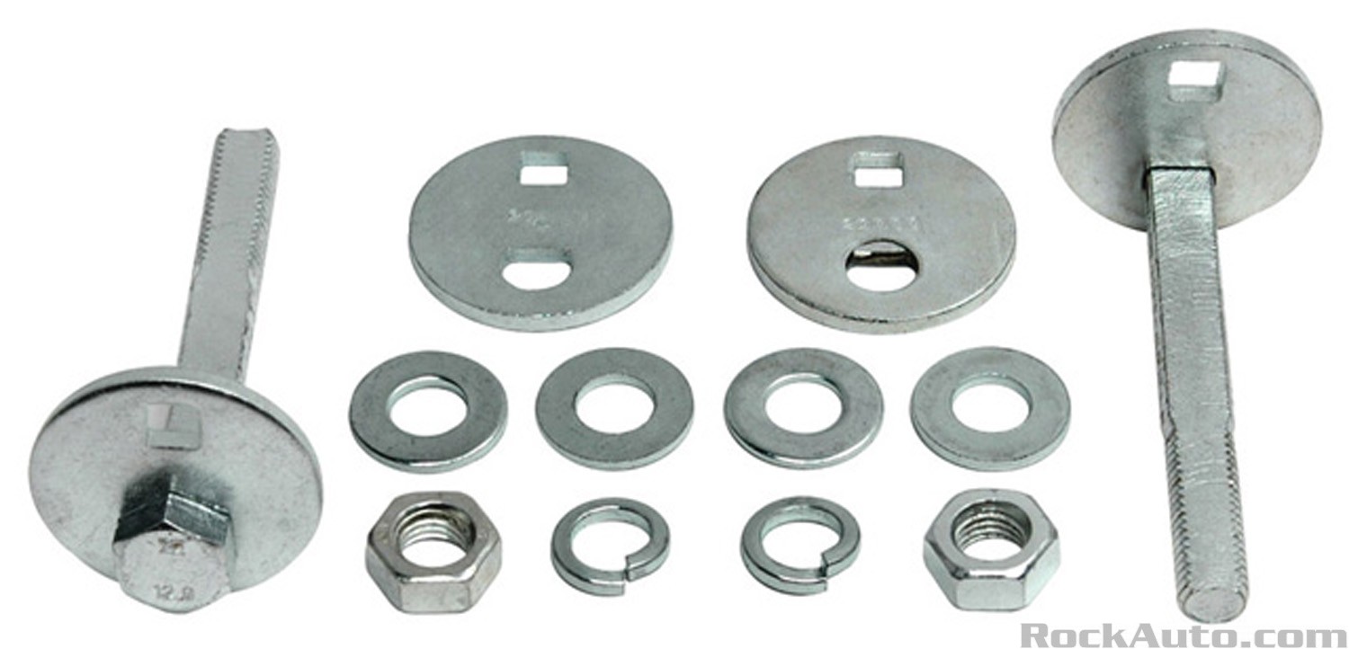

Is this it BoominX?
Those looks similar to the Moog ones, I think boom was describing something different.

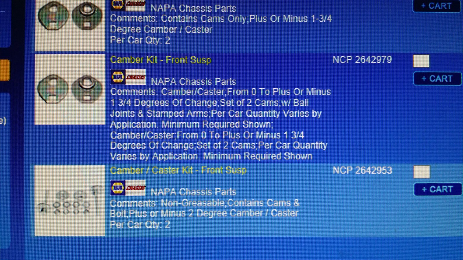

The bolts I got from NAPA say they are good for 2 degrees.
The kit I was talking about only replaces the nut side plate on the factory adjuster. When you pull the arm all the way out and put the flat spot to the inside that is 2*. You sometimes have to elongate the slot the bolt goes in to pull the arm out towards you enough to get that flat spot on the adjuster to set right. I found this will give you the most positive camber. The eccentric bolts like dono posted technically only max out at 1 7/8* + or -. I do suggest using the eccentric ones unless you have serious camber issues.
I have found most places list them backwards also. They list the eccentric bolts going to 2 and the plates going to 1 and 3/4. I definitely have gained more positive camber with the plates than the eccentric ones when I was lowered with flipped torsion bars back in the day.
