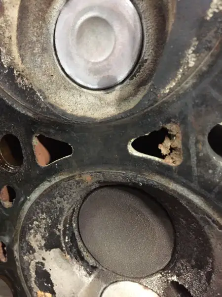

Just an update, I've been keeping an eye on my coolant level and it's still dropping slowly, so I am biting the bullet and pulling the heads. I've checked for slow external leaks, used the AC Delco radiator stop leak tablets. Sometimes it will still misfire when cold so I am convinced beyond any reasonable doubt the head is cracked. So far I have two new heads coming and a new gasket set with head bolts.
What are thoughts on reusing the hydraulic lifters, rocker arms, and pushrods?
Pushrods are cheap, but the cheapest name brand set of hydraulic lifters (Melling) are about $29 each at RockAuto - not an insignificant amount of money for a set of 12.
Enginetech lifters are about $11 each, but I've heard Enginetech doesn't make any parts and therefore these are basically white box parts with questionable quality.
I re-used mine and everything is fine. The parts had around 250,000 miles on them. I would have replaced them if I was looking into a long term repair, but I see a 5.0 swap in the future. I would have just rebuilt the entire engine but I only need it to last till next summer.

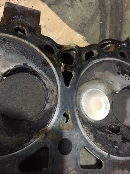

Made some good progress today. Got both heads off, and as I suspected, the head of cyl #4 was cracked. It was hard to tell at first because of the carbon build up.

The bores of cylinders 1 & 2 look pretty good to me, still can see the cross hatching. Cyl 4 and 5 don't look quite right. Can't feel anything with the fingernail though. Going to let the bores soak with a bit of carb cleaner and ATF, maybe scuff up cyl 4 and 5 with some green scotchbrite and see how it looks.
Cyl 4:
Cyl 1:
Overall this was not an "easy" job but not terrible either. One of the more fun jobs so far, everything came apart pretty easily, much more fun than taking out a transmission.
