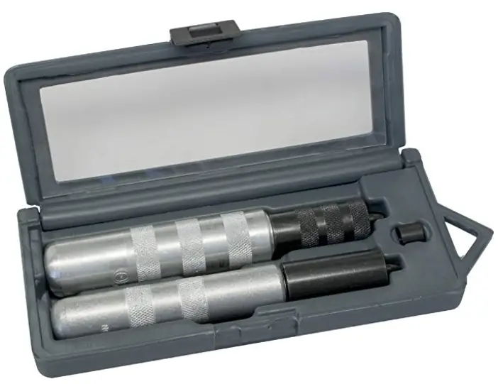

I've been practicing removing the valve springs and seals on my old cracked head using the Lisle 36050 kit. It easily removed the springs, but it was tough getting the intake one back on, and I couldn't get the exhaust one back on even on the bench. I feel like this would be impossible to do on vehicle. Any suggestions or tips to make this easier? Maybe try a different style tool?

I've never seen the one you chose but then I happened upon a YouTube video by a guy that calls himself "Eric the car guy" - just linking the video because maybe maybe this will help? Also, read the comments, maybe that will help you edge your way over The Rubicon ;)
[media]
You could try this one if you have a Harbor Frieight close by. It's cheap enough that at $12 (and then a 20% off coupon) it's worth a shot.
Also, read the review comments for ideas on how to modify the tool to work for your application.
With a tool like this, it appears that you might have to have a good selection of vise grips, and maybe some heavy duty zip ties.
Link to Harbor Freight Coupons: Harbor Freight Coupon Database
Link: Universal Overhead Valve Spring Compressor
Good luck!
Thanks Dave! I got one of those jaw-type compressors like you showed, and it worked. Mine was an OTC-branded tool from Amazon but it looks exactly like that one.
