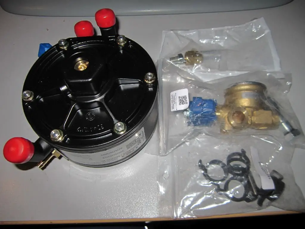

Onother thing could be the LPG evaporator, the LPG is worm up by coolant, if 40°C is reached the LPG computer takes control.
The coolant is seperated by a rubber membrane, which frequently cracks.
So coolant could be burned which could cause a misfire too.
On the other side LPG could get into the coolant, LPG bubbles getting into the coolant reservoir.
If you have a PRINS evaporator older than 5 years i would take a look at it.
This is my third one.
These are the water side issues, but there could be a LPG side issue. Read about bad things, sometimes the plastic air intake
is busted/exploded while both Petrol and LPG was injected at the same time. Big misfire!
So take care of the LPG system, LPG filters must be serviced regularly, no LPG leaks in rubber hoses, loud ticking of LPG injectors
will annouce the end of life span.
