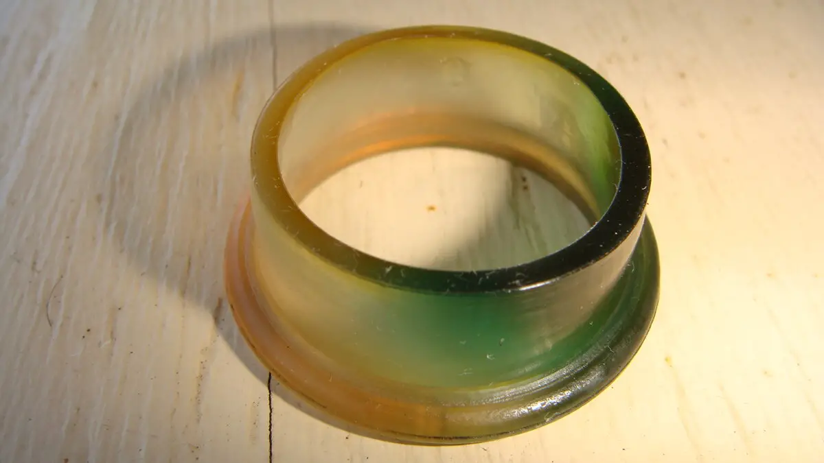

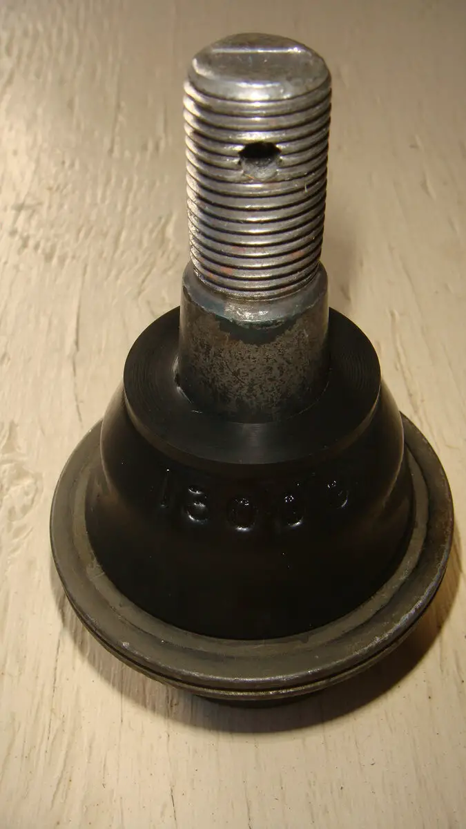

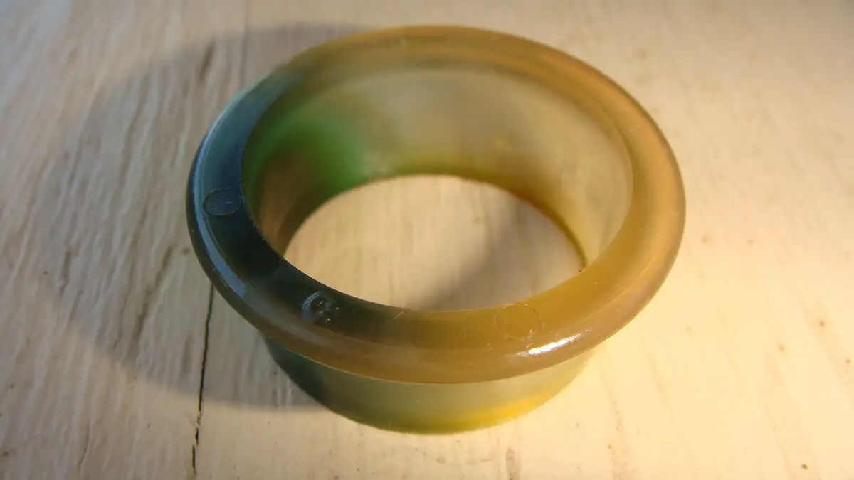

Finally. Thanks so much for your heads up on the ES 9.13130 lower ball joint boots. I've tried MANY other replacements resulting in poor fit and spent too much buying Moog ball joints for just the boots. These ES replacements seem almost custom fit for the older design Moog K8695T that are notorious for fubared boots. Fit around the base and stud is tight and I would be surprised if they leak grease when the front suspension is loaded with the tires on the ground. Not optimistic these will seal for upper ball joint boots though. Appears these boots need to be slightly taller for the Moog K80012 used in the K8708T/80068 one piece and K8710T two piece UCA's. Uppers articulate much more than lowers so they might not seal at the base when the stud is at extreme angles. Still, one win is better than none. I'll keep posted with my results after they're installed and greased. Thanks again.
