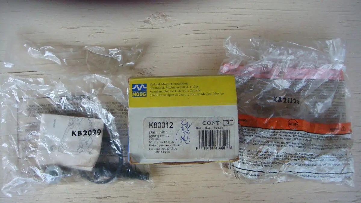

Bought two uppers for only the boots. Parts bags were slightly different, but both have the same number. @C420sailor, were yours the same type bags?
Yes, mine were the ones on the right. Orange stripe on bag.

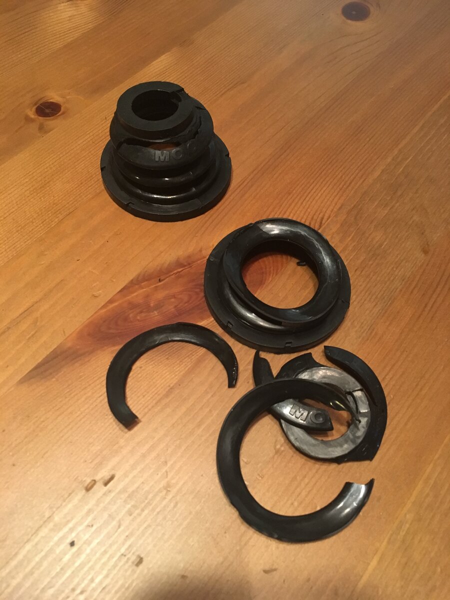

Been using Moog suspension parts for a very long time. Ordered replacement upper ball joints for my Moog arms. On arrival, both boots were torn to shreds in the packaging. I mean one was in 5-7 pieces, and the other one was about torn in half. Thank god I checked the parts before I pulled the old joints. Weird to have TWO identically bad units. Bad batch maybe?
The rubber boot was MUCH thinner than the Moog joint I have in the truck. Maybe they’re pinching pennies and making the boots paper thin?

Who was the retailer? Is it possible that the parts were previously owned or returned?
^ My exact thoughts. Reason I asked in post #4 if the parts bags were sealed and never got an answer. VERY common for unscrupulous weasels to open and switch parts then return them to sellers that don't inspect returned product. Sometimes they are even resealed by heat shrinking. Happened to me with a Motorcraft door lock actuator and a TPS from Amazon. Luckily their return policy is usually fair and they ate the return shipping after my RA's were approved.
Were both Moog's clear plastic parts bags sealed? Bottom boot in pic looks like broken dust boot remnants I removed from a Moog UCA that was only installed for 2-3 years. We all know Moog doesn't offer boots separately, and they usually fail long before the ball joints themselves. Happened to me with a Moog TRE purchased from Amazon and their lenient, but careless return policies. Appeared the previous buyer cleaned their old, broken TRE boot thoroughly and returned it in an opened package after pulling the switcheroo.

Sorry, yes the bags were sealed.
The damaged boots were immaculate. Very clean. I highly doubt they were previously installed but who knows.
