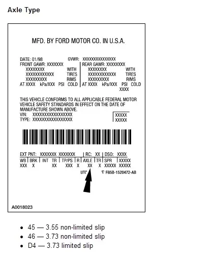

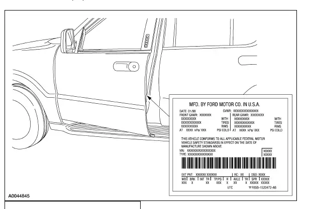

if its not on the door check the rear end there should be a tab on it,yes its in code,the door and rear end.write it down and post it back up here or search for rear end codes
This is the label you want:
And this is the axle code key:
the only thing I seen on the rear end was 642B
its a 3.08open
Well, I searched but was not able to find it on this site. So in case someone else searches for them, I thought I'd post this info here:
Axle Codes
L - Limited Slip Differential
C - Conventional Differential
Code ... Ratio
41 ...... 3.27C
42 ...... 4.10C
43 ...... 3.08C
45 ...... 3.55C
46 ...... 3.73C
D1 ...... 3.27L
D2 ...... 4.10L
D4 ...... 3.73L
D5 ...... 3.55L
