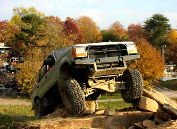

I'm running front springs that are about that weight on my 'Sploder and it is soft - enough to be disconcerting to most others that drive the truck on the street. Of course, I'm also running sans anti-sway bars all around. My truck is "loose" enough to pick up the front end about a foot on take off and if you just drive it into a corner, it will let you know (you can tell by the scratched door handles :D ). I'm used to it and it is no big deal to me, but I know what it will do and what to do about it. I can easily, with one hand, rock my 'Sploder side-to-side about a foot.
It sure does work nice off-road though. A lot of the time, the only way I know that my truck is flexing out from bump stop to bump stop is a low groaning noise that I hear as it works. I'm just driving and drinking a coke, while I'm watching the Jeep dudes bang their heads off of their roll bars on the same obstacle. :p:
Here's another shot of my front end working.
