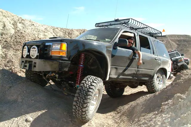

Paul B. has 22" of usable 4wd travel.
Beams widened 3" per side
Swingset steering

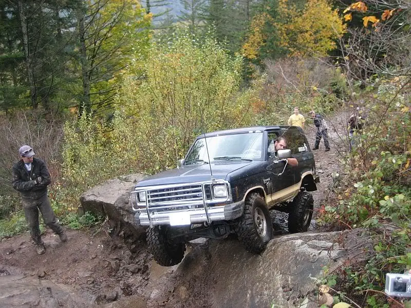

I don't wheel the explorer much, but here is my BII with out of the box tuff country and stock arms:

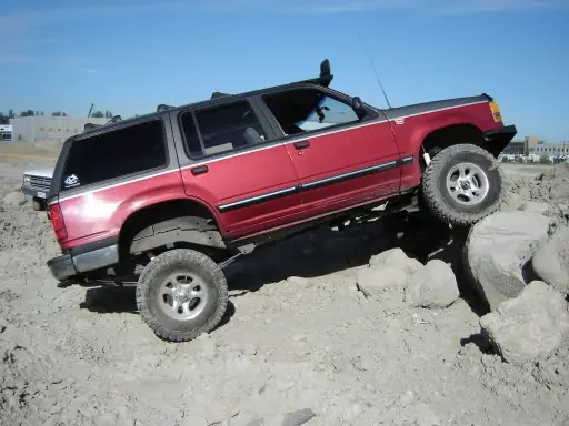

Not my best flex pic, this was taken quite a few years ago just after the Cut & Turn was done, rolling on 33's
That's flexing out the rear axle, not really the TTB :p:

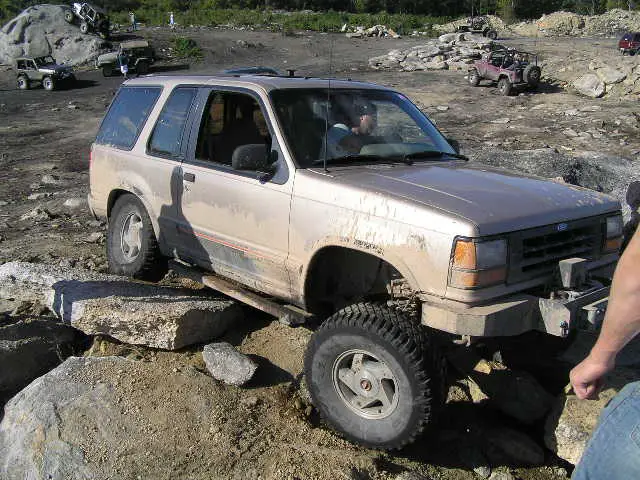

My old '94 with a 5.5 Superlift on it:

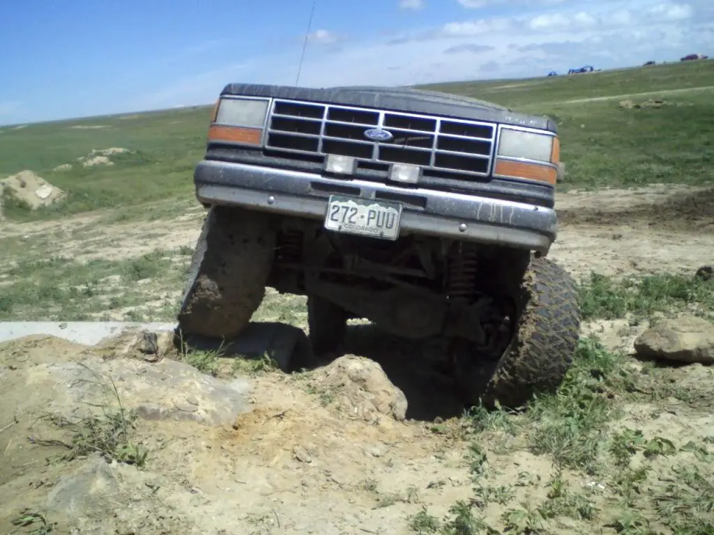

i dont have numbers but heres a few pictures
picture.php
picture.php
picture.php
