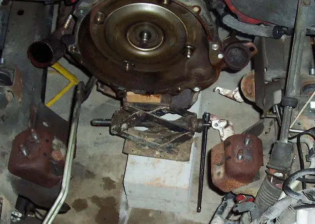

Any ideas how to get the motor mounts out?
The top bolts are OK, but how do you get the lower one. It is on top of the differential on the drivers side. I can't even see it.

Those 2 bolts are the top side of the mount which attach to the metal plate which attaches to the motor. To remove the actual rubber mount, there is a bolt below. On the 2wd like streetrod, it seems you can get to the bottom nut. On the 4wd like mine, it is above the differential and I see no way to remove it. I think I will leave sleeping dogs lie and forget about changing them. I was just doing it because the truck is old and the motor is out.
If anyone knows an easy way, well maybe I'll give it a shot, otherwise, I'll return the new ones to napa.

On second look, is that the bottom side? Is it a 2wd?
One of the pics is the bottom on a 2wd Explorer...
That bottom nut and the rusty pin is very similar to my 2wd Explorer setup of the bottom of the frame that holds the engine mount...Minus the rusty pin...
I wish I knew of a way to get the bottom nut off and replace your mount...I can't say I ever saw that area on the bottom side of a 4wd Explorer though...

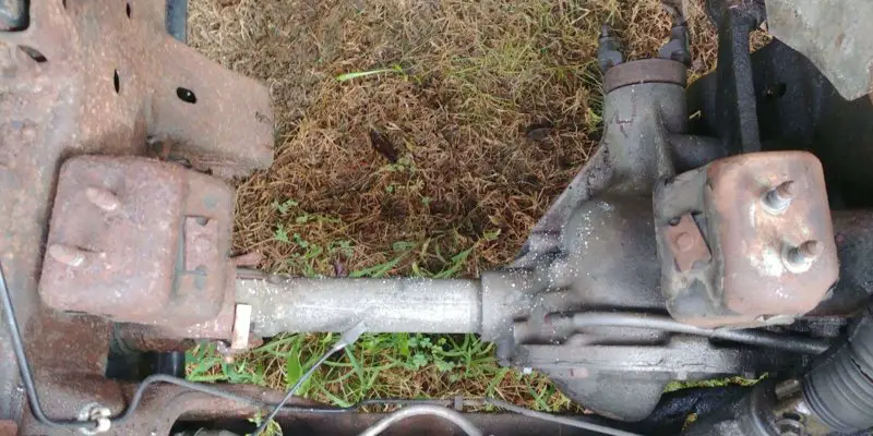

The only way to access the bolts for the motor mount to frame is to drop the front axle out of the truck. I am doing my mount with the motor in the truck. Because of that I will be removing the front axle. With 187,000 mile it needs cleaning anyways. I will post some pics next weekend when the mayhem begins.
The photo on top is of a 2000 Explorer Limited V8 engine mounts and the photo below that is of a 2002 Sport 4.0 SOHC engine mounts
They are different. So if you are planning a swap you will need the V8 mounts.
The differential does not need to be removed. There are several (3?) bolts that hold the axle to the frame. If you remove those bolts, the differential and entire center section of the axle can drop down several inches. At that point, you can access the bolts holding down the motor mounts (it's still tight, but definitely possible at that point).
