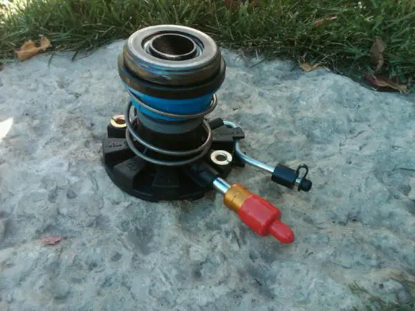

Alas, not just was my master cylinder bad (changed that 2 months ago, O'Reliey's, thus far, makes a very good master cylinder, it was fairly easy to bench bleed fully too)., but my slave has been leaking from the seals while cold and it's time to replace it. Looks just like the picture a couple pages up, I think it's a Napa part.

Initially I was to save for the motorcraft slave, which I'm expecting is going to cost me about $90-200, but being as urgent as this is getting, I'm considering other options. The one in it now, that has been leaking after 20,000 miles, is EXACTLY the slave pictured above (no bellows, loose spring, big blue throwout bearing assembly). I think that's a NAPA part, which I Will be avoiding. O'Reliey's has a $49.00 slave cylinder with a metal black part on it where the input and bleeder lines come out, and a blue plastic throwout bearing end on it, and it has rubber bellows over the sides. It also has the perfection clutch attachment system on it (c-clip-ish thing instead of pushing in the white ring).

1.) How good are the slave's At O'REiley's and/or Perfection Clutch? The O'Reiley's looks like the one Perfection Clutch sells (metal baseplate with the custom quick-connect system on it, bellows, and a blue end on it), but I'm not sure Perfection Clutch would really sell through O'Reley Auto Parts though. Any experience with this version?
Here's a picture I added, which came from the Perfection Clutch website, the O'Reley's cylinder looks just like that.
Have you checked the part # on the O'Reilly's slave cylinder? The "different" attachment system looks like the ones on larger Broncos/F150's or something other than an Explorer. I've yet to see/hear of anyone fit a slave cylinder made for another model in an M5OD-equipped Explorer, and without using the matching master and line it might not be a safe thing to do.
No idea how good they are, but if they were better than the Motorcraft part, there would be someone on here telling us about it. Hasn't happened yet.
The black bellows is just a cover for the spring, and the new, updated Motorcraft part (now listed for 1998+ Explorers, but it's what you get when asking for one for a 93-97 unless that dealer has a old stock original part still sitting around) has the same cover, it doesn't really do anything.

I wouldn't chance using a parts store replacement. There's the issue I've seen time and time again. 20 x.. miles and the slave leaks.
I put 32-33k miles on my factory replacement. No leaks no fuss.
I know it's expensive to buy up front but I feel it's worth not having to do multiple times and seeing as it isn't easy to get to, that makes me willing to pony up the extra dollars for peace of mind.
