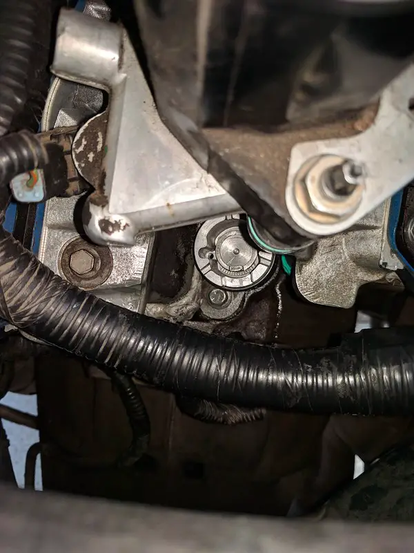

In case this tip gets missed when researching the cam synchro
Unbolt the two 18mm nuts that hold your transmission mount to the crossmember
Put a jack under the transfer case or trans tailhousing and jack it up until the trans starts to hit the floor
Also remove the PCM wiring harness from the firewall, undo the 10mm nut and the 11mm ground wires, now you can relocate the wiring harness out of your way.
Good tip to remove the hood, sure can help
raising the back of the trans will gain you MUCH room on the back of the engine to work
