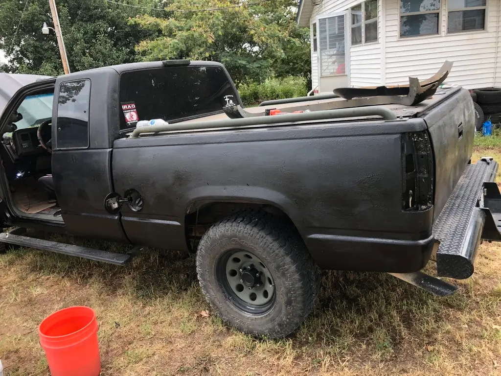

Finished the bed in bedliner:

FYI two gallons of Monstaliner with all the things needed to roll it on runs about $350, with the $$$ you put into Rustoleum or Duplicolor or whatever you can have Monstaliner
heck yeah the little dude is a helper!
I'm loving this truck and thread, thanks for sharing :)
Yeah little man LOVES to be outside, I figure I will have him turning wrenches before long.
I hadn’t heard of monstaliner before, thanks for the tip. If I calculate all the liner material I bought, I might have $300- $350. I probably have two cans in the bed. The can in the picture wasn’t empty, so there’s still some left. I have brushed it all over my truck several times, over the years. The bottom is gloss black spray paint, and the grey is charcoal grey gloss rustoleum spray paint.

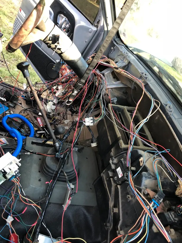

I got a little bit more done on Monday 3/18, I finally sorted out a parking light/ turn signal malfunction. I was getting power on the socket, but nothing on the turn signal side. Long story short, as this issue has plagued me for several months where weather and family activities have hindered progress, it was the junction point where they all tied together because it had corroded.
I love how simple it was to repair, the signal indicator was lit up on the dash as a clue but because i was getting power to the socket, I was thinking it was in something I had done when I wired up my dash swap.
I am really looking forward to driving this truck again, I haven't driven it since I started my dash project only a few little things to go and it will be done.
Update:
I drove it and forgot about how much fun it was to drive. Then, I noticed I had a couple issues: 1) a battery drain, so I fixed that with a cutoff switch. 2) another left side sidemarker light issue, so I sourced another light harness from a truck that doesn’t have them built into the wiring harness, known as the work truck package with the 5x7 single headlights.
