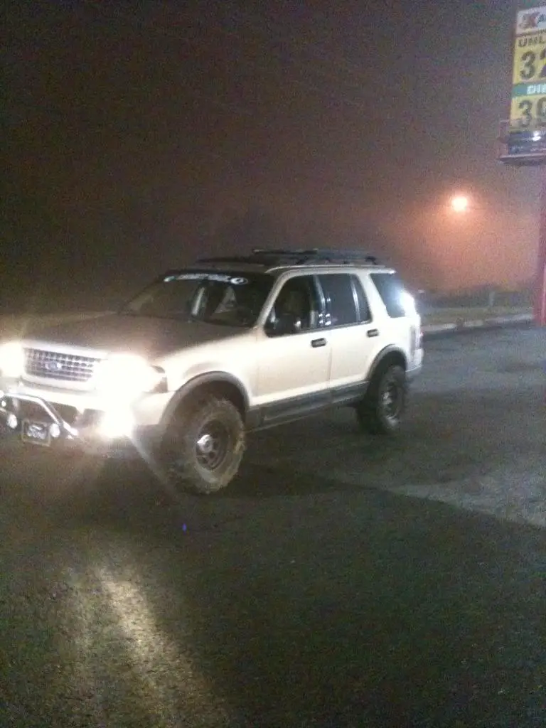

my 03 xlt on 31x13.50x15 check it out tell me whatcha think | Ford Explorer Forums
Looks good! :biggthump

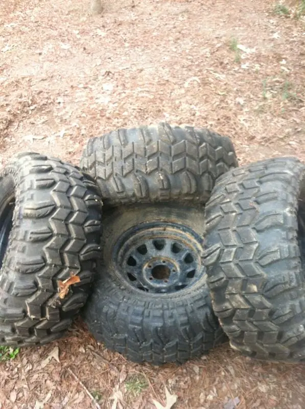

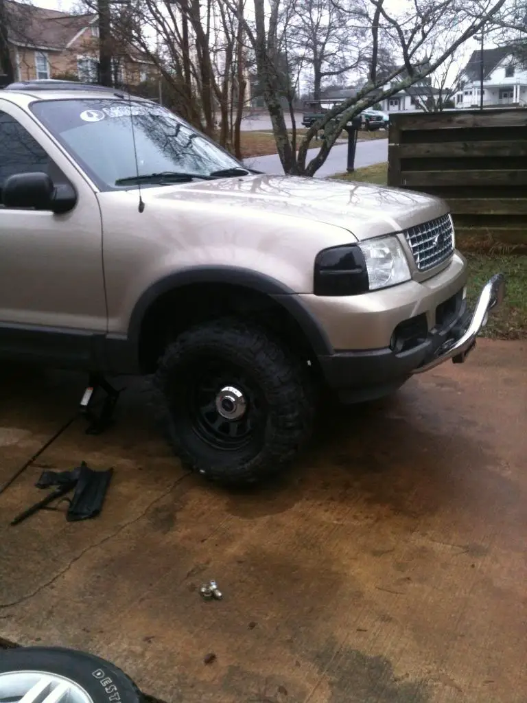

I know you answered this in another thread, but it may be worth adding to this one if anyone searches it out. Please let the others know how you put 15" wheels on a 3rd Gen. I believe you said you had to use a spacer and/or trim a little bit of the caliper or knuckle? Just so that if someone wants 15's on their 3rd Gen they know they won't bolt up without a little modification...
It looks really good by the way :thumbsup:
How to fit 15s on a 3rd gen
It's very simple go to your local parts store and get some 5/16 wheels spacers that fixes the rear right up but the front u have barely shave the corners the caliper bracket won't hurt anything so if u want fifteens get um lol
The cheap spacers at the auto parts stores aren't hub centric if I remember correctly?
True lol I have some hub centric ones ordered I just wanted to make sure the 5/16 spacer would do the trick now I gotta get balances and aligned so yea 5/16 works order hub centric ones lol sry bout that folks

Well I went and got my tires balanced didn't help the wobble at all so any other ideas? Still gotta get my hub centric wheel spacers and replace my ball joints think this will fix my problem??
Yeah the hubcentric spacers should do the trick. Even though your tires are balanced your wheels are probably seated against the hub unevenly.
Sweet man thx I hope that fixes me up lol ill let y'all know ASAP
If your tires are bias ply, normal balancing may not work which could be your wobble. If so, there are a few tricks like a certain amount of BBs (Airsoft) that will work.
Ok man if the ball joints and the hubcentric spacers don't work I guess that'll be my next step lol thx
