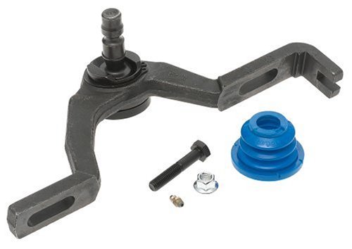

I replaced the passenger upper ball joint because it had a torn boot. The passenger side lower is brand new.
Moog makes really good front end parts, some which are even better than OEM.
The part number was CK8710T. It is really half the upper control arm and this design even has a replaceable ball joint in the end of it.
It was the most expensive one listed for the passenger side that was still only half the control arm. I did not want to go with the one piece unit.
If I looked it up correctly the replacement ball joint part number is Moog K8738 (for just the removable ball joint)

The way the upper control arm was designed on these Rangers (and Explorers), you have to replace the whole upper control arm to replace the ball joint.
Moog makes a replacement upper control arm with removable ball joint.
This is what I went with on the drivers side.
This upper balljoint has a grease boot with it.
