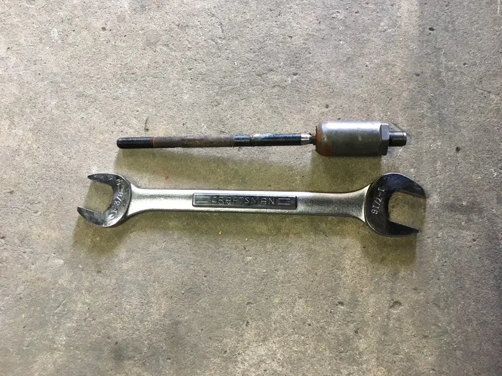

The passenger side inner tie rod had some play in it so I replaced it today.
Used a moog part of course.
This big wrench I bought for cooling fans works great for tie rod ends too.

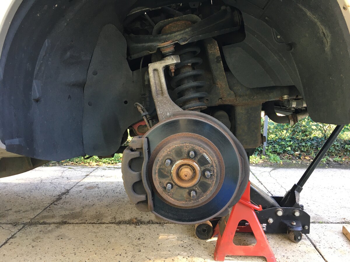

I finally got around to upgrading my front brake system with the Aviator front spindles, calipers, and brake pads.
Bought new rotors and pads from Advance Auto for around $163.00
I really trashed the last brakes and rotors I had on there and needed them anyway, had bad brake fade and warped the rotors.
Before:
After:
Spindle comparison. Lincoln Aviator on left, Explorer on right.
