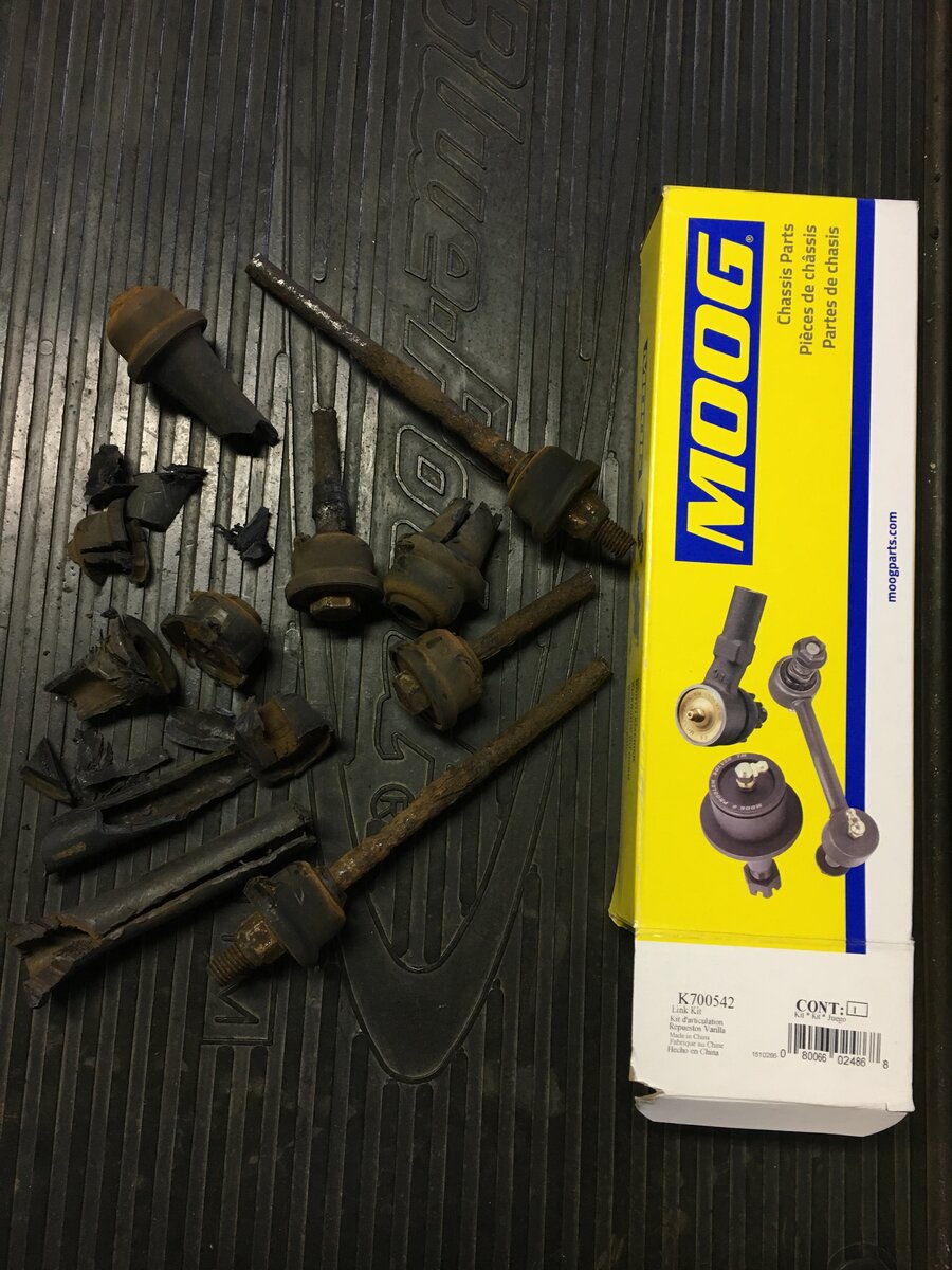

Today (11-22-2020) I installed anti sway bar end links.
The old ones were cracked. The new ones have metal sleeves so I hope they last longer.
Moog parts of course, I have used Moog stuff for years and the quality is usually top notch.
Here is one of the cracked old ones.
The old ones came out in pieces!

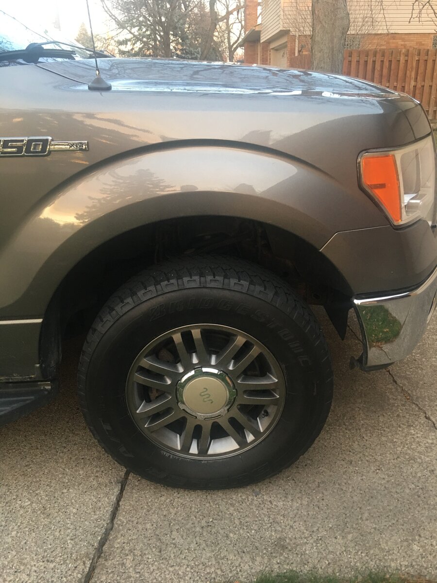

The 20” Sport Trac wheels work really well on 3rd gens. No spacers required. I’m running 255-55-20 tires on them.

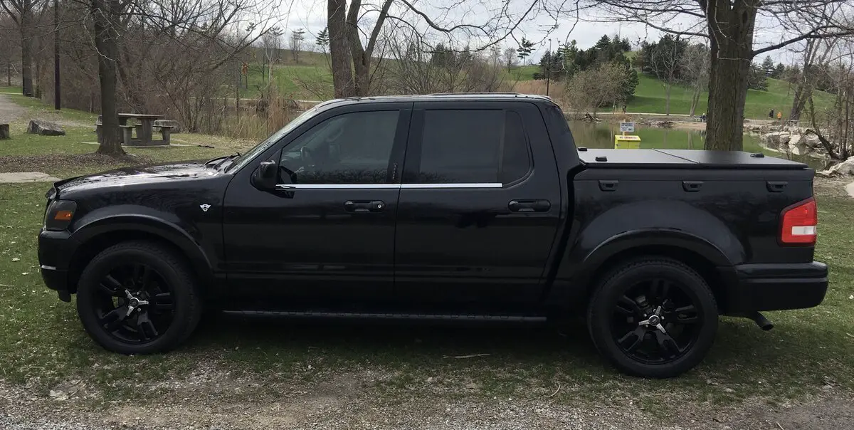

I love the look of the Sport Trac Wheels. Where did you get them and how much were they?
Is your suspension modified in any way, lowered etc?

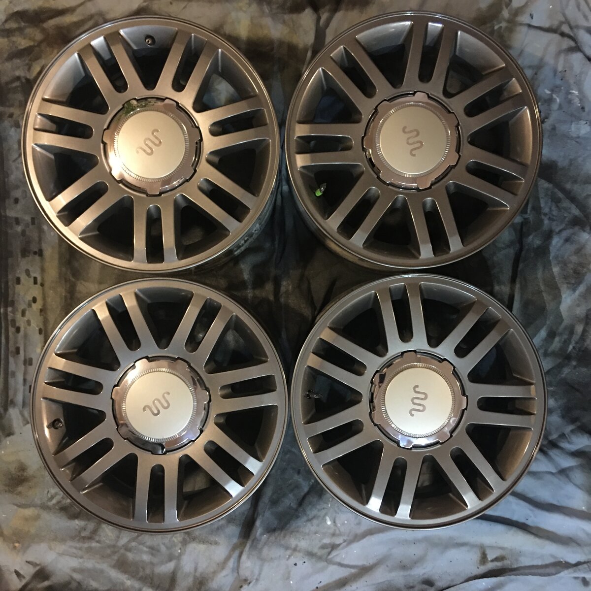

I bought them used with tires that had about a year of use left on them. I paid around $450 CDN for them. Most sets (at least in northern climates) have an issue with corrosion and clear coat lifting. This set had already been sanded down and repainted. When I put replacement tires on, I sanded them down again and resprayed them. I use Dupli-Color wheel paint and clear coat. I also did a set in black for my Sport Trac. They were pretty rough originally and had junk tires. I paid about $250 CDN for them. Both vehicles are stock height and I don’t use spacers. 255-55-20 tires on both sets, putting them at about 31” tall. Second pic shows a sanded down wheel beside a newly painted black one. So yes, I do have two sets.

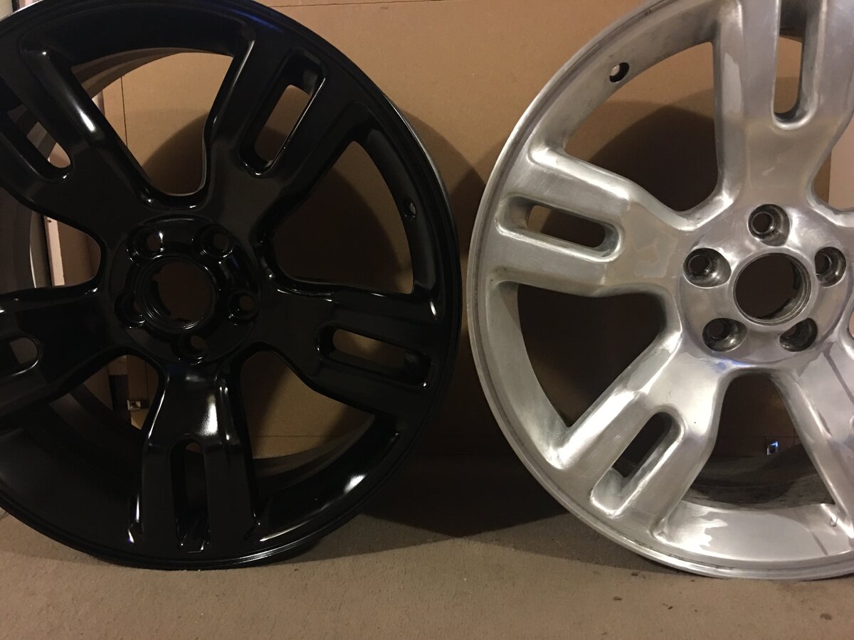

I would pay 250 to 450 US dollars for a set if I could find them in good condition. Totally worth it.
I don't know if black or gray would look better on my silver truck.
You lucked out finding two sets for sure, and thanks for telling me the fit without spacers as I don't feel comfortable using spacers.
I wonder what the best way to word the search for these wheels would be, Sport Trac wheels?

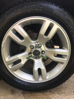

I'd add Adrenalin and 20s or 20" to your search. As you know, they were also available on some late 4th gen Explorers, but weren't very common. I don't see them for sale often. Abut the only ones you see for sale will need refinishing. Just for reference, my silver set is Dupli Color "Hyper Silver" with a gloss clearcoat. That might look god on yours. They've also go a nice charcoal color. I just did a set of F150 wheels in charcoal. I'll see if I can dig up some pics of them.
This is the Dupli Color charcoal with clear coat. I just did these ones.
Wow they turned out nice, I like that charcoal color.
