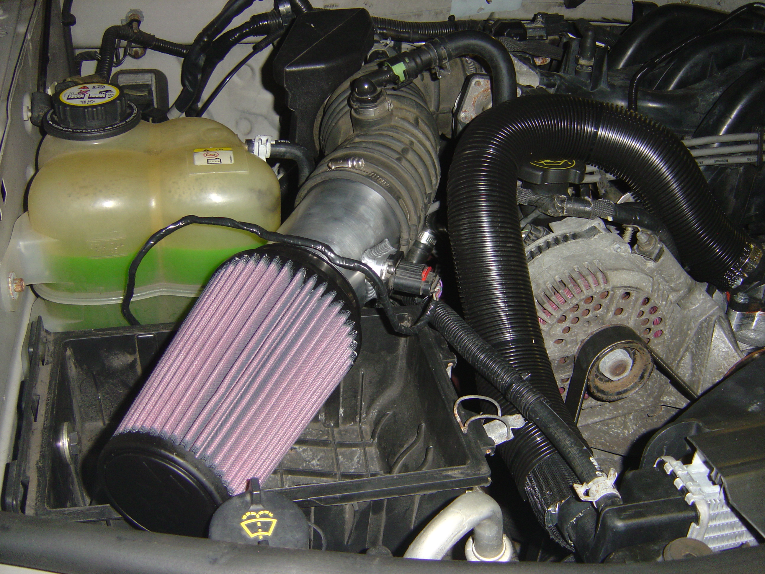

Effects of larger MAF housing

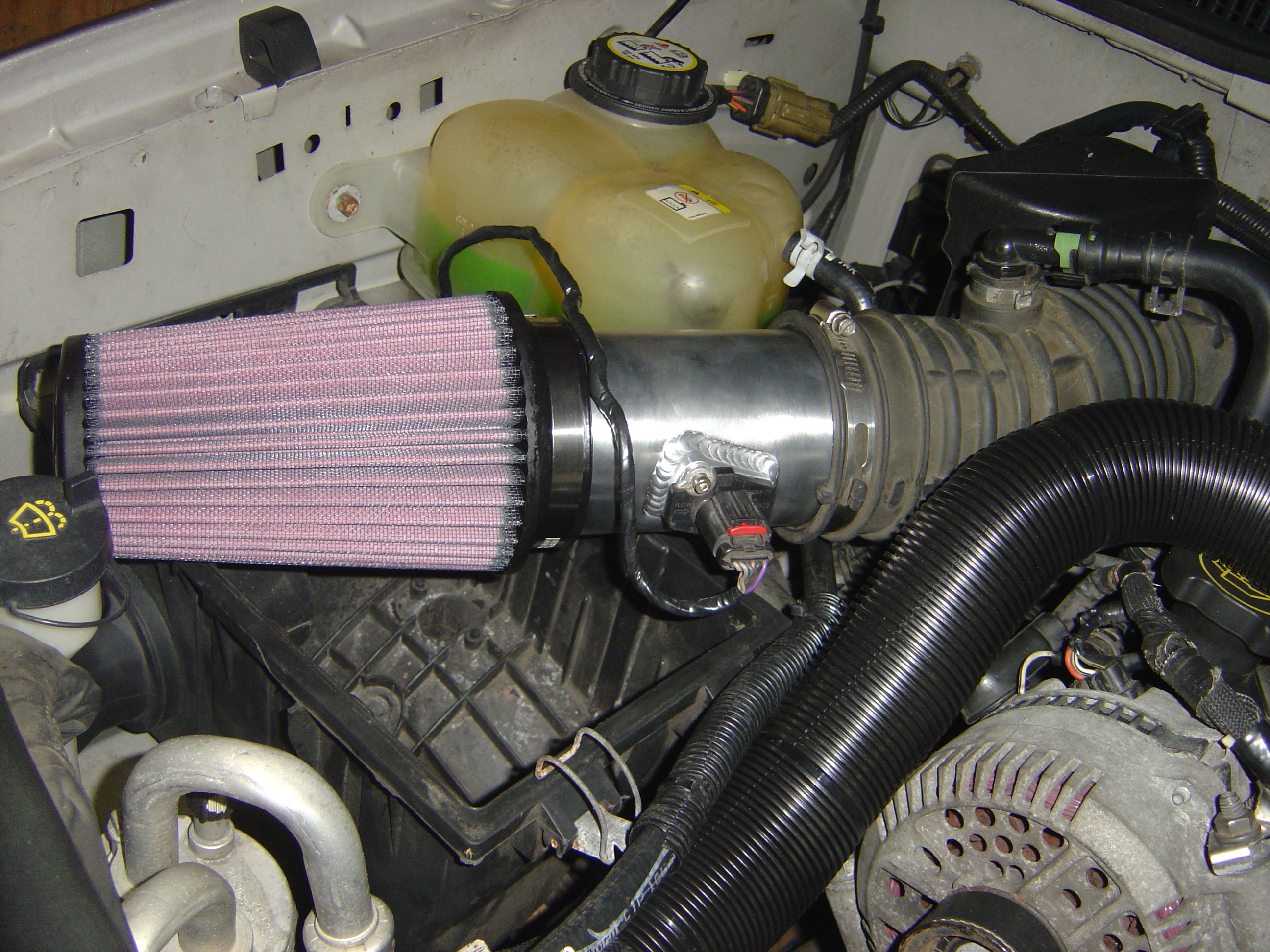

I wanted to see the effects of a larger MAF housing with the stock slot style MAF sensor.
The MAF tube inside diameter of my stock 4.0 sohc air filter box top was 2.5 inch.(the 4.6L has a larger inside diameter)
Picked up an aluminum 3.5 inch maf tube, it fits right on the end of the stock intake tube of my 2004 Explorer. (funny how inside the air filter box top it is down to 2.5 inches)
With the stock MAF setup it hit 986 counts, and with the 3.5 inch it hit about 820. Only gives a little room before it would peg the MAF.
Guess I will try a few different sensors next. The stock sensor is a Motorcraft AFLS-131, I would like to try a ALFS-132 and ALFS-133.

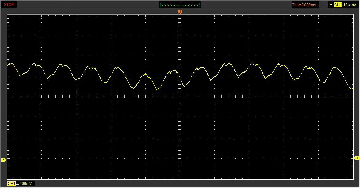

Fuel Pump Current Ramp

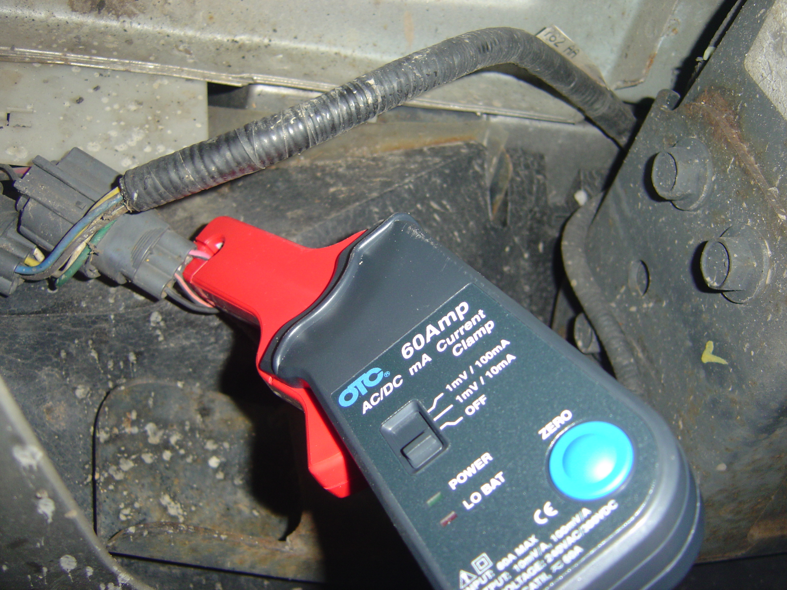

I wanted to test the stock fuel pump and see what the current ramp looked like before replacing the fuel pump.
Since I had this cheap 8 channel usb lab scope made by Hantek, I figured I would try it out.
I did a test on my 1998 supercharged truck first, it is a return system that just keeps the pump on all the time.
To test it I just removed the fuel pump relay, put a jumper wire in and put the amps probe around the jumper wire. Nice and easy.

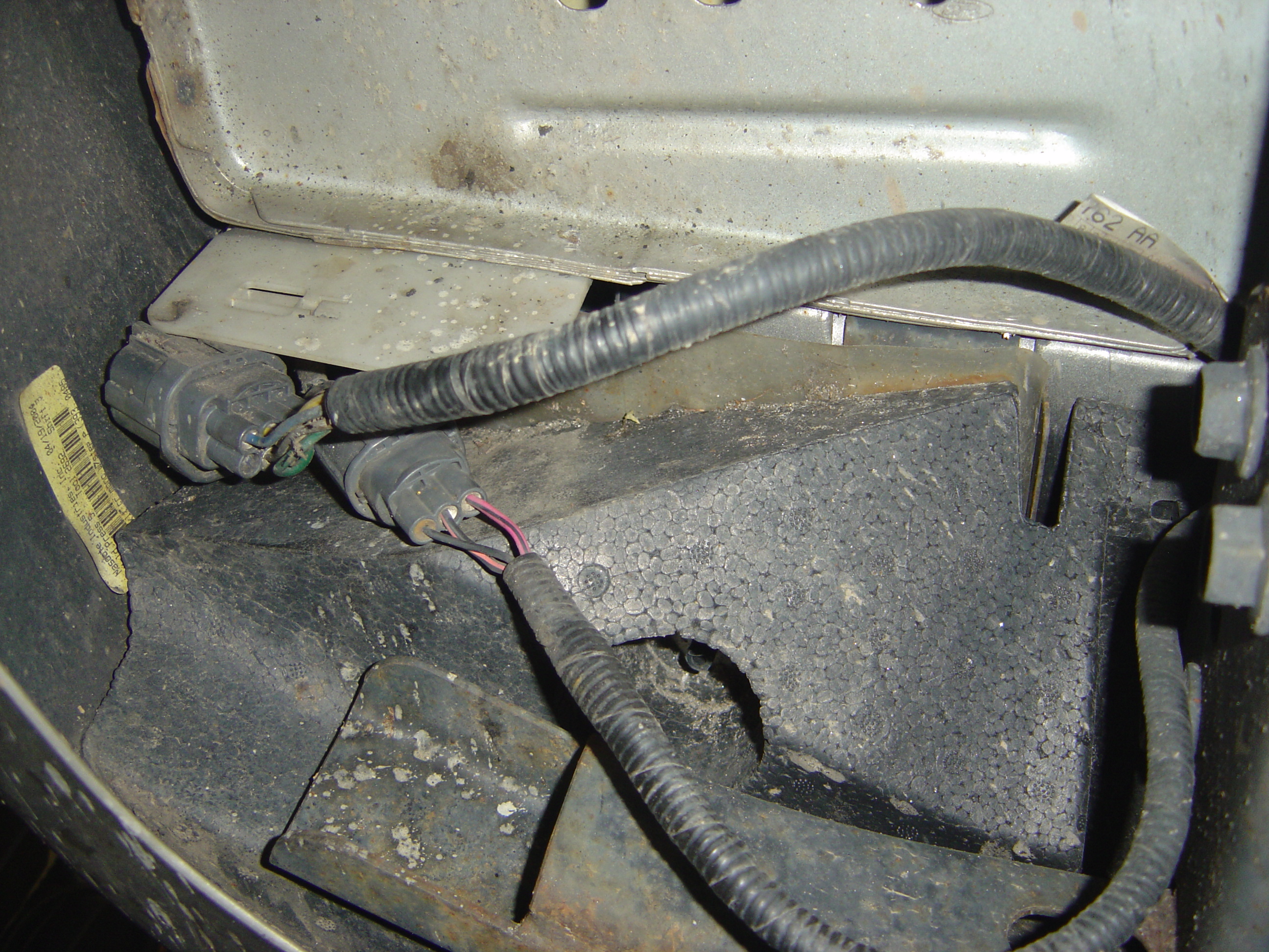

Next task was to find the fuel pump wires on my 2004. It has an electronic returnless fuel system that is pulse width modulated so going to the relay won't work.
I found the wires under the truck at the back on the passenger side, I decided to go on the pink/black stripe wire with the inductive amps clamp(set to 1mv=10ma)
These lab scope pictures will be for future comparisons.

Two MAFS same results
So I tried two different mafs in the 3.5 inch housing and they seemed exactly the same. Both hit about 820 maf counts.
The MAFs were the ALFS-131(2004 Explorer 3L3A-12B579-BA) and the ALFS-133(GT500 4G7V-12B579-AA)
Was not expecting the same results, this makes me wonder why they have two different part numbers.

when changing the MAF sensor pipe diameter you have to adjust other settings for the large difference in cross sectional area of the pipe.
This guy Turbo'd a 90s 4.6 mustang. Did a lot of cool custom work. This vid is about his MAF experiments.
Neat video's, I have 4 inch sewer pipe on my 1998 supercharged Explorer. Works great.
When changing to different size maf housings you have to change the maf transfer function. Like him I used a ratio to calculate the transfer function.
The new 3.5 inch divided by the old 2.5 gave me 1.40 and I multiplied that to the whole transfer function, it was close but I did another .08 and it got even better.
Good enough for WOT testing anyway. When all finished I put the stock air box back on, until a later date.
ah ok.
Well area is (3.14)*(radius)^2
Sooooo
@ 2.5" = 4.91 square inches
@ 3.5" = 9.62 square inches
9.62/4.91 = 1.9585
also (3.5/2)^2 / (2.5/2)^2 = 1.9585
I some how always use the wrong formula.lol.
I was using diameter instead of area.
Maybe next weekend I can try to multiply the maf transfer function by 1.95 and retest.
