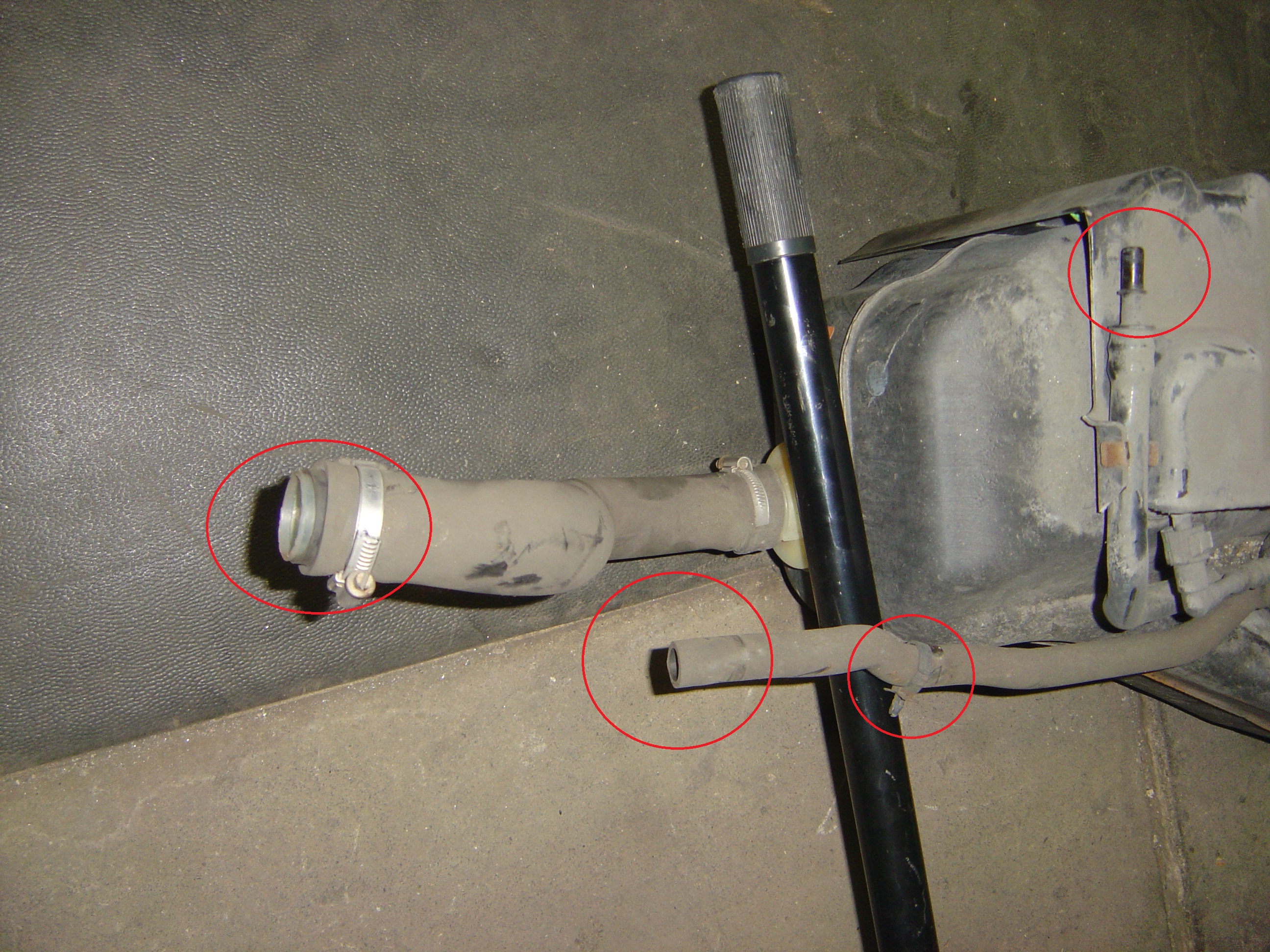

Or maybe less since the 3.5 inch is really outside diameter. lol Whoops!
Got to measure the inside diameter of that tube now.
At least now I will remember to use the area instead of the diameter, did I tell you I was blonde when I had more hair.

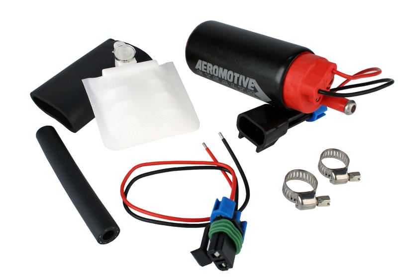

Aeromotive Stealth Electric Fuel Pump 11541 in a 2004 Explorer
I finally got around to installing this fuel pump, the electrical connector was an exact fit so no cutting or soldering any wires. The stock fuel pump assembly needed some customizing to accommodate the new pump motor. A little plastic removed and then some rubber of the top insulator and it fit into the old stock assembly. All I used from the picture above was the pump itself. The stock pump filter fit on the bottom of the new pump.
Being a 2004 Explorer, there are two different fuel pump assemblies. One is an early build and the other a late build. The early build just has a pigtail coming off the top of the fuel pump/sending unit assembly. The late build has a connector on top of the fuel pump/sending unit assembly. I have the late build.

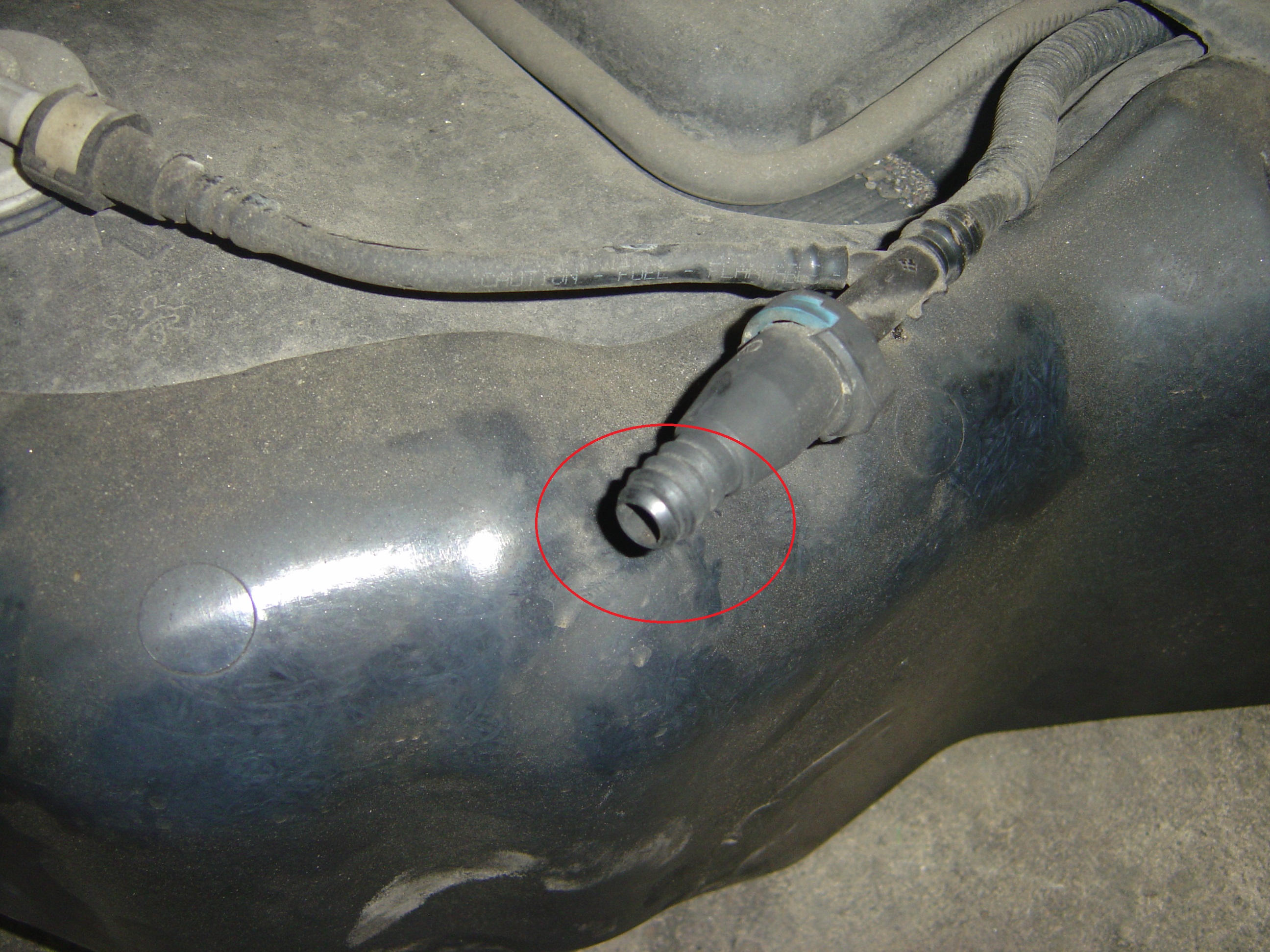

I like the torpedo shaped charcoal canister for the evap system, sure different from the old square ones from days of old.

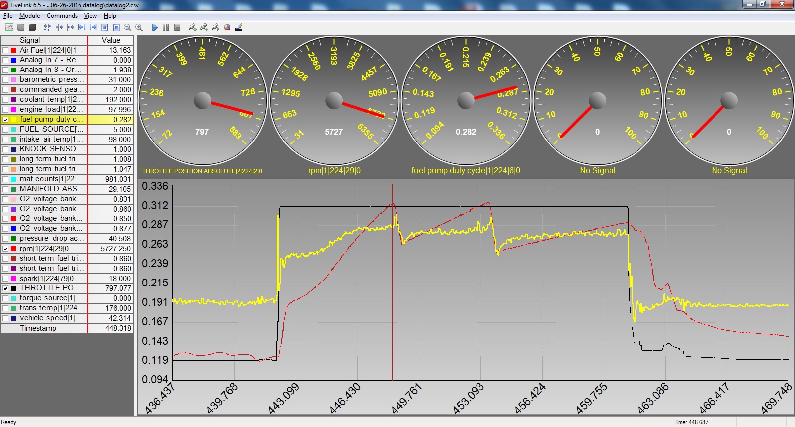

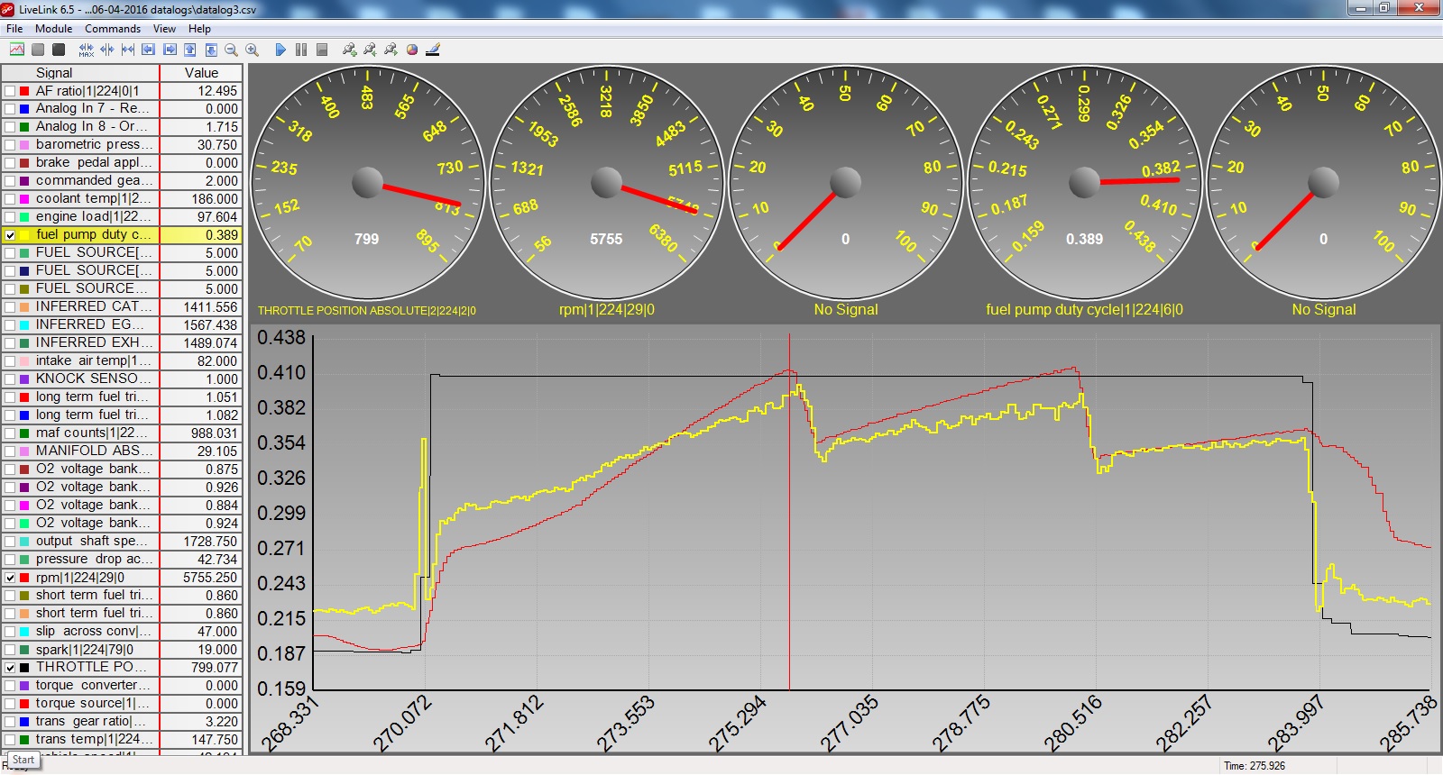

Fuel Pump Duty Cycle on 2004 Explorer with Aeromotive 340 Fuel Pump
Here are two datalogs, one before and one after installing the Aeromotive fuel pump.
The duty cycle hit aprox 38% at WOT with the old pump, and 28% with the new one.

That quantum looks like a nice fuel pump, I wonder if it is a turbine style?
Why are you using the 91-94 plastic, is it for ethanol fuels?
Why two pumps, for huge horse power numbers/ethanol?
The 340 I got is a turbine style which is needed for pulse width modulated systems which my 2004 has.
As fuel pressure goes up most fuel pumps flow ratings drop. The Aeromotive 340 still flows around 250lph at 60 psi which would be needed if this truck ever sees 20 lbs of boost. I wasn't planning on that, but you know I never planned hitting 20 on my 1998 either.

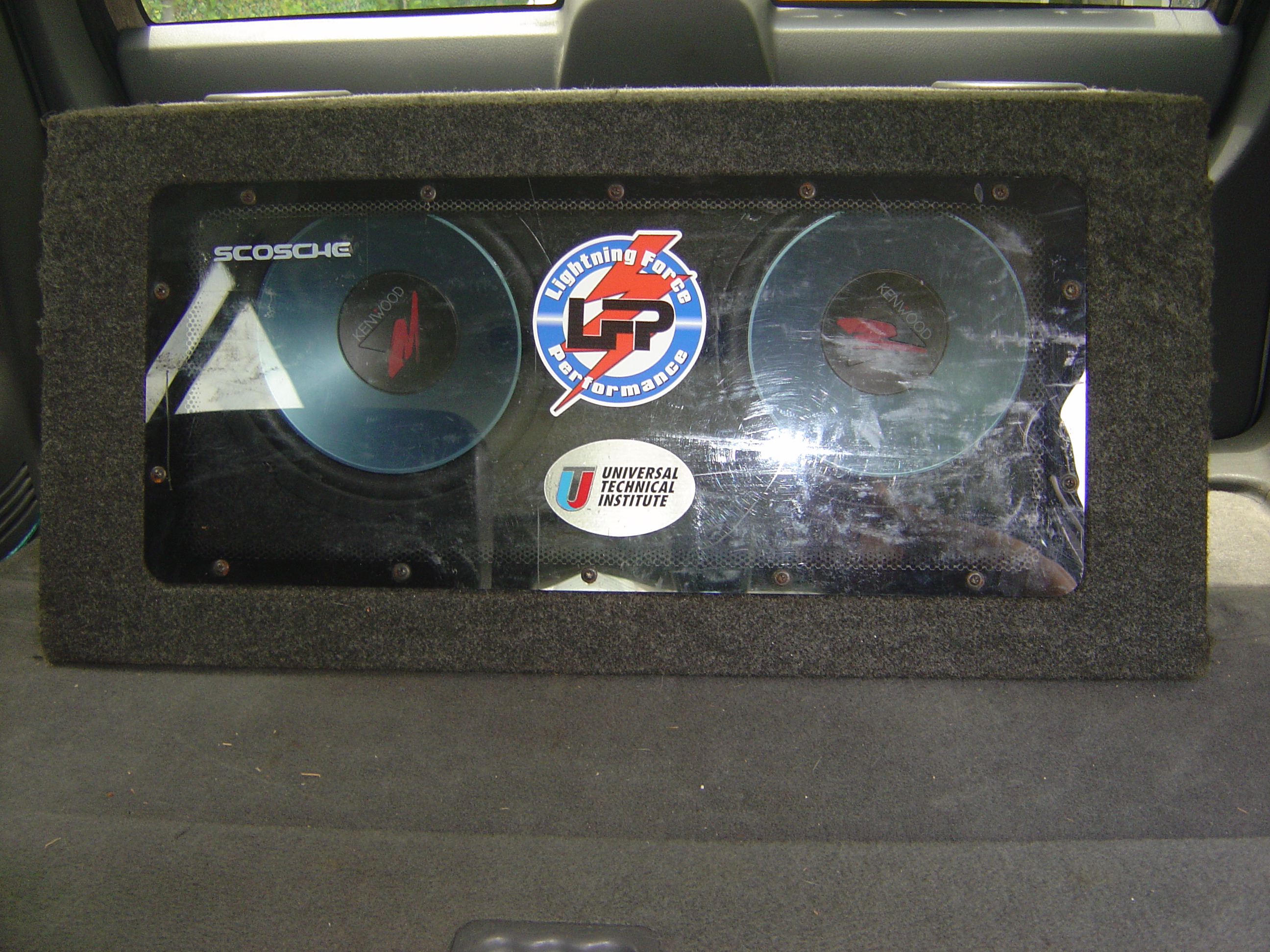

New old speakers
I decided to put this sub box in my 2004 Explorer.
I had it in my 1998 for a while but lately it has been sitting in the house collecting dust.
Definitely kicks way louder than the single 12 I had in there.

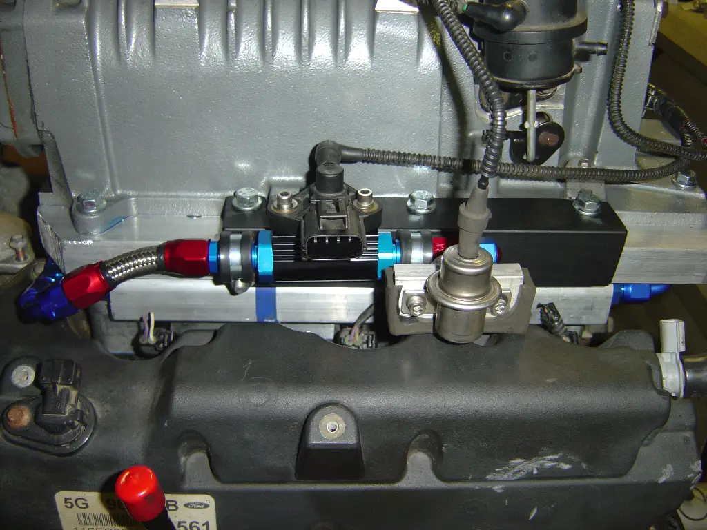

Cobra Supercharger on 2004 Explorer

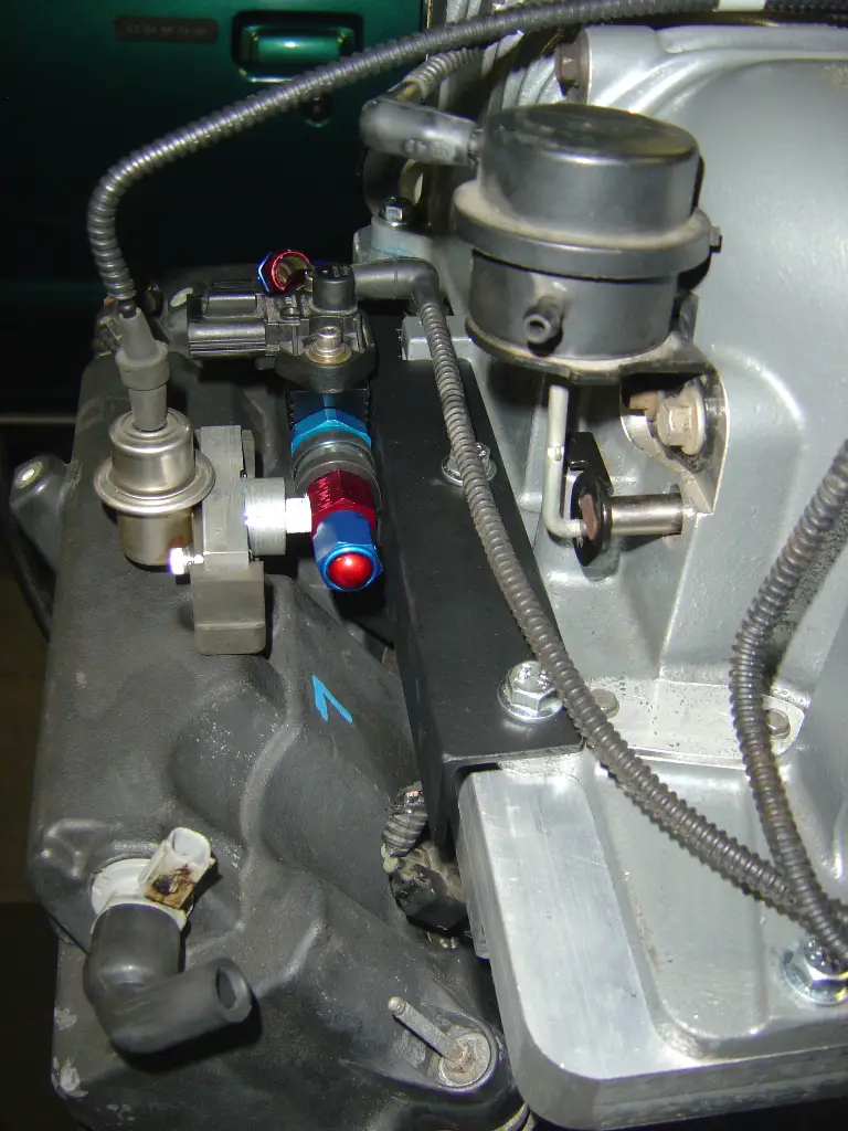

Test fitting some vacuum and fuel lines on an engine that is sitting on an engine stand in my garage.
I found these adaptors from Aeromotive that allow you to attach a Ford Fuel Rail Pressure Sensor to fuel lines with AN fittings.
The adaptor part number for my 2004 is Aeromotive 15115.

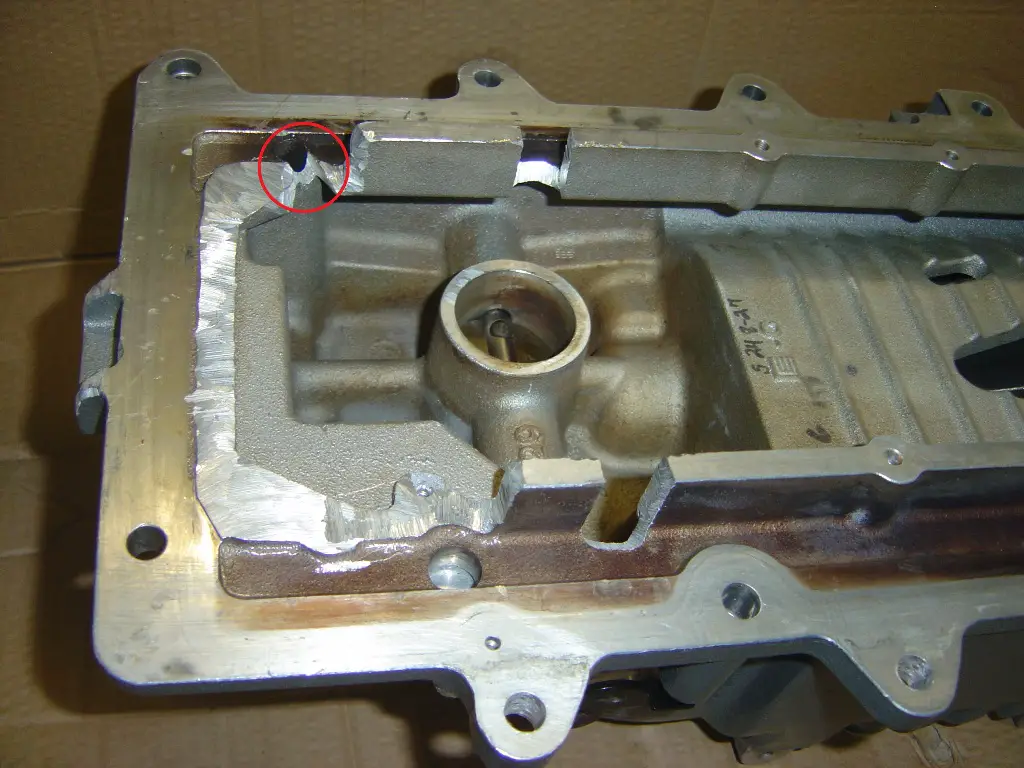

Dono, I don't think you have a sensor on your fuel rail from the factory. The sensor I have is for an electronic returnless fuel system since this truck is a 2004 with that fuel system. I believe you have a return system with a fuel pressure regulator. (correct me if I am wrong).
The Cobra Supercharger is a M112. Same supercharger as Tim has on his Explorer. It should be good for 14 lbs on my truck with a 2.7 inch pulley.
I will be starting with a 3.3 inch to see how low the boost could be, and learn more about tuning drive by wire first.

Yes, I have a return (edit...returnless) style fuel system with the sensor on my fuel rail. I don't want to loose that sensor by going aftermarket rail.

i think yours is returnless don if i am not wrong. you only have one fuel line at the frame if i am not wrong.

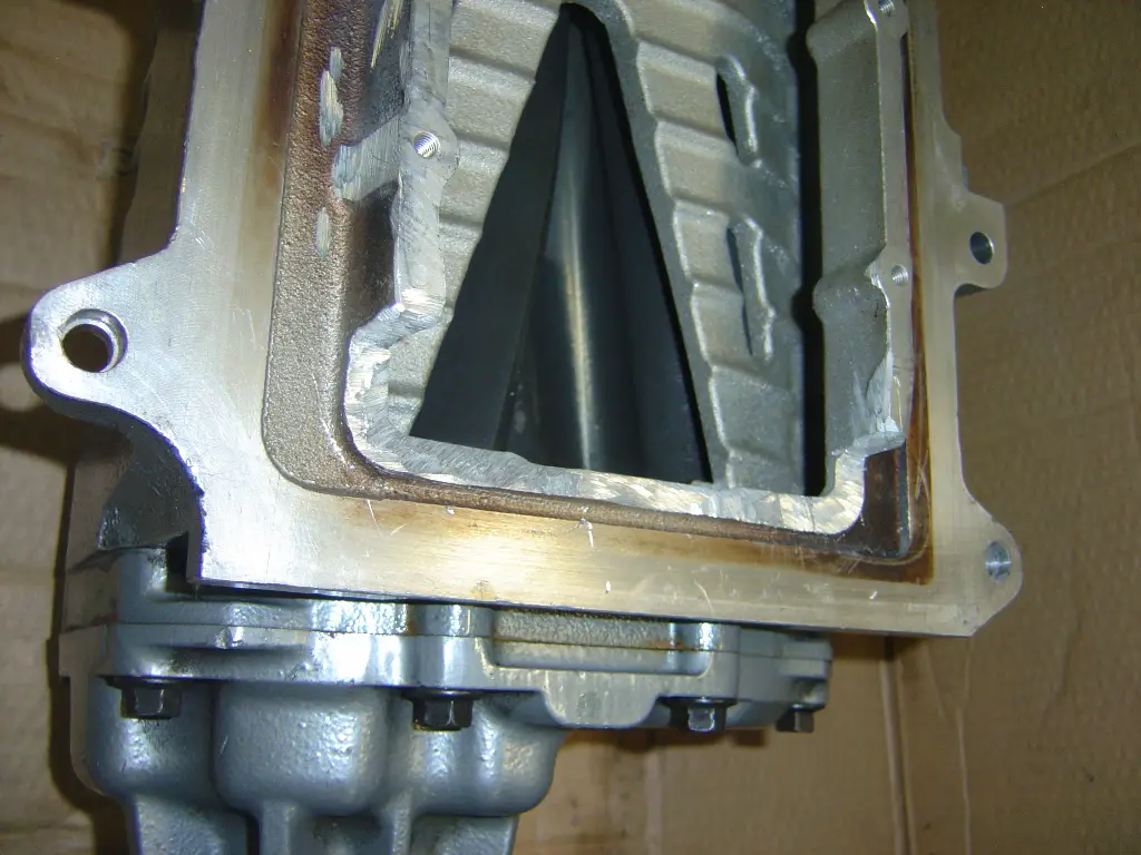

I plan to intercool this one, I wont be using the stock intercooler though and I had to "remove" some of the lip off the bottom. I have no one to mill for me close by, and I don't have the equipment to mill (but sure would like to). I used some pretty crude methods to remove what I needed, Sawzaw, hammer, grinder. LOL. I should remove the rest of it but it was very time consuming doing it the way I did.john are you innercooling this one to, or did you mill the lip off the bottom like i had to?

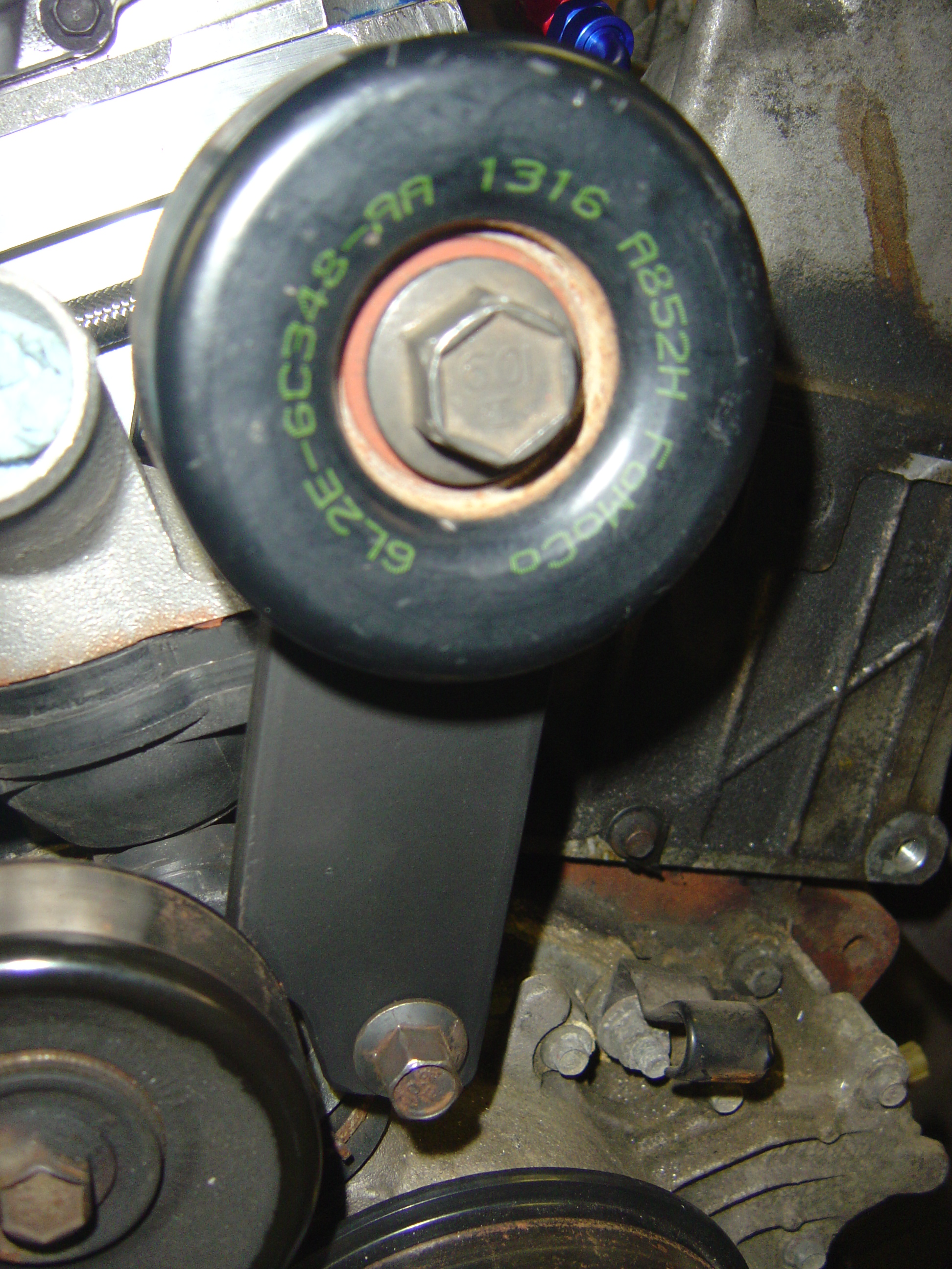

I made an idler pulley bracket just like the one on my 1998 explorer, this will give me enough wrap around the supercharger pulley.
By the way this is on a used engine on a stand in my garage, just for test fitting.

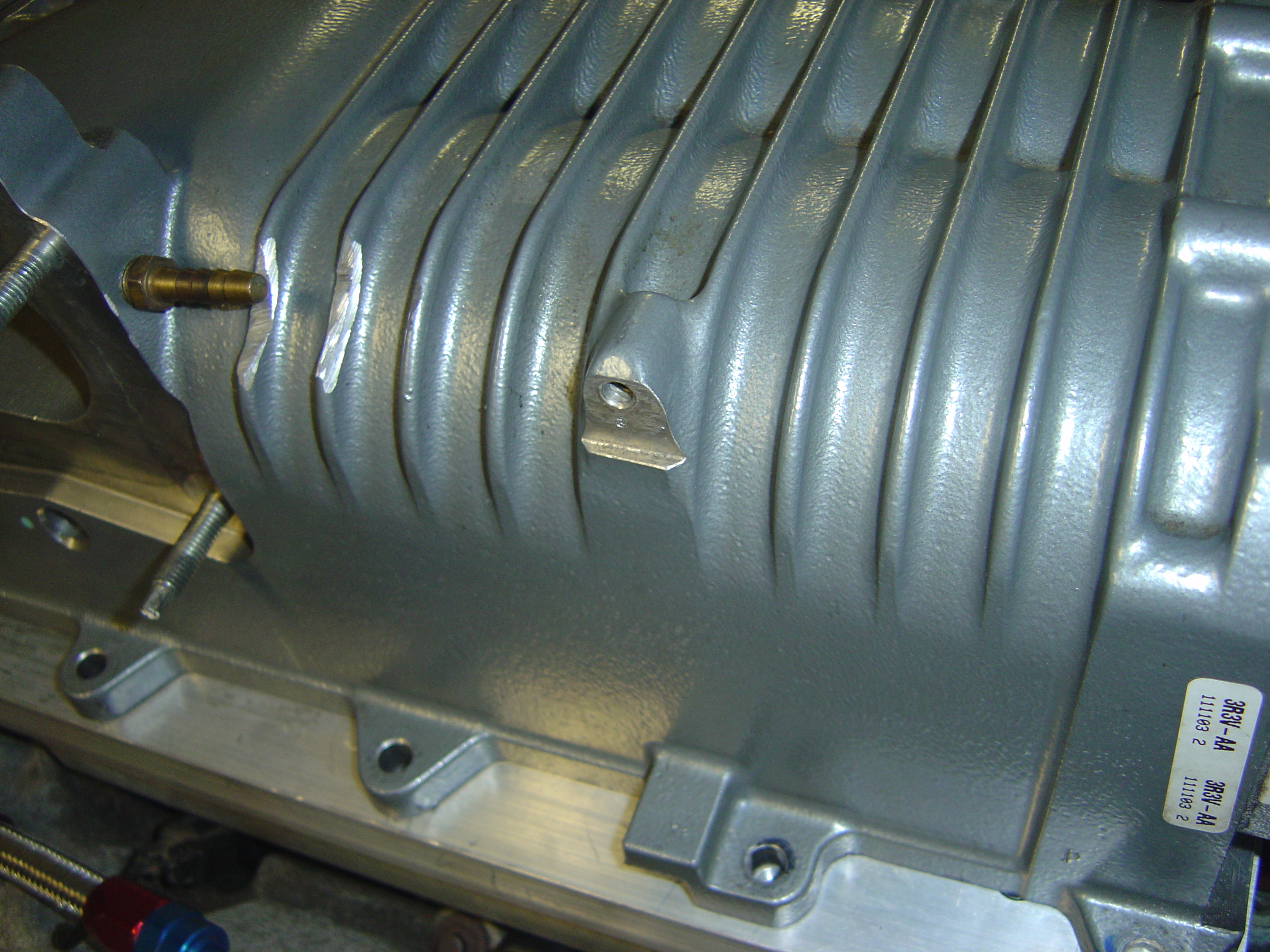

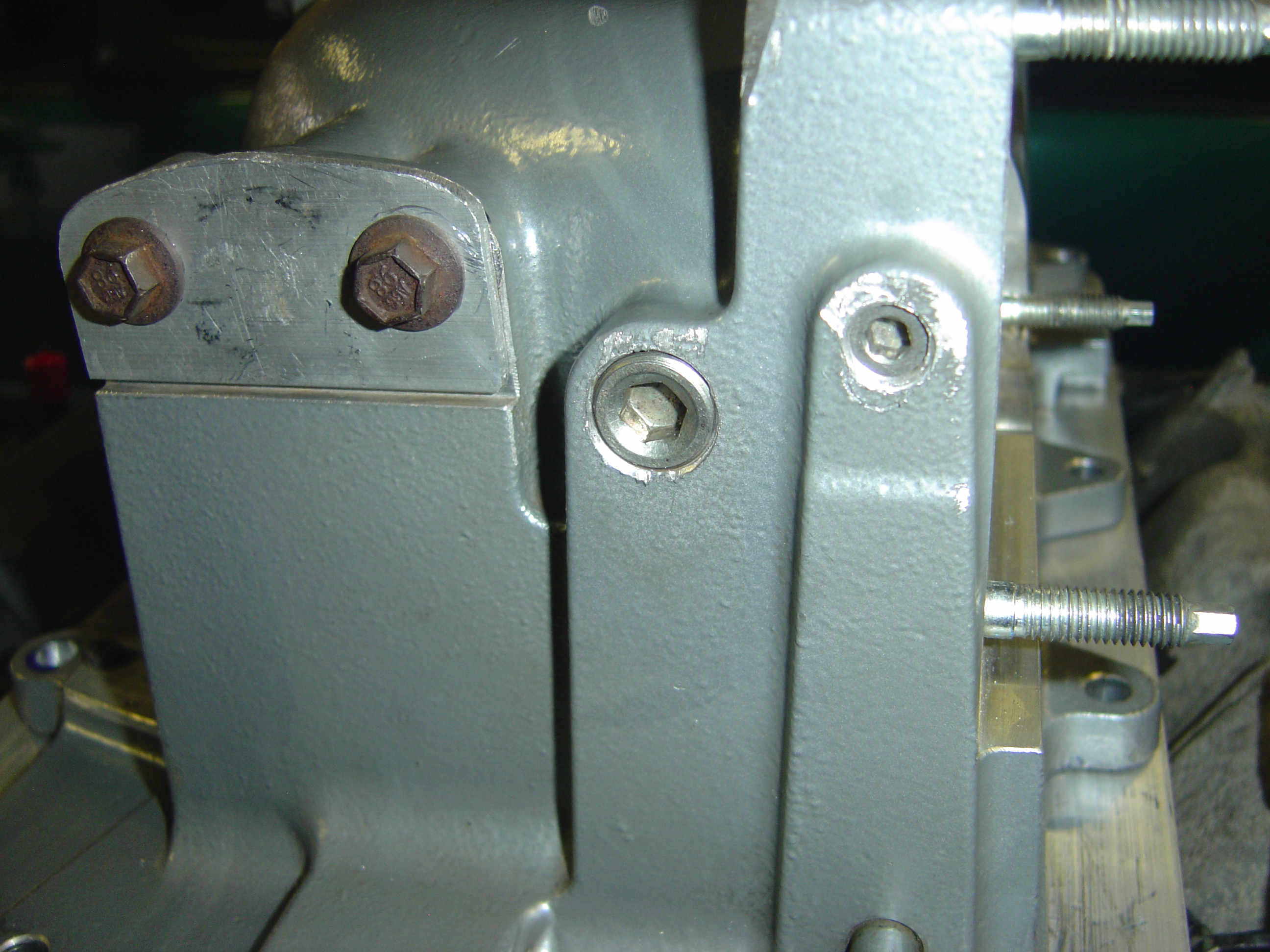

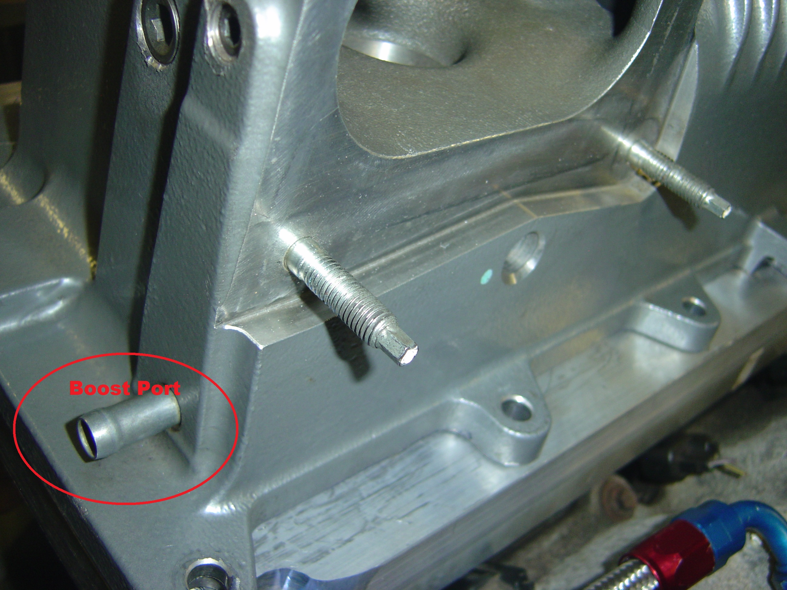

I had to remove all but one of the vacuum ports from the back of the supercharger for clearance. So I needed more.
I added one to the supercharger itself, it seemed to be the only location to do this since the supercharger case is so thin in most areas plus I only wanted vacuum and not boost on 5 ports. One port will be vacuum and boost.
