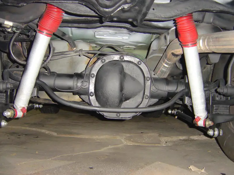

Unfortunately there is no room on the left side with the gas tank in the way.
If I went to a fuel cell mounted under the back in the middle then I could probably have true duals with less bends etc, if it could fit passed the transfercase(got no pics of that area right now).

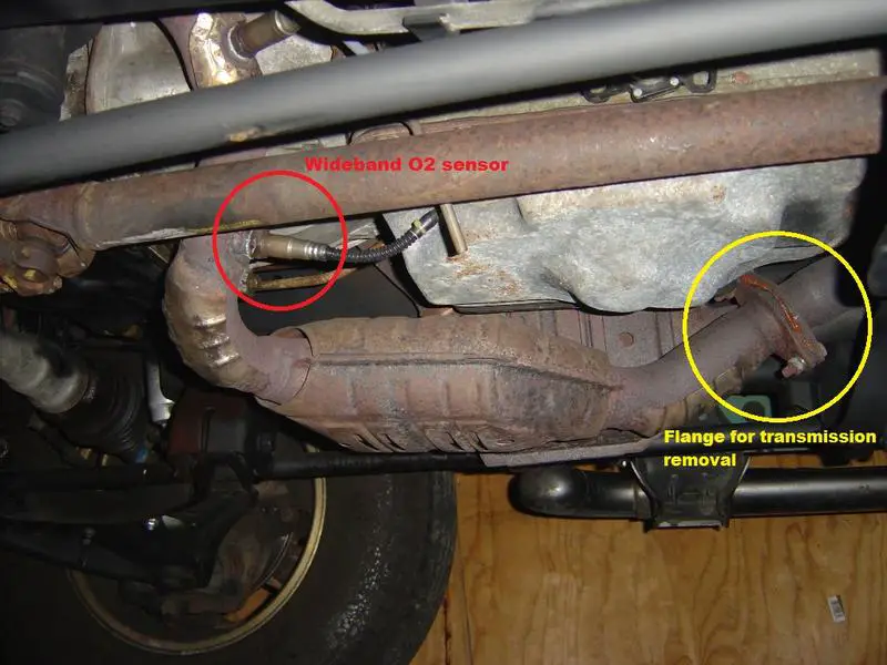

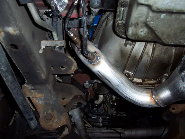

I dropped the truck off today at 8:00am for my appointment at the exhaust shop. They called me at 6:30 pm and told me it was done.
I asked for 2.5 inch pipes with high flow cats to the muffler. 6 O2 bungs, and a flange so I can remove the drivers side pipe when I break the transmission again.
I was quoted $900.00 - 1,000.00 just for that.
I believe the bends will look like the ones in my tail pipe, I don't think they are mandrel. It wont be perfect. I cant afford perfect. lol.
I pick it up tomorrow morning, I will probably not be able to do anything to it until Saturday. At that time I will take pictures, and do another back pressure test. Then I have to reinstall the wideband sensor. Next week I am off work, if Tuesday brings nice weather I plan to be at AtcoRaceway testing it out.
One thing that I found interesting is that everyone is kind of on the same page, we all say bigger pipes. No one was on the exhaust scavenging side of the conversation. Great minds think alike right?
Can't wait to see it tomorrow, hope I can sleep.
if you have next weekend off as well, take a drive up to carlisle (hint hint).
Exhaust
OK, it is done.
When I first looked at it, I wasn't sure about the pipe size. It was an optical illusion. I measured when I got home and the pipes are definitely bigger.
The truck is a little louder at cruising speeds. I have not had a chance to go WOT. Back pressure testing should be Saturday if the weather permits.
Here are the pictures.

Cats
I don't know what brand they are but they have a O/D larger than 2.5, the 2.5 inch pipes fit inside them.
They look stock too which is what I asked for.
The Widebands are downstream of the pre cat narrowband sensors, but still before the cats. Right now there are just old broken sensors in the bungs, I will be doing back pressure tests then reinstalling my good wideband on bank 2 (D/S) like it was before. In the future I may get the new innovate dual wideband set up with the one gauge.
