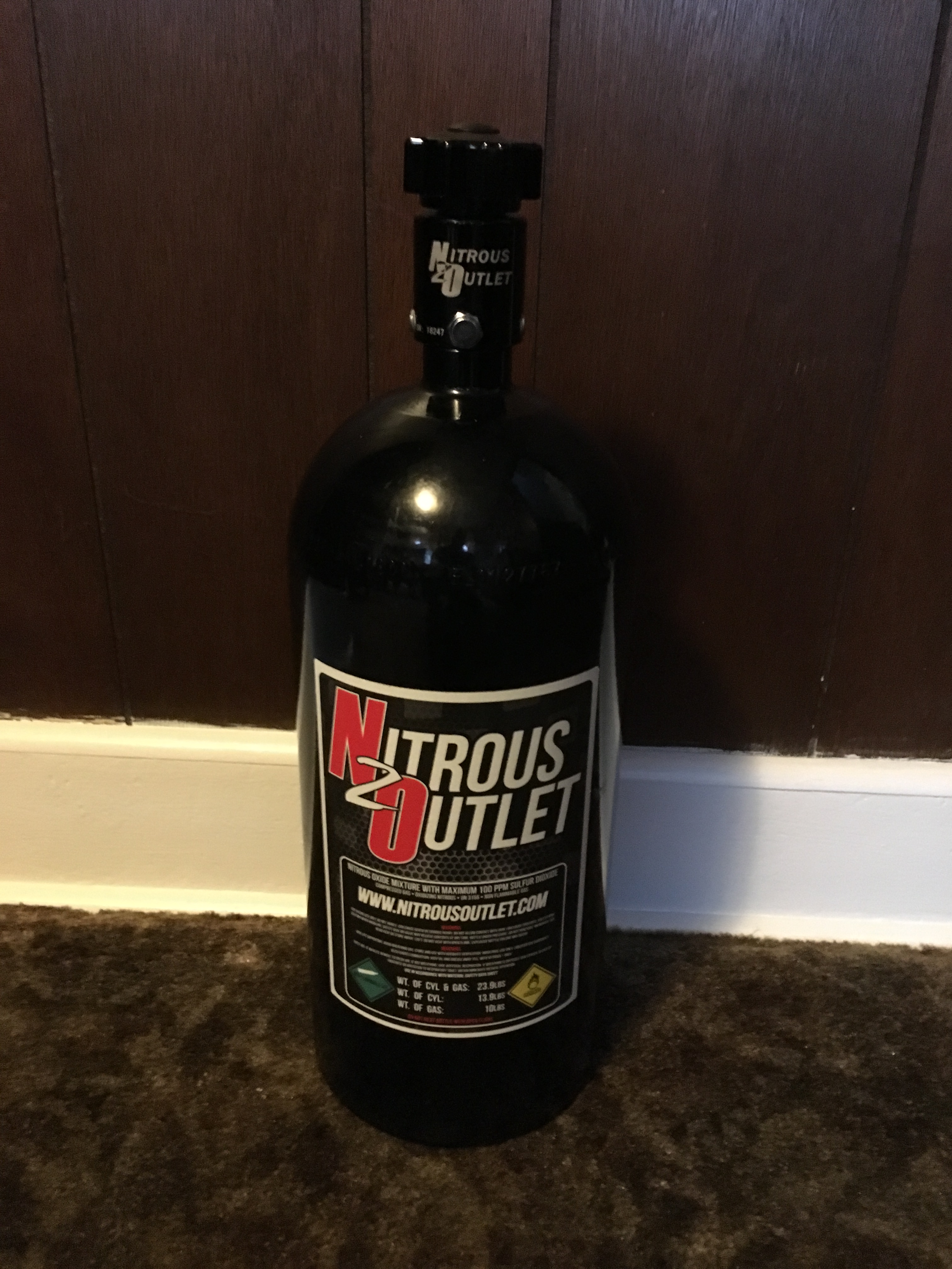

Got the Nitrous kit today, it all showed up in good shape.
$550 for an $800 plus kit so I wont ***** about how long it took to get it at my house.
The kit comes with new high flow bottle, solenoids, and a plate that fits between the throttle body and supercharger on the GT500.
Of course there are wires, switches, brackets, a WOT switch, lines, and some different sized jets starting out with a 50 shot.
The seller said he is sending me some more jets that someone dropped off at his house too, he forgot to put them in the package so is sending them separately.
I don't know what sizes they are but maybe they will be smaller than my 50 shot ones, I really want to start out with the smallest I can get my hands on for experimenting.
I can't wait to see the results of this mod!

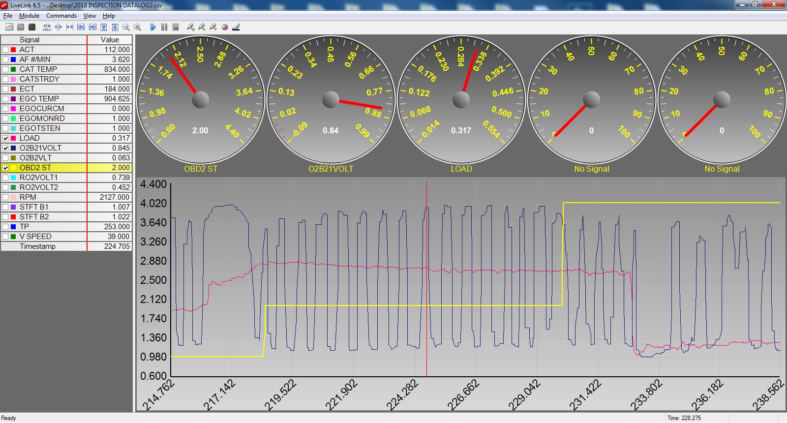

Today I drove the Explorer all over the place trying to get the monitors ready.
I could not get LiveLink Gen2 to work with the OBD2 Test state pids, so I hooked up the old X3 and used Live Link 6.5
I had to try quite a few times to get all the conditions right for the O2 monitors to run but at least I got it to work with the 60lb injectors.
So glad I don't have to swap injectors anymore.
Then it took for ever to run the EGR monitor, and the Evap and Catalyst monitor still have not run as expected.
I am allowed 2 monitors to be not ready so it is good to go now.
Tomorrow I remove the pillar gauges and pods and then my center console gets swapped for my stock one with no gauges or lights in it.
Also have to remove the wideband gauge and pod off the steering column, and remove my OBD2 connector extender that goes to my center console.
Then It should be all good to go for Monday. Wish me luck!
Here is a screenshot of the O2 monitors running today.

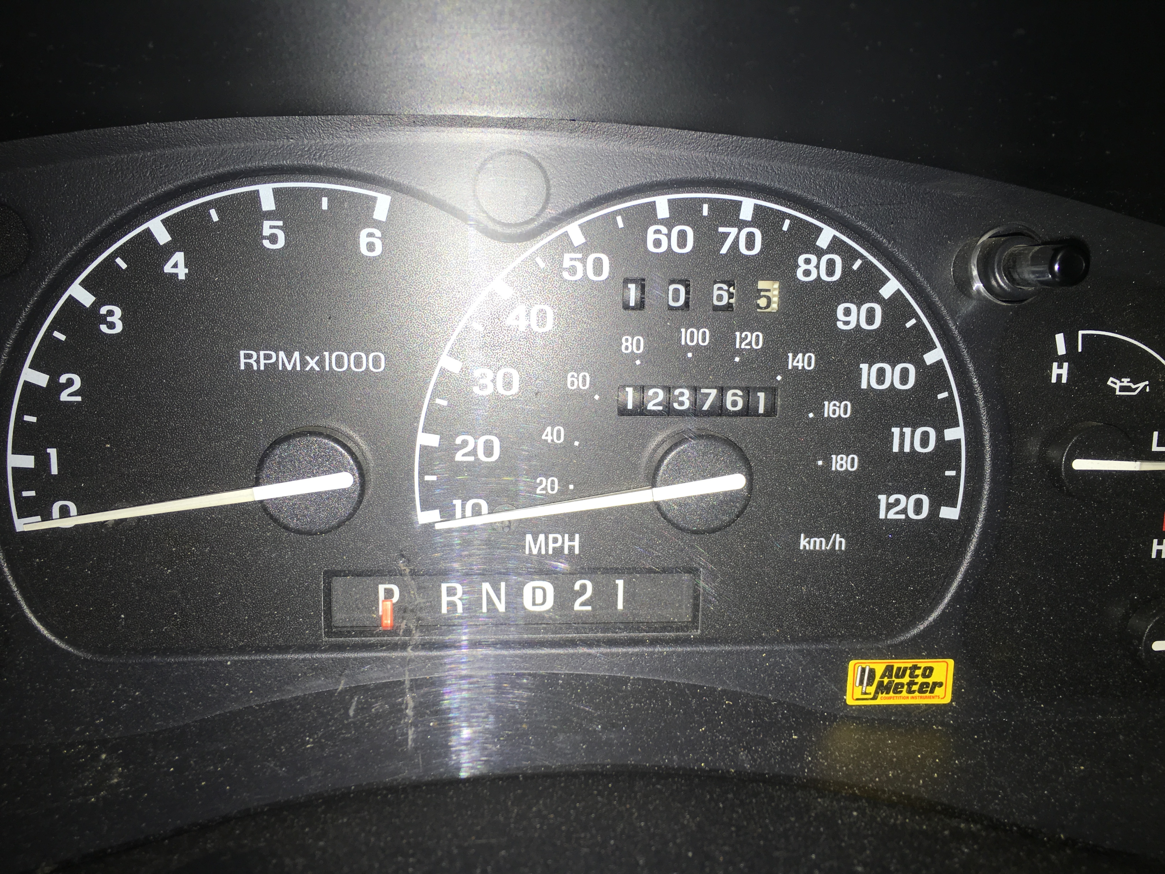

Also a screenshot of my odometer right before inspection so I can track the mileage.
