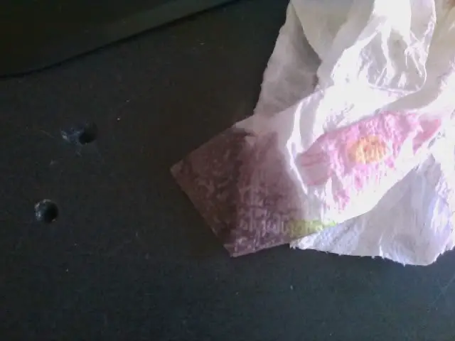

This is the color of the fluid after about 200 miles...could this be leftover vaseline changing the color?
Also the tranny was overfilled by about two quarts. Could that overheat the fluid?
is it purple? gray? brown? can't really tell from the photo.
I don't believe overfilling a transmission can over heat it. Some people may say that you can blow out the front seal from overfilling, but that just does not make any sense. I believe the only possible bad effect that can come from over filling is a fire.
Transmission fluid has a very high coefficient of volume expansion, which means that the oil expands a lot when heated, if the transmission is over filled, a lot of fluid may be dumped out the vent tube when the fluid is very hot, and combust on the catalytic converter, causing a transmission fire.
This is actually more of a common culprit for truck fires while towing (when the transmission get very hot and the oil expands even more) than you would think.
Does it smell burnt?
There is no way that the cooler lines can be plugged/pinched some way right?
Get that transmission temperature gauge hooked up and that will really be able to tell you what's going on in there.
