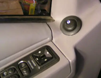

Was my problem. Everything's all done and put together. They sound AMAZING! I mounted the tweeters in the door panel at an angle so they're facing toward me. I used double-sided tape to find the best spot and that was it. I'll have pics in a little bit.

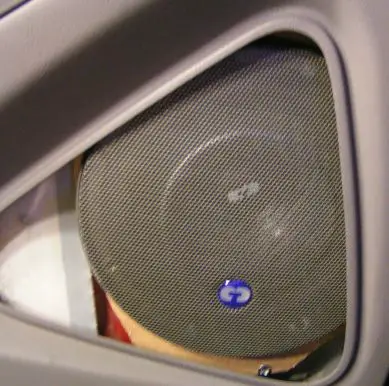

Pics below. To mount the woofer I removed the factory speaker bracket (?) and put in an MDF adapter on each side. With the grilles the woofers just BARELY fit. I am still amazed by the sound.
