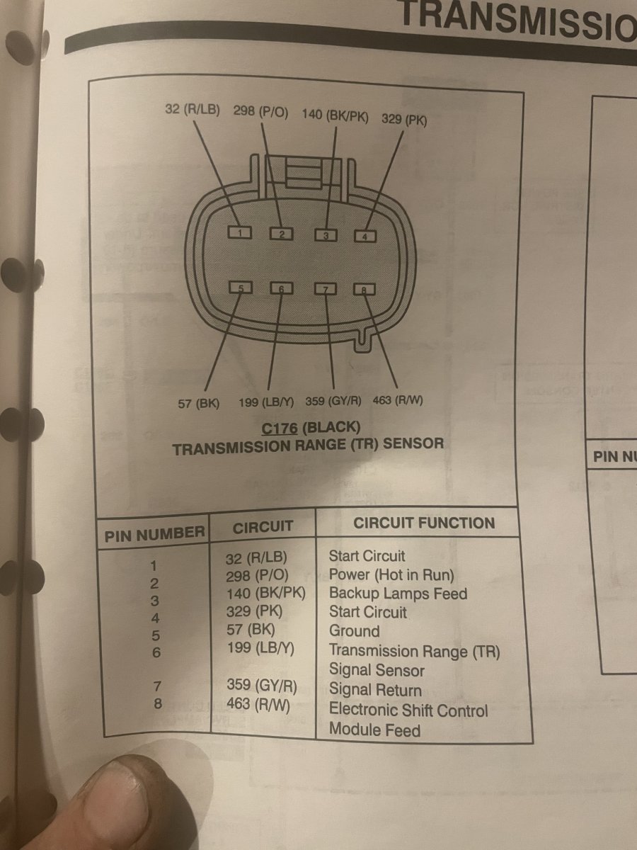

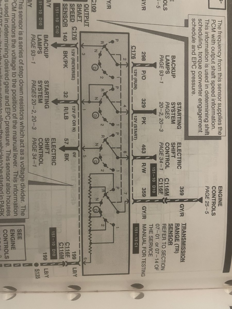

I replaced my Neutral switch a few ago. This year I noticed the reverse lights did not come on. So this year I made sure the alignment marks on the Neutral switch, where in alignment. Backup lights were illuminated. Now they are not. So today I adjusted the neutral switch again. The problem is when I place the car in park, then into reverse the backup light do not come on. I checked and wiggle the connector, wiring harness; no effect. Can these neutral switch fail that easy?

I believe its a bad switch. I dId everything mention above.
Then I would replace the switch.
Next would be to check the power going into the dtrs
