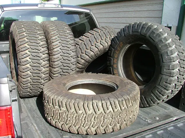

Took a roadtrip down the 15 today for dad:D
35x12.5x17 MTR Yellow label :p:
I was just looking at those too.:(
Are those 33s or 35s, and they look like they're for 17" rims. What are you doing with the wheels already on the ex? I've always liked those. Hmm...
Nice tires, will your dad have 2 sets of tires as in one set for street and these for the trails?
The new tires will be for trails only as they are not street legal.
Sence these are yellow labels with the softer compond, yes. These will be just for offroad. They are 35x12.5 17's. I'm acually having trouble finding a 17" steel rim with 3.75-4" Backspaceing:( Everyone has 4.5 or something.:rolleyes:
The 33x10.5 will be for the street...although I don't see my dad driving it much on the street, unless gas keeps going up like it has been. I'm also not convinced the 35's will fit. You can see rub marks in the rear from the 33's. Maybe just need to get a longer shackle, as it still is the factory ones. My dad sugested doing a spring over swap in the rear and my exes popped out of my head :eek: I said do you know how high this thing would be with those deaver over the axle!!!! :eek: I guess he forgot about that part.
The gearing could be a issue two, as I belive it's still has 3.73's in it. Not sure until we get a working trans to drive it. However I'd like two pull the rear cover of the diff, and check for a locker and throw a aussie or lock-right in, if there isn't one.
